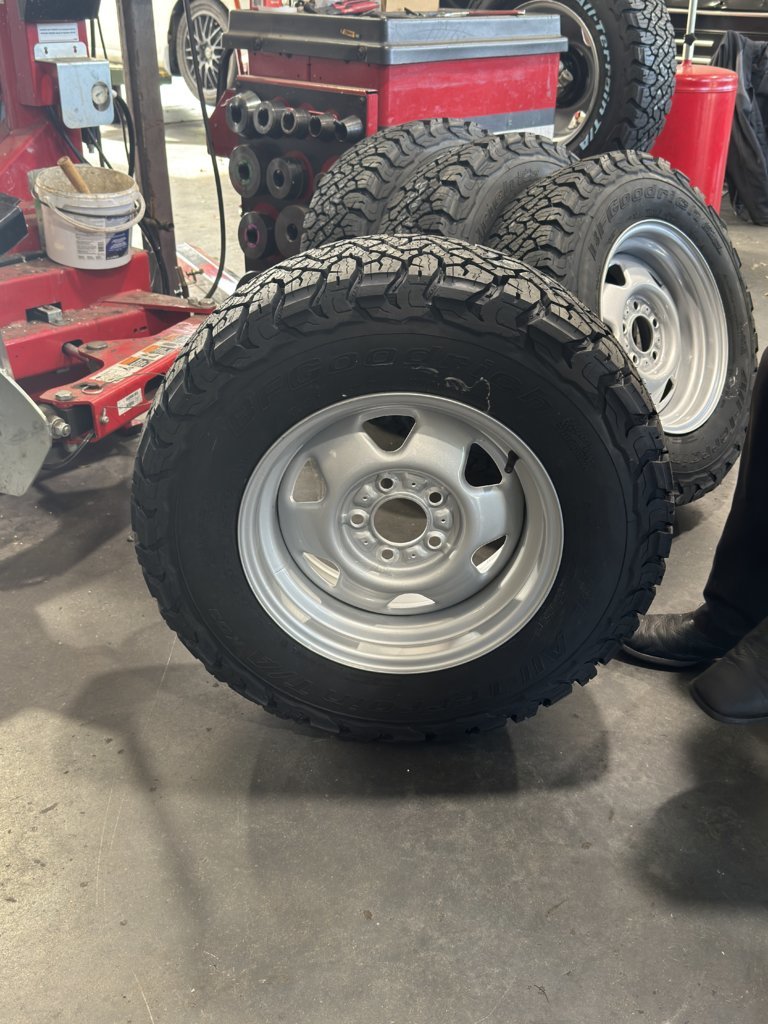

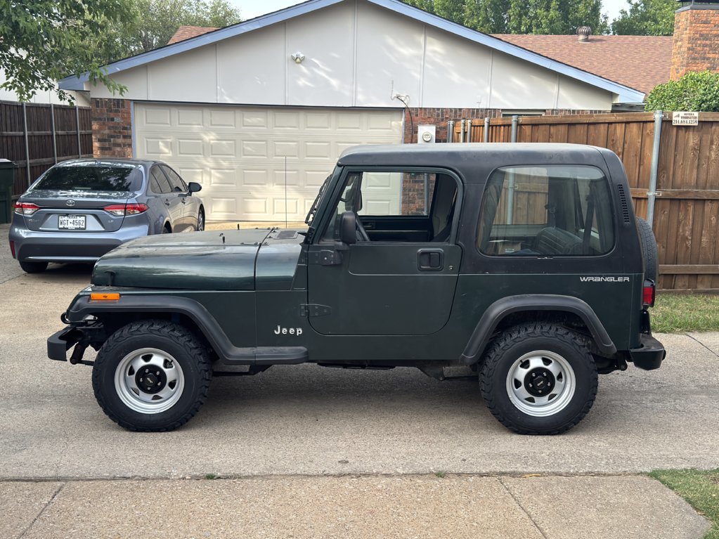

    Not Tacoma specific, but with the additional 19 sizes they made available last week, I was finally able to secure a set of factory-sized LT215/75R15 KO3s for my old Jeep's new factory wheels. Will report on the road results soon. I will say, they do look good. They make small stock-sized tires look not so small.

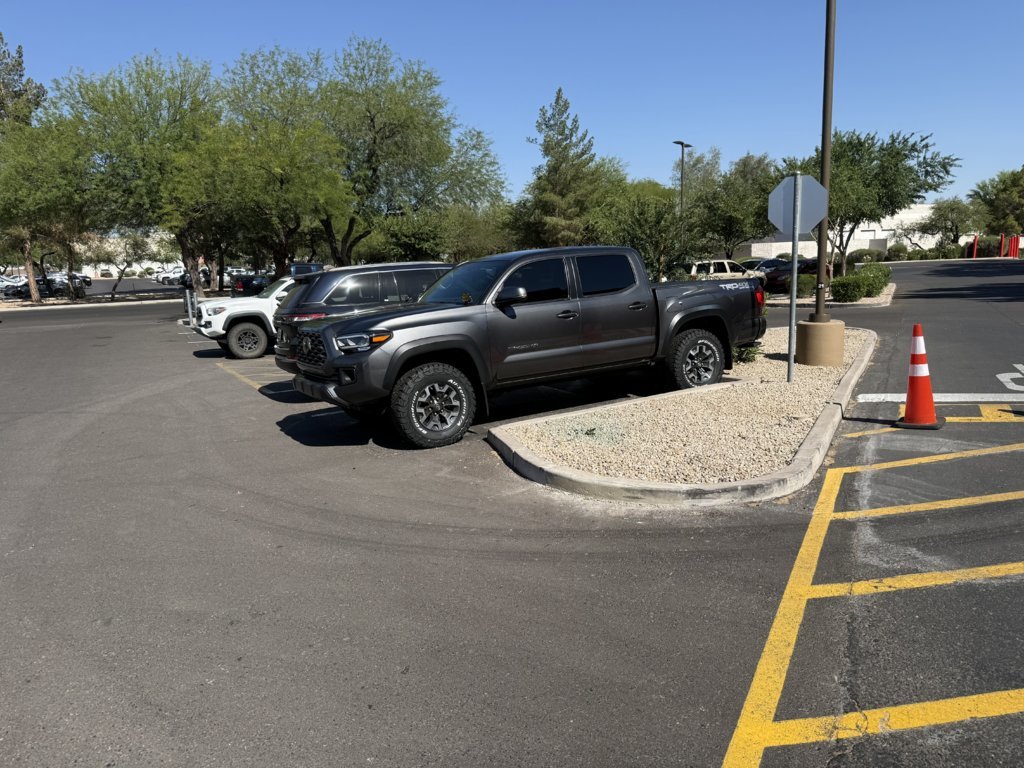

    I don't know if I'm ever going to get my fox elite's installed, but for now I have some brand new BFG K03's in stock size 265/70/16 load range D via Costco. So far I'm very happy with them. Just from driving around town and on the freeway these ride so much quieter and smoother than the old Toyo Open Country AT3's. I do notice the stiffer sidewalls on these BFG K03's and they're noticeably heavier, but I can live with that. They look wild with the white letters out too.
    44psi cold

    Those look sweet. I’m jealous and want the same size for mine. Really, I want a second set of wheels so I can run them and the Michelins. Totally unnecessary but it’s what I want.
    FYI, I’d drop the pressure down to 39 cold. That will maintain the door sticker load.

    It's funny how much this particular tire adds to a stock vehicle. Totally changes the look.

    Agreed. It’s also funny how I prefer the stock size personally. I think a meaty stock size tire looks a bit better than the 1” larger. Looks less stuffed. Both have plenty of room with no rubbing ever, but the smaller tire seem to fit better to me. And the driving characteristics are better.
    If I end up keeping the 3G, I may go with 265/70 KO3s at some point. Although I really do like the Michelins, I could not have a better road tire at this point.

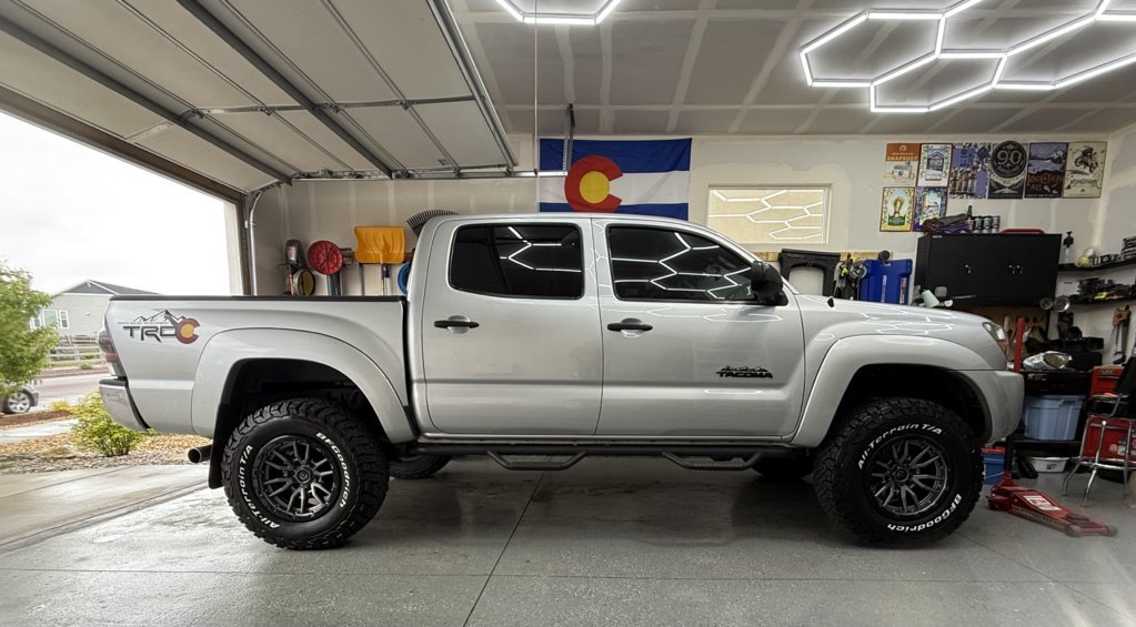

    Just got mine on. 285/75/17s. Love em! I really like the look so far, a touch more aggressive.

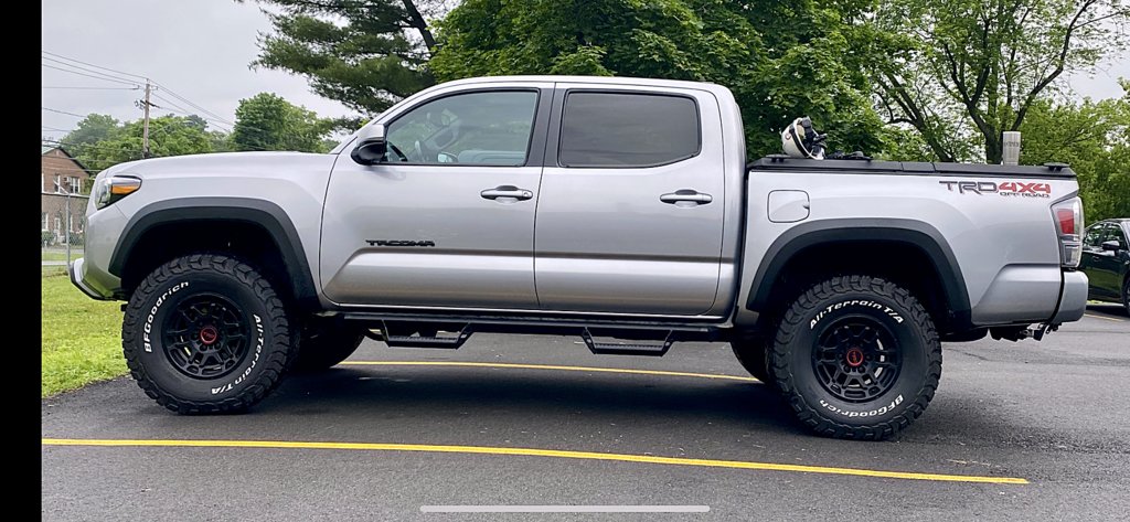

    I have my 295/75r16s installed finally. On factory trd pro +4 offset wheels, I have zero rubbing and no trimming anywhere *during street driving*.
    In regards to the tires, they balanced well with the highest being 2.75oz(?). They are quiet and have very good sidewall support during simulated slalom turns. The wet weather handling complaints are non-existent. This is an example of the weather and flooding in my neighborhood the past week. Zero hydroplaning or loss of traction.
