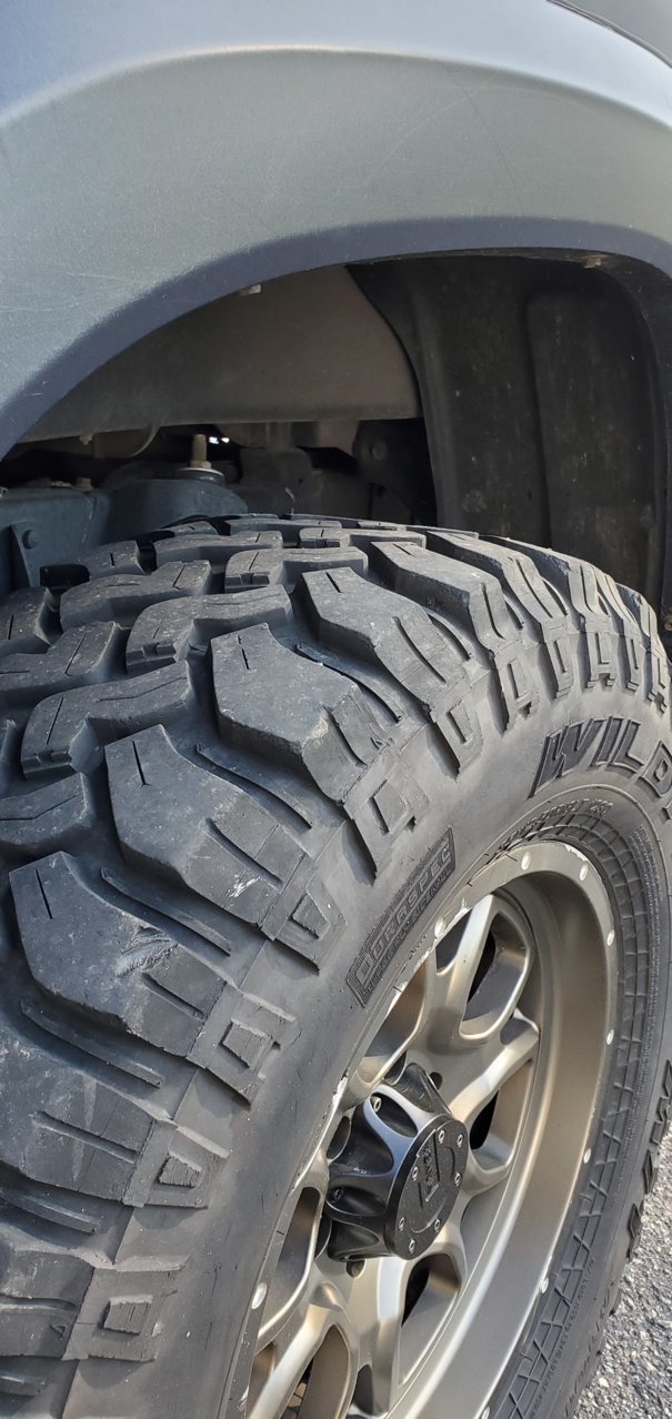

    I have 35k on a set of Falken MT's using in this method so far. Good even wear.
