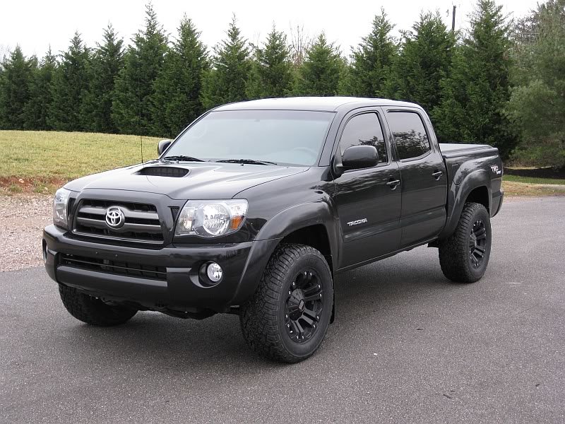

    Just updated with front window tint. Makes a big difference.
    FYI: $60 in TX to tint.
    After some time w/o lift. I have decided to lift it at least 2 inches.
    But first, I want add bed cover.

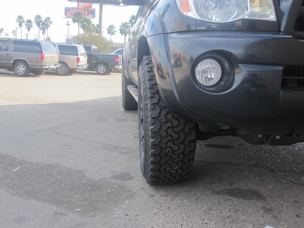

    Ulysess:
    Front wheels
    Rear fender well
    Thin plastic
    Tire rubs due to plastic not secured to fire wall.
    Sticks out about 1/2"
    Glued it down to hold it back.
    Reduced rub to minimal.
    Minimal rub broke glue loose.
    Now rubs on full turns.
    Will now try to use metal screw into fire wall to hold down plastic.

    Sorry fogot to show trim spot.

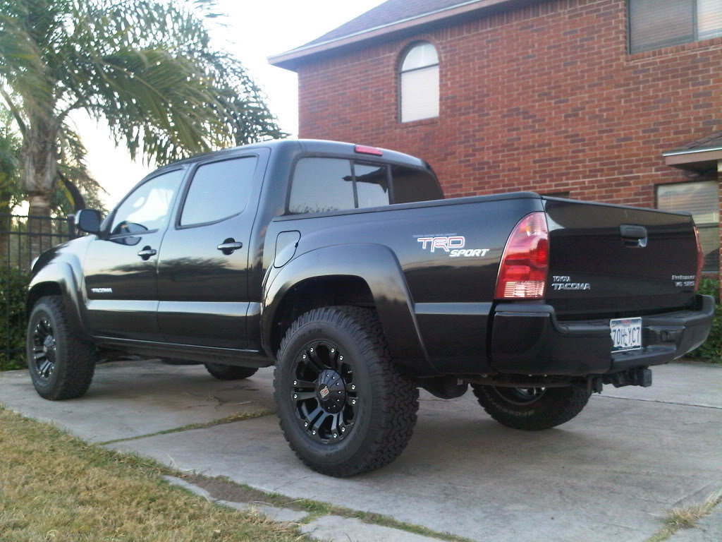

    TRD Sport"
    Seeing is believing:
    BFG TA KO 285/65/18
    Black KMC XD Monsters

    I preferred the 5.7bs X +18os to the 4.5bs X -12os. See how it tucks up under the fender flare better.

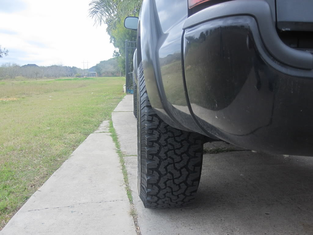

    Sawick/TRD Sport:
    Yes.
    Just:
    Tires: BFG 285/65/18
    Wheels: KMC XD Monsters 5.7bs +18os
    Minor Trim: On Hard Plastic Rear (They will do it for you) with knife or small hack saw. Don't sweat it - no one will ever see it. The cut starts at about 1 inch back and at 45 degree angle to 1 inch in the front of plastic piece. See pic above (Lightning bolt).
    Tuck: Thin Plastic Fender Well (Glue Will NOT Hold) Must use metal screw. Option - You can cut the thin plastic, but I preffered not to.
    That's it. Your done. Drive home looking like a champ!
    You will still get minor rub 1% of the time on thin plastic piece (when making full 90 degree turns up into driveway or backing down out of driveway). A small annoyance but nothing major. Again, I will state - It is my opinion (since a do not have a lift) that even with a 2-3 lift, you will experience a minor rub on the front fender well on turn in and on rear on turn outs.
    Do not fear. Once you do it, you will be glad you did. If you dont like the minor rub - do cut of thin plastic and/or lift later. Try w/o lift first then decide. Good Luck.

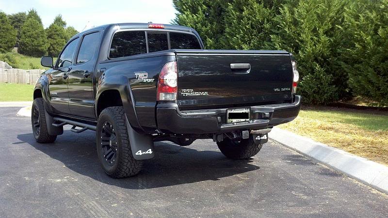

    Here is the best comparison I can make to the difference in 4.5bs to 5.7bs.
    My 5.7bs is first pic.
    Next 2 are TW member (se7en) Copper Zeon LTZ 285/60/18 with 4.5bs
    Note: My 5.7bs does splash the side. So, my opinion is the 4.5bs must really splash side and throw rocks and debris on the sides. In the end, I personally just liked the tires under the fender flares. So, I went with the 5.7bs.
