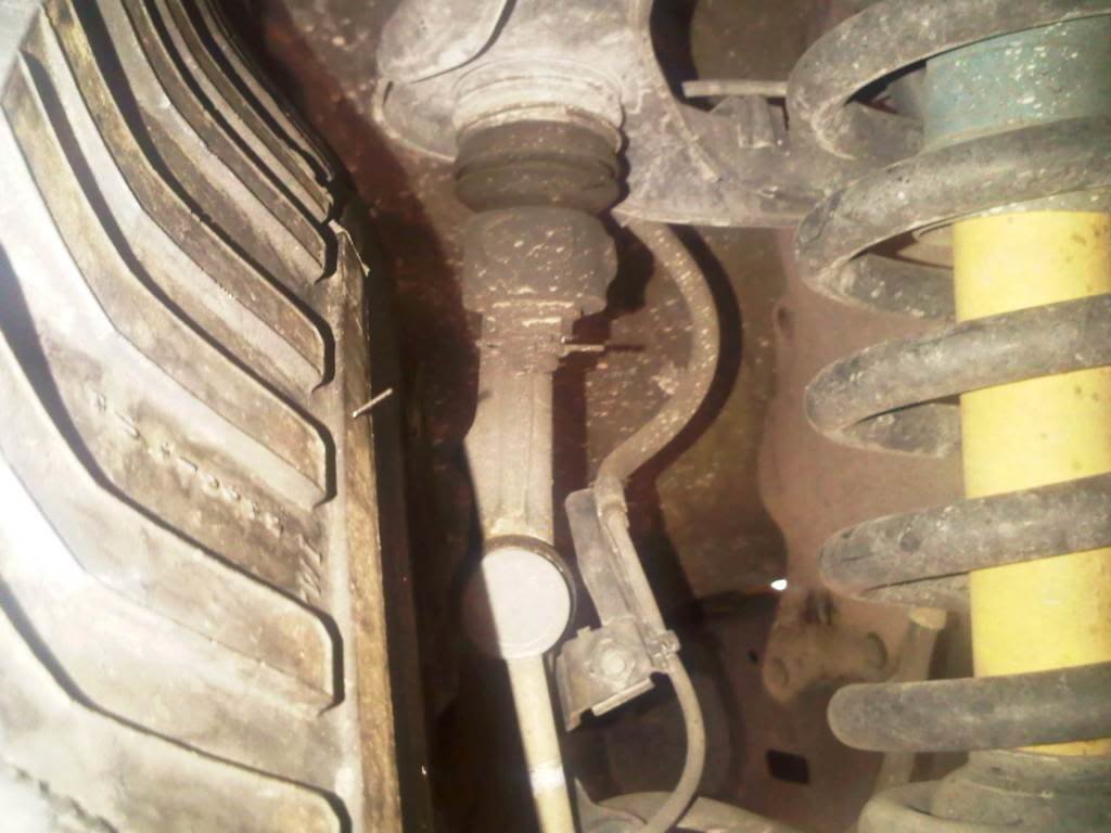

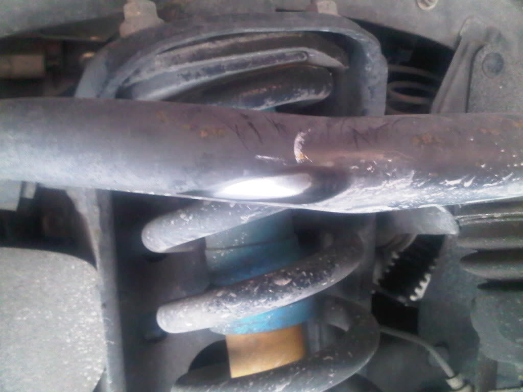

    All:
    Here are the best shots to display UCA and Inner Body Component distances.
    No issues. I believe the same as Ulysess - No 4-wheeling - No problem.

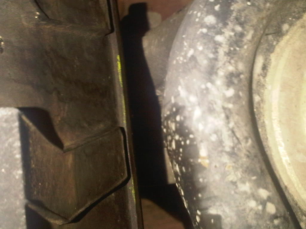

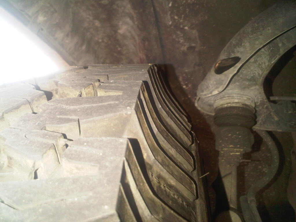

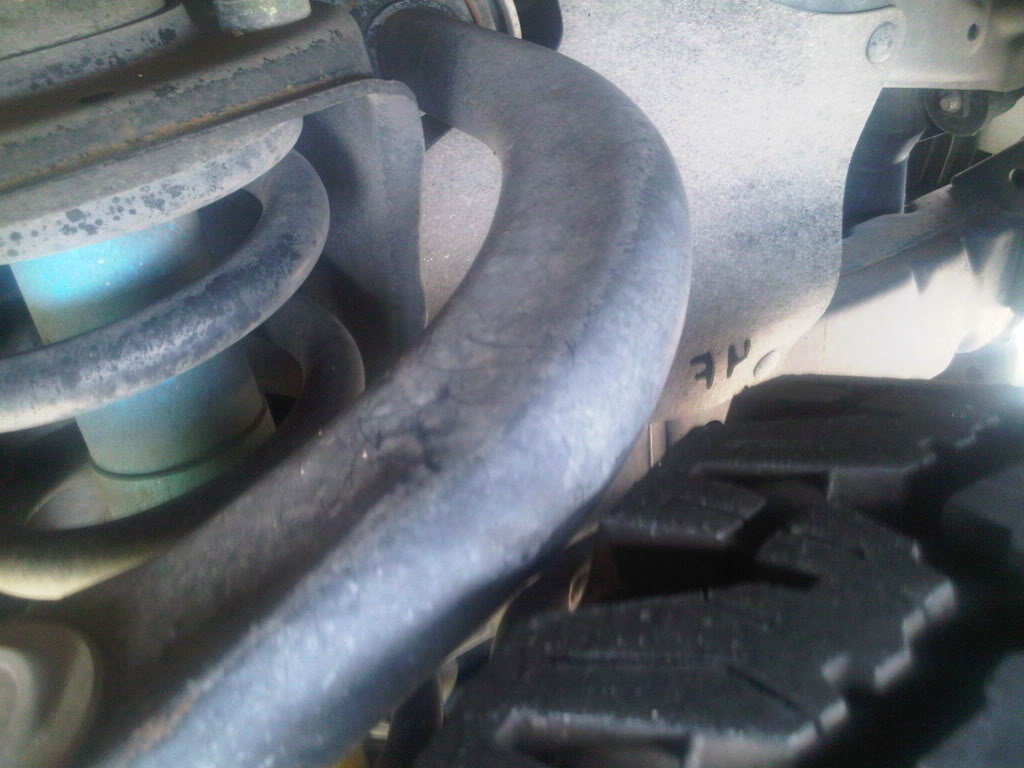

    Well after another 2 weeks I have discovered the front tires are slightly rubbing against the control arm at full lock. Not enough to cause a problem. Just wanted to update people whom asked. Did not see it until I looked and found the paint rubbed off. No drive issues though.

    if you are catching the uca on the tire during normal driving you are going to destroy that joint if you wheel it. And "no rubbing" on the highway is not "no rubbing" during flex... You may want to look into a minor lift or risk tearing stuff up if you offroad jmo..

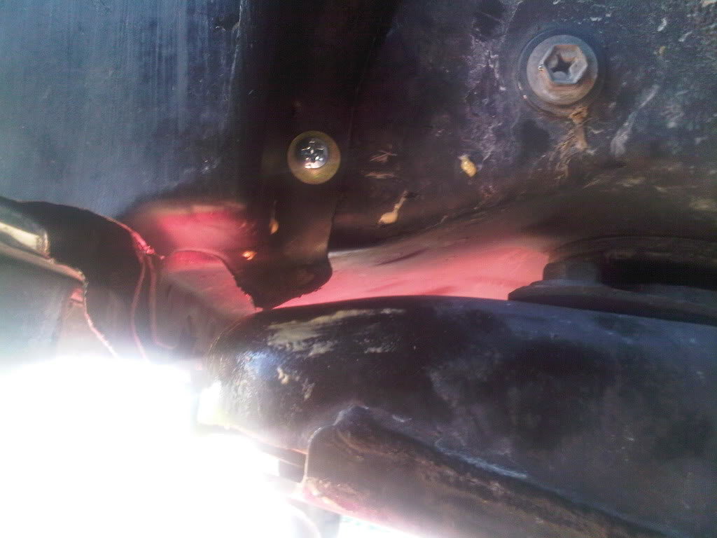

    All:
    I forgot to show the method of securing the thin plastic trim piece.
    See picture. You will notice, if you pull back the trim piece, there is a bolt hole in the loction behind the trim where you can secure the trim.
    I could not find a bolt in my spare parts drawer that would fit the hole and threading. So, I inserted a small plastic expansion wall anchor (plastic torpedo shape) into the bolt hole and used a small gauge nail brad to push hole in thin plastic trim piece. Then I used a washer and small screw to secure the trim piece.
    I hope it holds. If not I will have to go to hardware store and find bolt that fits. I thought about using one of the plastic trim piece expansion type clips (I seen some on my fender flare). Looks like they were there to secure mud flaps???? But, I wanted more securement. If thscrew/bolt does not work, perhaps the lift will. If not then, I will cut the piece to eliminate all contact.
    Solved plastic from making load noices when tire makes contact. Again, the tire will still make contact when turning up and in to a drive way. However, securing the trim piece will mute the noise.

    IBEngineer:
    I agree this rub is not optimal. But not major (only the outer tip of tire tread is making contact). 4 wheeling would definitely be an issue with flex. However, I do not want to continue long-term with the rub.
    It is only the darn tip of the tire tread. I need to search the forum to see if lift kit raises the UCA???

    1. No other adjustment possible on the plastic w/o trimming. However, the trim would be minor. See previous pictures were i screwed down the loose plastic fender well. That piece would need to be cut back. UCA may be eliminated with aftermarket UCA. Can't say for sure, it is not rubbing enough for me to do anything until I install the lift.
    2. Off set - Anything that move the wheel closer to the hub will bring the tire closer to the UCA. It should not affect the plastic rub. That is caused by the size of the tire relative to the fender well.
