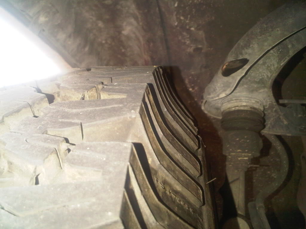

    Just got a question regarding sizing on these and mine...thought I'd give some info for anyone needing more. As the OP mentioned earlier, I have a ton of info on mine, located here...
    http://www.tacomaworld.com/forum/wheels-tires/73845-285-60r18-xd-monsters-pics.html
    But to add a little here as well, here's my two cents...
    The OP (jrgaither1) backspacing worked here because he went with the TA's...in my case, those won't work well at all bc my Cooper's have a more vertical sidewall. If he had used the Coopers in lieu of the TA's, the tires would have rubbed with the tires pointed straight, let alone at full lock!
    His pic here shows the inward concave shape...
    Mine are much more vertical from sidewall straight up!! Therefore, I HAD to go with the larger 4.5" bs in order to clear the UCA's.
    Here's how much I had WITH a larger backspace. Imagine mine going in toward the UCA another 1.25" or so...:eek:
    NOW...he rubbed at full lock bc his back spacing brought his rims CLOSER into the fender well, where he rubbed on the inside plastic. I also rubbed on plastic but at a different place. Since mine PUSHED my rims further from the fender, mine rubbed at a different spot in the fender well. In order to correct my rubbing (which it still does on occasions), I lifted mine. The biggest difference between his setup and mine is that I can TRUELY go wheeling (and do) and he cannot. If he does, he will chew the hell outta his inside fender well!! If you look at the picture comparison he provided in post #37, you can see the difference in clearance between his tire and fender and mine...it may not look like a lot, but there's 1.5" more in mine, thus giving me the clearance needed to wheel. If he chooses to make his off road worthy, he probably won't need a 1.5"...more like 3/4"...to clear his fender bc his rims are closer in. Clear as mud? :D
    Hope this helps!

    so if you had a 18mm offset, wouldnt a 12mm offset (ones im looking at) rub less? (and a 0 offset even better?)

    Not necessarily. See, mine are -12mm offset, but the OP's are +18mm...and we BOTH still rub...just in different places. His rubs on the fender and the UCA and mine rubbed on the fender and stuck out past the fender well about 2". It just depends on what look you want.

    All:
    Se7en's build is what I used to build mine. Obviously, because:
    1. His Tacoma is a black double cab.
    2. He used KMC XD Monsters (I original could not see getting black rims - then bam it hit me - It took alot of looking and soul searching)
    3. He used a Copper Zeon (A tire a was seriously considering) In the end I had to change to the BFG due to clearance, as I wanted the tires under the fenders)
    4. He had the Bed Cover I wanted. However, I ended up going with Tonno Pro.
    5. He ended up lifting the truck. I will as well. Likely, will use the coils/shock option and skip the spacers/block.
