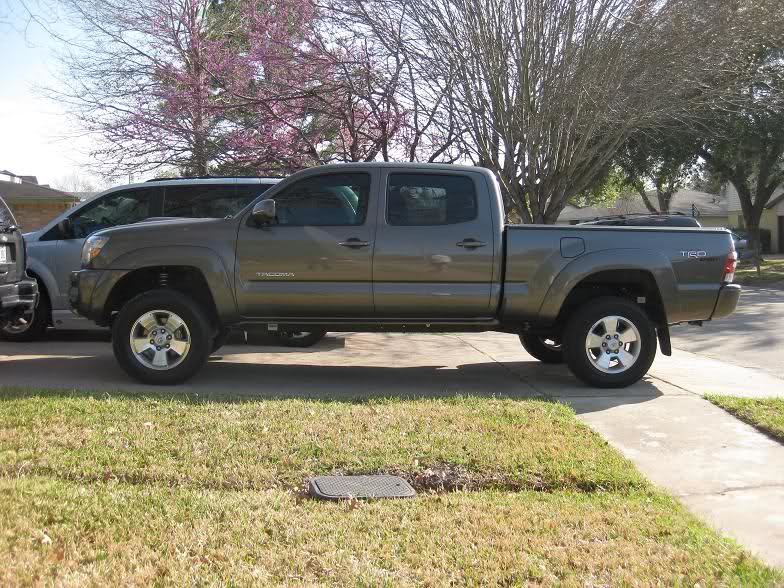

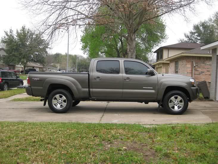

    I didn't measure the height before, but will measure it now when I get a chance. From what I can tell, it's easily noticeable of at least 2.5" higher.
    I did set the 5100s at .85 with Eibachs and 2" aal also with 5100s in the rear. No tsb.
