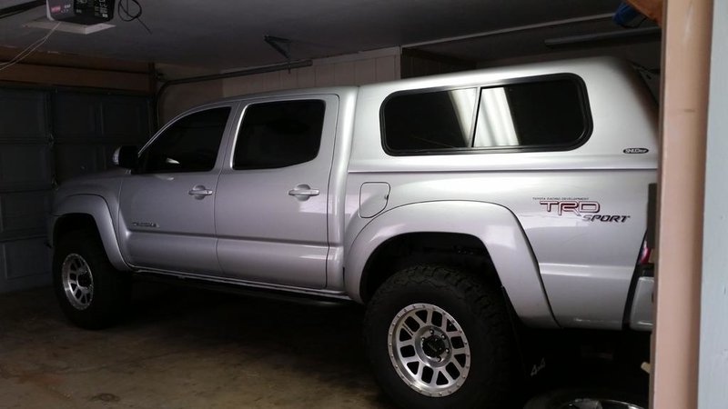

    A week ago I decided to go ahead and be the test subject running the 34x10.5 size. I took off my front mud flaps and had them mount them up. Discount Tire took care of me beating their competitions price as always.
    My suspension set up for reference is:
    Full OME Kit with 887 coils up front and Dakar leaf pack in the rear. (I forgot the nomenclature of the struts, they are the nitrosport street variant)
    Before the tires
    Stock sport Duelers on Method Mesh rims.
    Measurements were
    Tire height (mounted)28.75"
    Front Height (Ground to wheel well)36.5"
    Height between tire and fender-7.5"
    Rear Height with Campershell (Ground to wheel well)38.25"
    Height between tire and fender-9.25"
    After the tires
    Measurements are
    Tire height (mounted)32"
    Front Height (Ground to wheel well)37.75"
    Height between tire and fender-6"
    Rear Height with Campershell (Ground to wheel well)40"
    Height between tire and fender-8.25"
    After Thoughts
    I haven't put a full tank of gas through yet so I do not know the difference in mileage, I will post after my next fill up. Tires are no more noisy than the stock tires after they got a little chewed up on the trails. You can hear them if your listening, but nowhere near as loud as mud terrains.
    I think that they have really helped the appearance and feel of the truck.
    I do have slight rubbing on the inner fender liner if the wheels are more than 3/4 of the way turned and I hit a bump. Very slight. I will be using a heat gun and pushing them in when I get a chance and I am sure that will fix it.
    (P.S. Sorry about the pictures being sideways, I have rotated them on my computer before uploading them but it doesn't seem to make a difference on the site, if a moderator wants to help out, please feel free)

    Can we get a full side shot? :D

    Or are you talking about a full side shot of the rim/tire?

    looks good :thumbsup: How do they feel with the stock gearing?

    I can definitely feel it, but I don't mash on it like a race truck. Speedo is now off ~the first digit of how fast you're going (ie 10mph= ~1mph faster /60mph=~6mph faster)

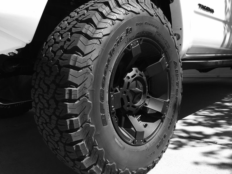

    Here are my 285/70R17's

    Damn looks good dude, Just ordered mine picking up tomorrow!
