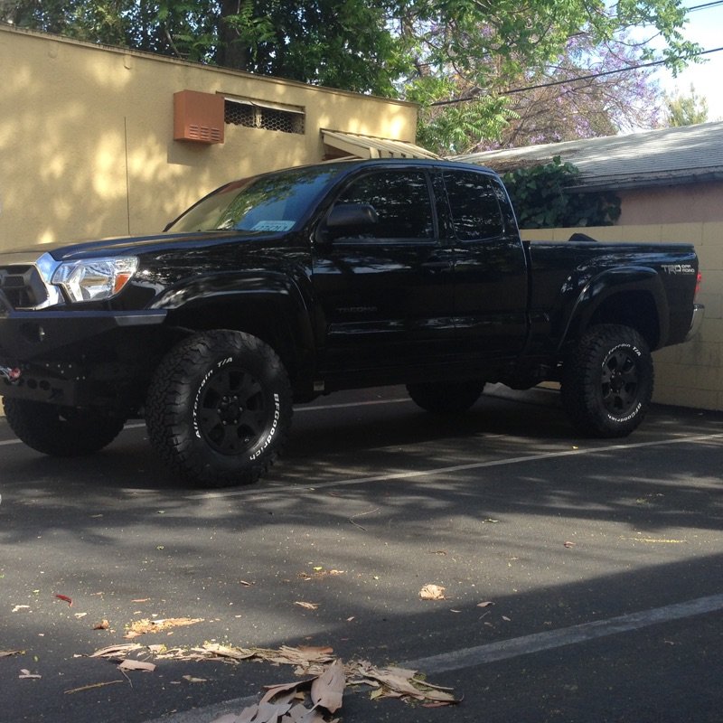

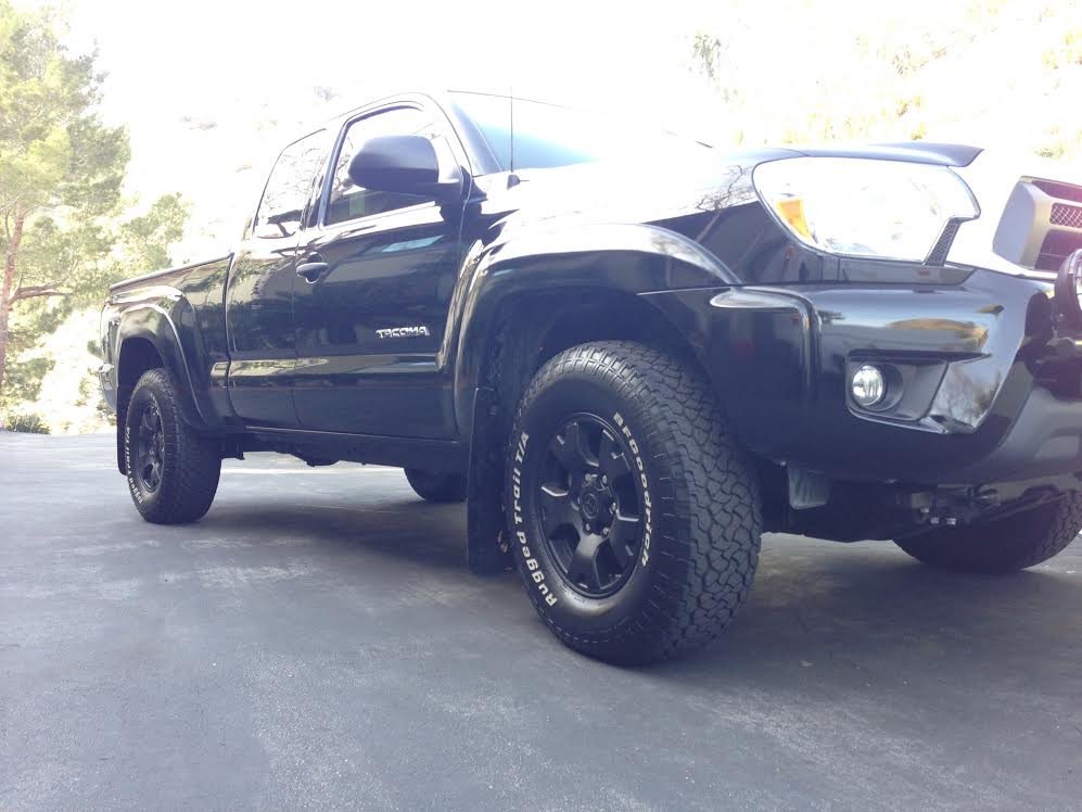

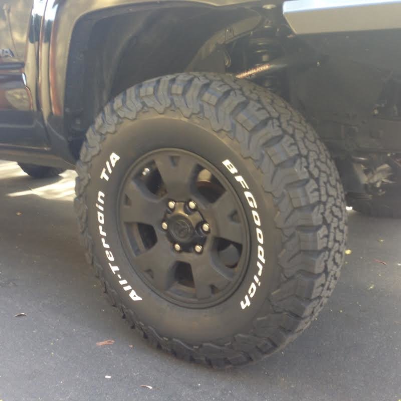

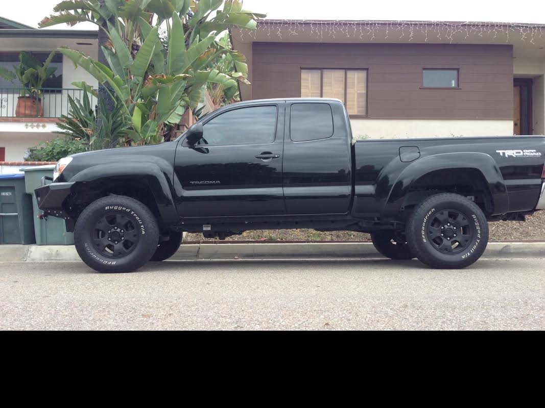

    Finally got some ko2's. some before and after shots.

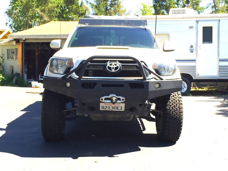

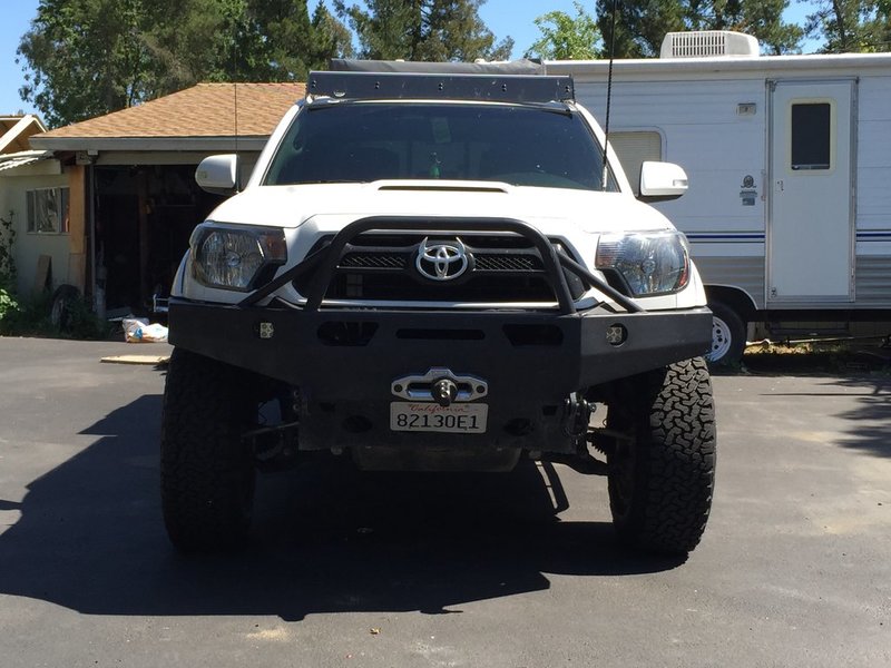

    Not pizza cutter at all. Not the best picture but here you go. hope it helps!IMG_0932.jpg
