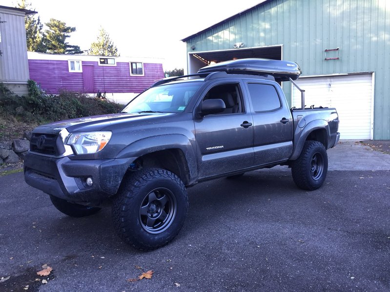

    34's, Kings, SCS F5's.
    I got my 34x10.5r17 ko2's mounted up on Saturday. On road and in the rain performance is 100x better than the 255/80r17's BFG M/T's I had previously. I have yet to take these offroad. but I'm sure they'll do great. Waaaay quieter on road than the MT's and much more grip. These tires measure up to about the same height as my 255/80's but with almost an extra 2" of tread width.
    With my 4.3" backspace @SCSPerformance F5's (which are the sexiest wheels ever) I only have very slight rubbing issues even at full flex, no CMC, no cut fenders.
    Also, they are very close, but don't rub my 12" extended travel 2.0 Kings with BAMF Shock relocation kit.
    Love these tires so far, we'll see very soon how they do in snow and soaked fire roads.

    Those BFG K02 34's look great on your truck! What kind of leaf pack do you have in the back?

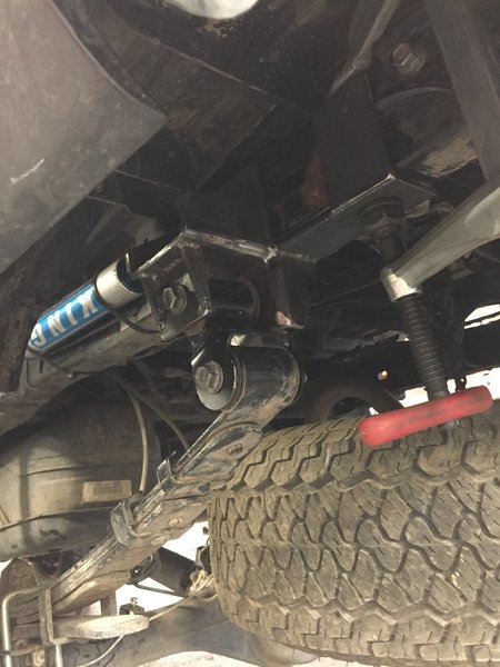

    It's just stock leafs with an AAL from Toytec, the extra height and flex I get is really all from my custom shackle flip kit and the extended travel shocks. image.jpg

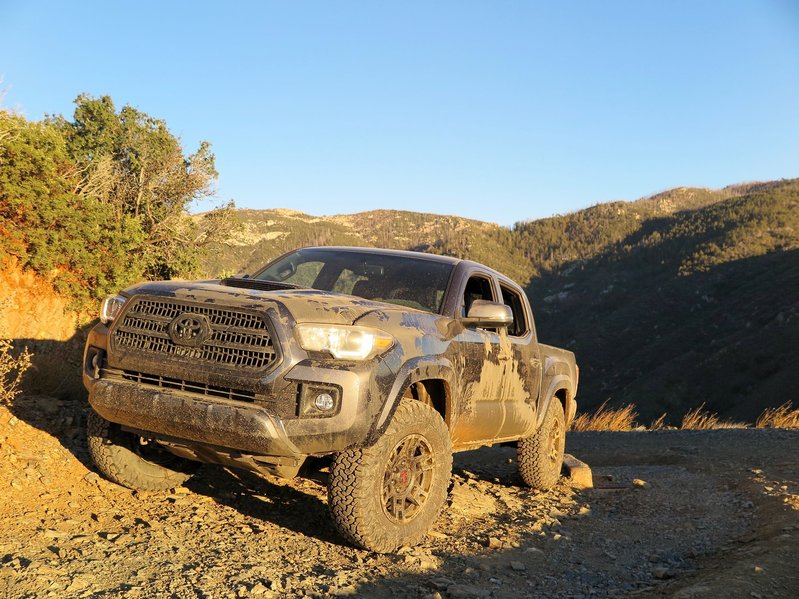

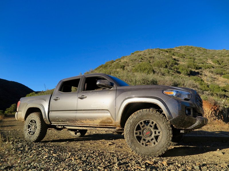

    Had them put on my truck...love them! 275/70/17...slight rubbing on the back front fenders but fixed with cutting out a small piece of plastic. They did a fantastic job off road this past weekend. Mud? What mud? ;)

    Beautiful. Just on trd wheels?

    Yep, that's all. no lift.
