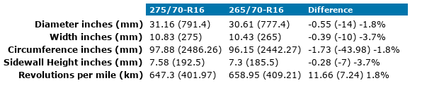

    I have a really simplistic question so forgive my lack of specific knowledge; My truck came from the Dealer with BFG All-Terrain T/As installed in size 275/70R 16. When they finally do wear out, I am seriously considering the KO2 as replacement, as I don't do much heavy off-roading and I like my current tires, so I don't need a really radical off-road type tire.
    My question is this; I want to go back to the stock size, which I think is 265/70R 16. What basic differences should I notice, other then the truck sitting a slight bit lower? Differences in mileage, things like that??

    Yeah, it will be a little shorter and it will change what your speedometer reads now. But it will be a little quicker off the line. What it will do for your MPGs is debateable.
    How accurate is your speedo now? Have you compared it to what a GPS app shows for speed?

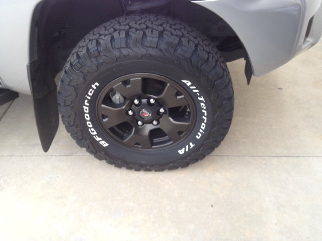

    Freshly mounted

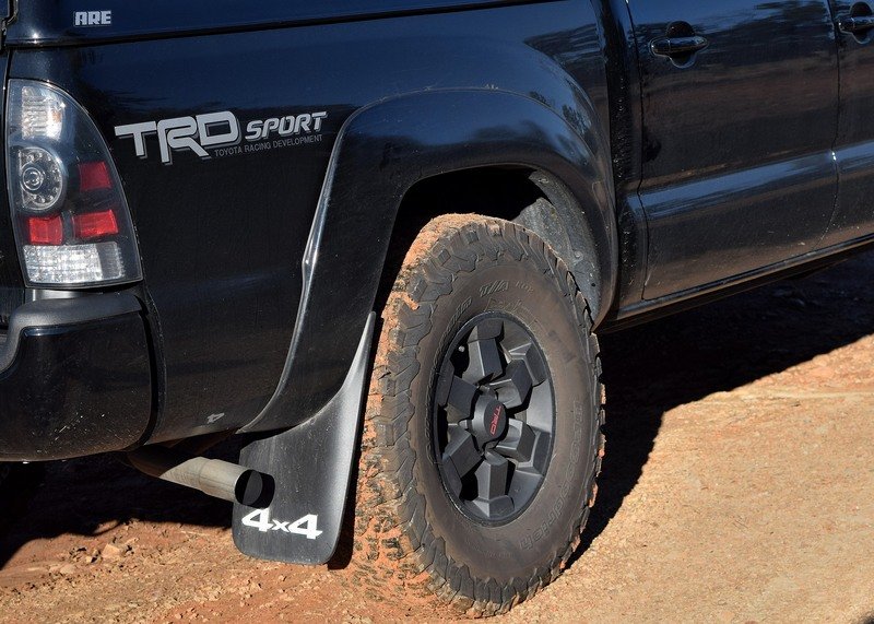

    Bought 265/75r16 KO2s about 3k miles before I installed my 3" OME lift... Figured I'd wear them until they died and then bump up to 285s. Ended up getting on the $100 off $400 Discount Tire purchase and went ahead with 285s... 265s looked ok with the 3" lift but the 285s fill up the wheel well and look soooo much better. Weight between the 265 and 285s were only 4 or 5 lbs per tire, if I'm not mistaken.

    Just got home from a trip to town. On a fairly straight stretch of road, keeping the speedo as close to 55 as I could, my Garmin Etrex was showing a speed of 54.7 to 55.2. My speedo seems to be pretty darn close, even with the 275/70R 16 tires.

    As I understand the rules, for federal certification, the speedo can read high (actual speed slower that the readout) but cannot read low (actual speed higher than the readout) without incurring a fine for the manufacturer. The rules actually allow a manufacturer a 5% error range.
    Toyota typically undervalues their steedo by as much as 5% to ensure they don't get fined. I have seen and discussed this speedo error on many 1st gens and it sounds like it continues on 2nd gens and presumably on their entire product lines.
    By having larger than stock tires, you have actually made your speedo more accurate, as indicated by the GPS.
