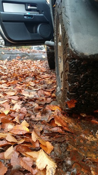

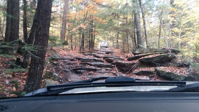

    Foliage from yesterday. And bfg ko2's at 16psi
    I was pleasantly surprised. It had rained 2" Friday-Saturday, then on and off all day Saturday. Soft slick ground/rocks overlaid by wet leaves. Aired way down these did great climbing stuff like this all day. Much less slippage than I anticipated. First time using then off road in the wet and they exceeded my expectations. Kept up just fine with a bunch of guys on mtrs, km2's etc...
    They also help up pretty well, a few heeps in the group I was in cut KM(2's?, whichever come stock in Rubicons) but these held up nicely with no visible sidewall damage.

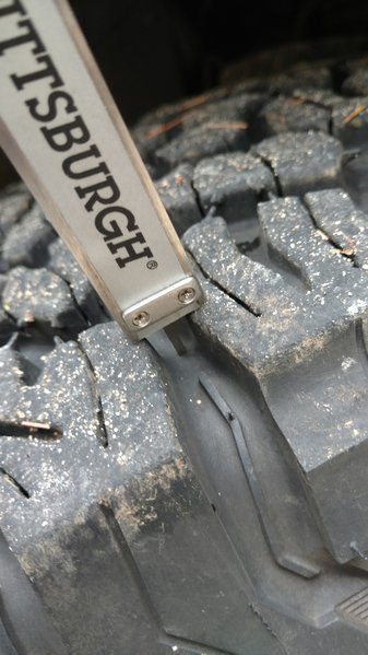

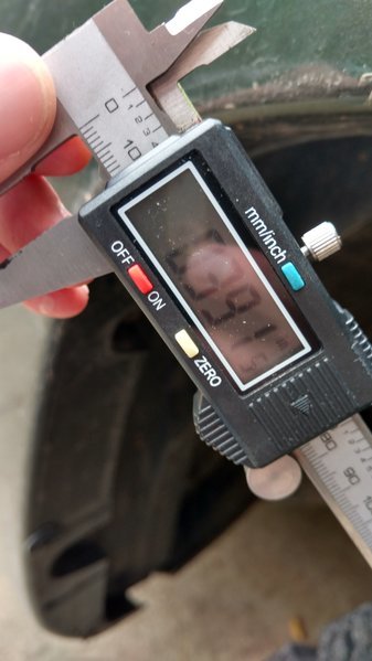

    I finally measured the depth. I'm at 16,250 miles since installing these with 3 wheeling trips and a few stints of heavy towing with this truck. They have been rotated every 4,000 miles and are the load range E 265/75/16s on bone stock suspension. They have been run at 35psi on all 4 corners for daily duty.
    The outside edge of the tread block is at 13/32 and the inner part is near 12.5/32
    I know your opinion is that calipers won't be as accurate as a depth gauge, but the fact is that it's actually just as accurate and far more specific since it gives you thousands of an inch instead of fractional 32nds. Here's how I measured and what I got.
    IMG_20161030_141132232.jpg IMG_20161030_141128430.jpg IMG_20161030_141113969_HDR.jpg IMG_20161030_141110411_HDR.jpg

    Also, I know this forum is full of bright folks, so I probably don't need to do the math, but I will anyway. At my current rate of wear I'll be hitting 48,000 miles when I hit 3/32, the normal depth that most places recommend replacing tires at.

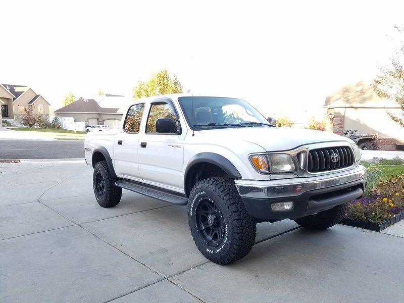

    Finally! After all my research about what tires to get, I decided on the KO2s mainly due this thread. Went from Toyo Open Country 285x70x17 to BFGs 275x70x17. the 285s didn't rub too much after I removed the mud flaps and did some minor trimming, however; I did not want any rubbing at all. with the 3 inch lift I have and rims, there is 0 rubbing with the 275s.
