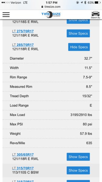

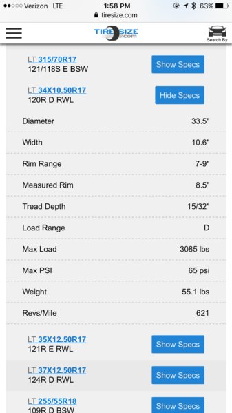

    Alright, Just want to confirm, because I thought 285x70 was smaller than 34x10.5. at least that is what the Tire Calculator shows. I currently have 275x70 in the BFG, and was wanting a taller tire, but if the 34 isn't taller than 285x70 in the KO2s, then It sounds like my 275x70 will probably be the same height, right?
    Rim is a 17 if that helps...

    Here are the specs of both tires from tiresize.com. The one on the left is 285/70/R17 and the one on the right is 34x10.50/R17. Hope this helps.

    So that makes it seem that the 34x10.5 is taller, but after reading a few posts, people are claiming the 34 is really barely a 33 and the 285 is the taller tire. Weird.

    KO2s run small. Not the best way of measuring, but my 265/75/16 measured 30.5" tall under the weight of my truck. I just installed the 34/10.5/17 KO2s and they measure 32.5", again under the weight of my truck.
    https://www.tacomaworld.com/threads/255-85-r16-owners-experience.155849/page-195#post-14306230
    I found this post measuring his 285/70/17 under the weight of his truck and it looks like it measures 31.5”. That's under the weight of a much heavier F250.
    With no weight, probably 0.5-0.75" taller. Again, not scientific by any means, but it's just a rough measurement to give you an idea because I was questioning the KO2 heights as well.

    The listed heights are the tire unmounted
