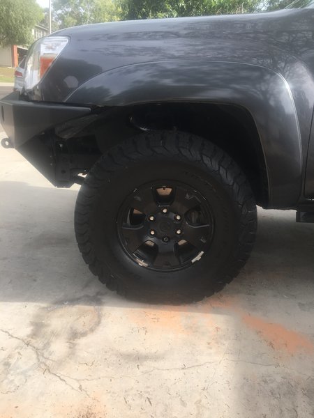

    Went 285/75/16s from Discount Tire and loving them. About 200 miles on them. They ride great with no issues so far.BFGs.jpg
    1.5" leveling kit with 1.25" Spidertrax

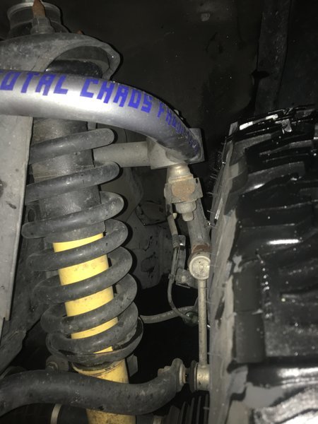

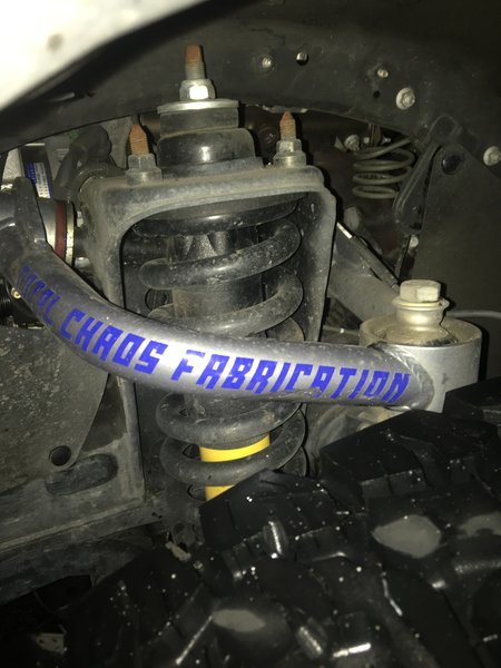

    Soooo put on the 285s
    I'm rubbing the UCAs (Total Chaos) at full lock. OME suspension (Dakars & 885s).
    The stock TRD OR wheel specs are: 16x7, +32 mm offset, 5.25" backspacing, 6x5.5" bolt pattern.
    In order NOT to rub at full lock I need a wheel with less offset, right?
    I searched and people either got different wheels, had a shop try and mess with the alignment to fix the issue, or go spacers like these... Pics of my rubbing for your guys' info!
    Thanks to those who offer advice!!!

    Not huge on spacers when you could get a new set of wheels for $400 (give or take) as opposed to $200 wheel spacers...

    Spacers are a quick diy solution and you can resell them on here for 75% of what you paid. I've not seen a set of 1.25s stick around long on the for sale section here.

    I had no issues running that size while stock. Each truck is a little different.
