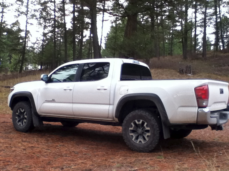

    Here's a crappy picture of yet one more size option: 245/75/16. These are almost the exact same height as stock (30.5" vs 30.6") and an inch narrower (9.8" vs 10.7"). They came over from my last truck, otherwise I would have gone a bit taller. I've got about 3k miles on them in snow (some deep), rocky trails and highway and no complaints. As others have said they are an E tire, and heavier than stock. I noticed the ride difference more than the MPGs. They were installed at 45+ psi, I like to keep them around 34-36 cold for a better ride.

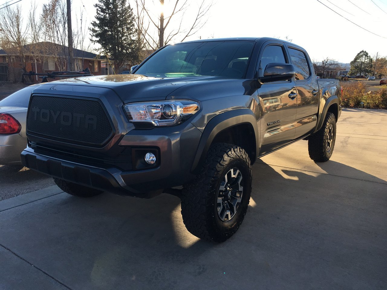

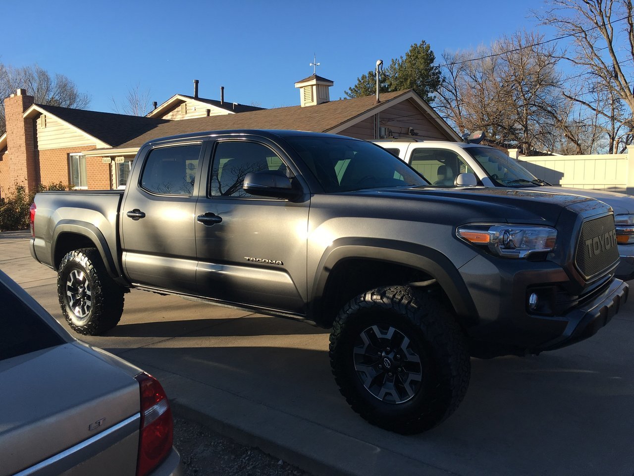

    I put 265/75/16’s on my off road and spidertrax spacers. I love my KO2’s!

    Looks really good! What size spidertrax spacers did you go with?Lift?

    Thanks! 1.25” and Bilstein 5100’s up front on the middle setting.

    Hi there, I know this is an old post but I wanted to ask you, you said you added bilstein 5100's up front. What is the middle setting 1.5 inches or 2inches? Also did you have to to do a CMC or cut some wheel well plastic when you added the 1.25 Spidertrax wheels spacers so your tires wont rub? I'm looking to do the same but do not want to cut or chop anything. I also added KO3's to my stock OR wheels 265/75/16 love how they look but I want the wheels to poke out more. Your truck looks great!

    I don’t remember what setting I had the 5100’s set to. No CMC and no cutting at all.

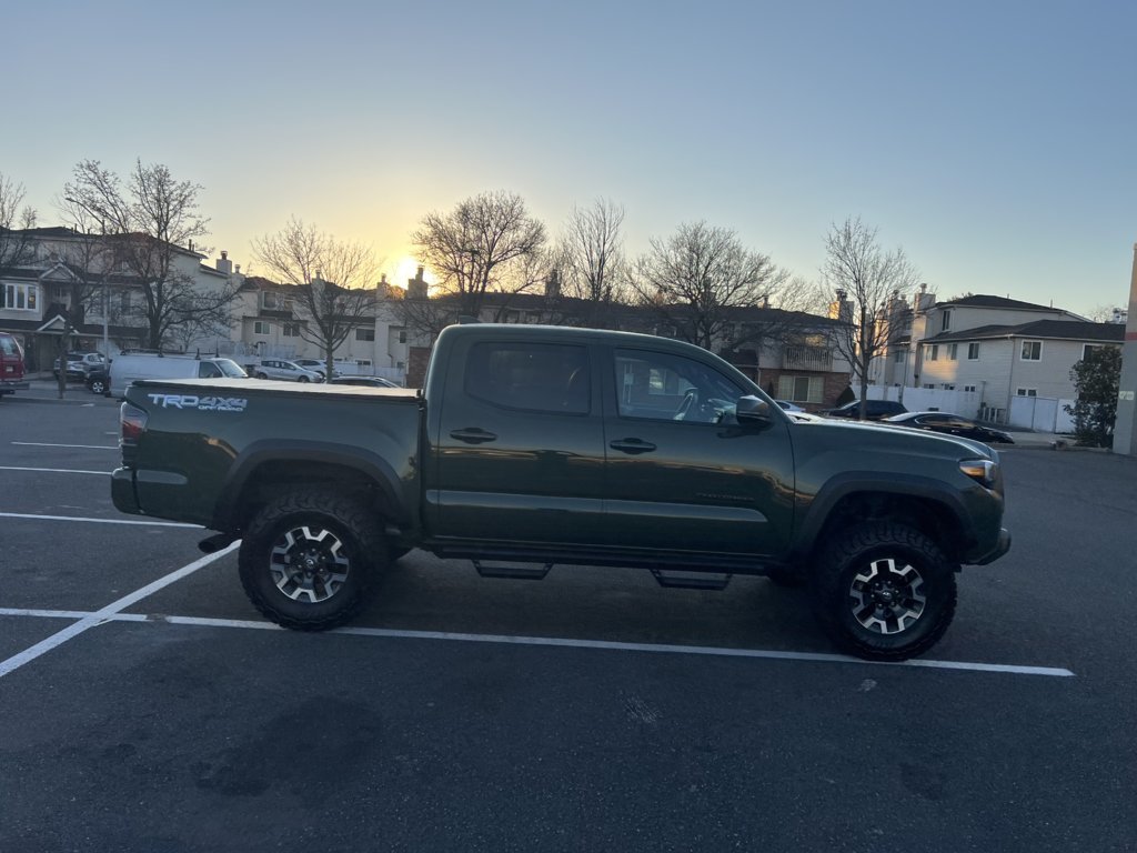

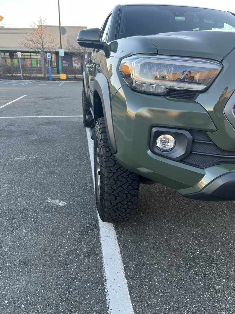

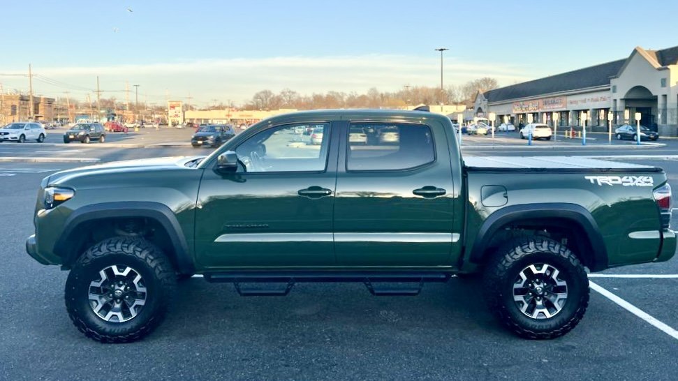

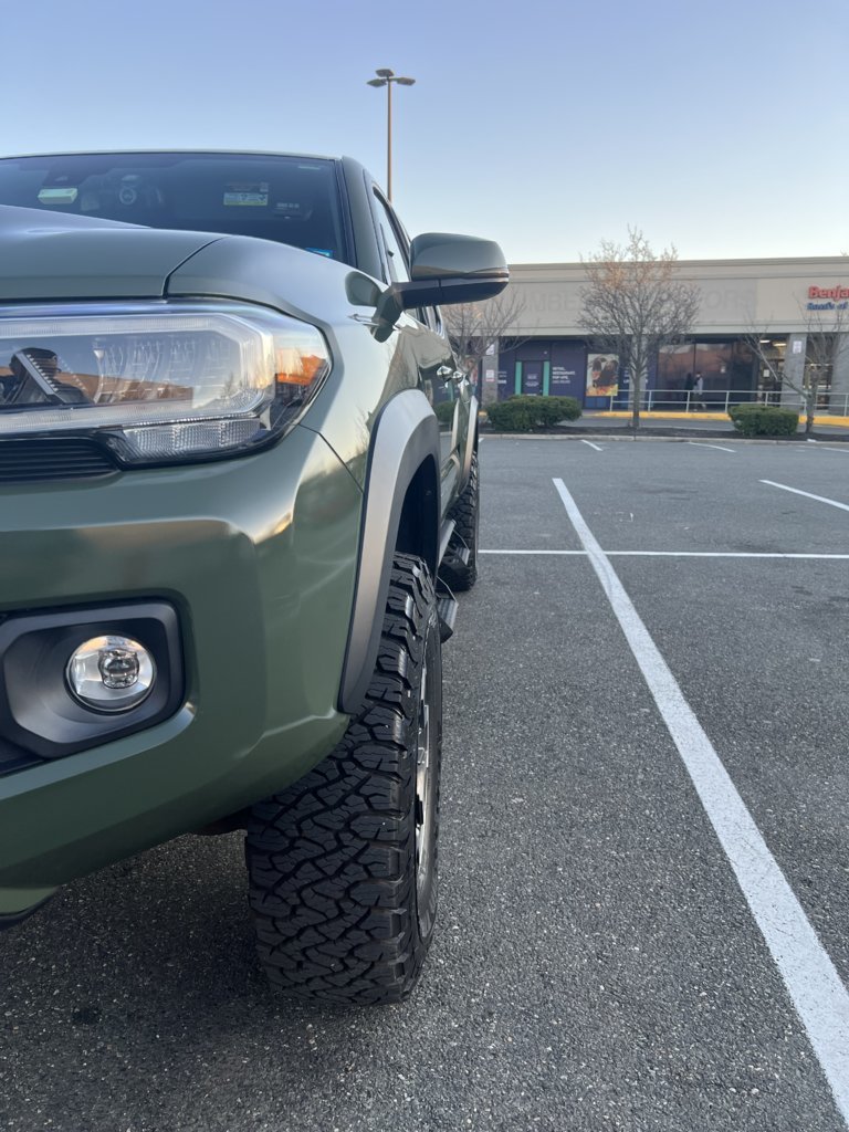

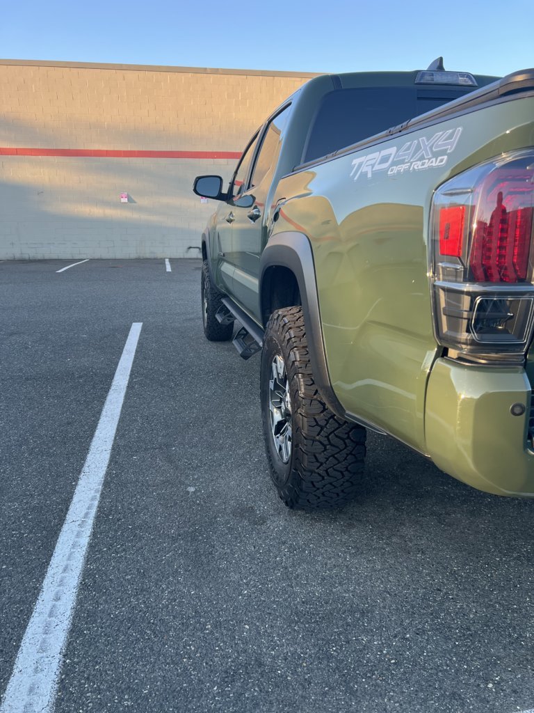

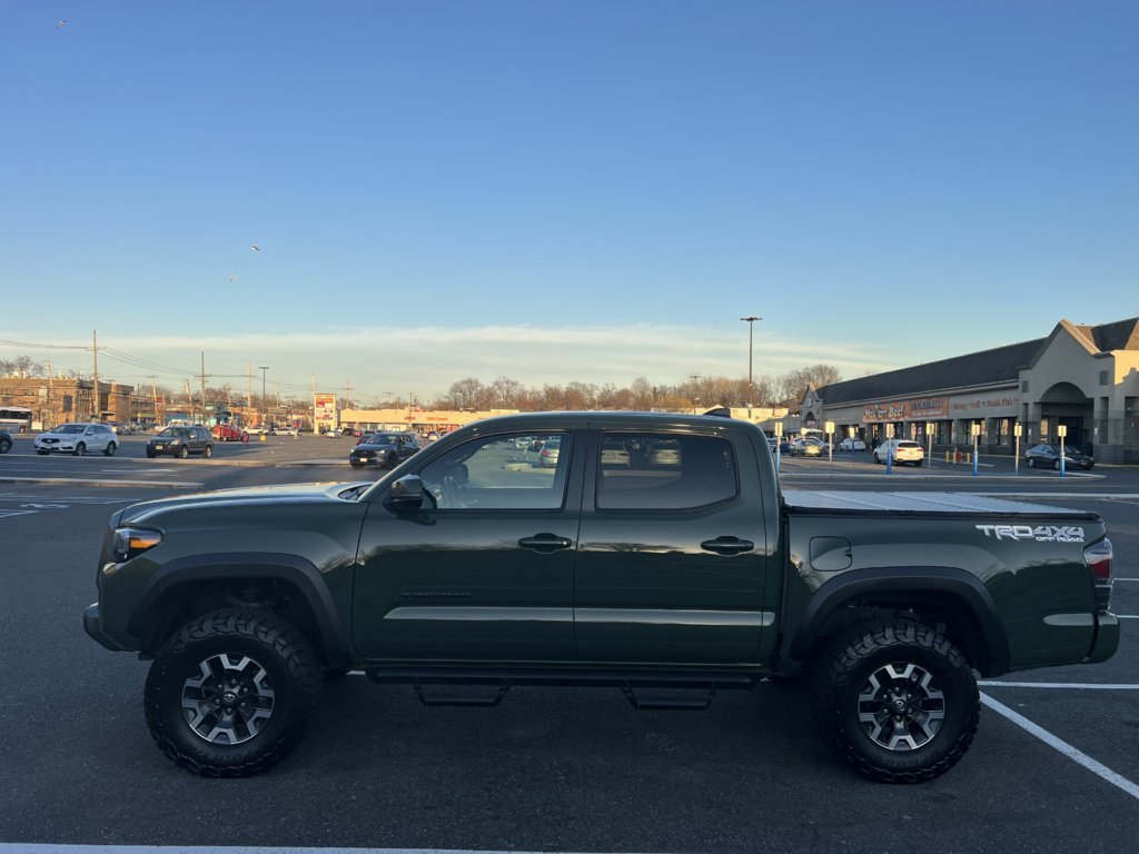

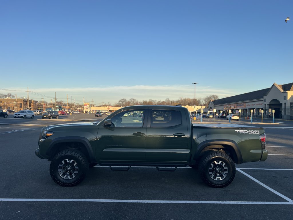

    Man, I love how this worked out! 265/75/16 KO3's. Bilstein 5100's on all 4 corners and a Bison off-road 1" block in the rear. 2"lift up front and 1" in the rear with Spidertrax 1.25" wheel spacers. Absolutely no rubbing! No wheel well cutting and no CMC. 3rd gen Taco's should have looked like this, out of the factory!
