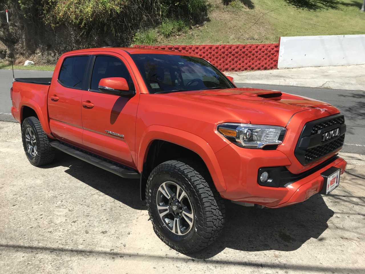

    I bought 4 Falken 265/70R17 for $139.00 each, good deal and they look great.IMG_2190.jpg

    2015 Tacoma TRD OR DCSB 4 door
    OME 2.5 886 Dakkar suspension, ARE shell, with Thule bars and cargo rack,
    Not sure of the fender opening profile on a 2018 but I put that sized tire in my 2015 without a lift and they did not rub.

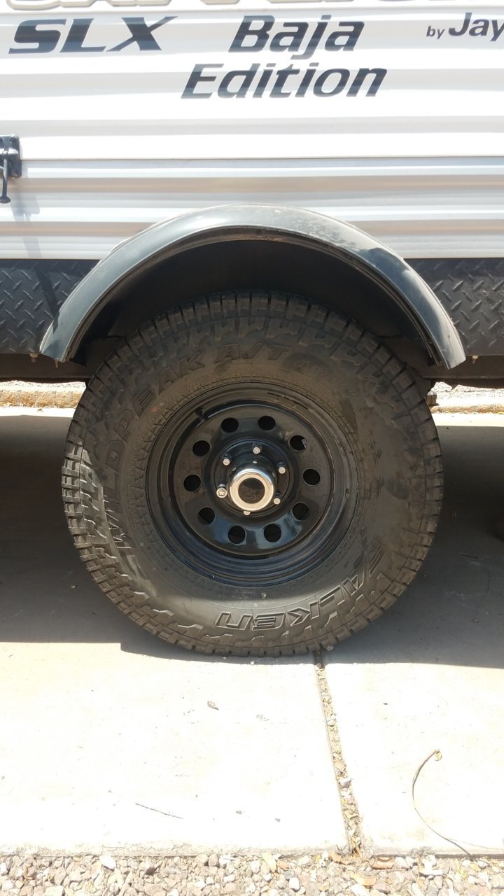

    I recently put 235 85r16 Falkens on my trailer. Really smooth and quiet for an LT. Also amazing price for the quality on these. If they came in 255 85r16s I'd consider them for the truck.
