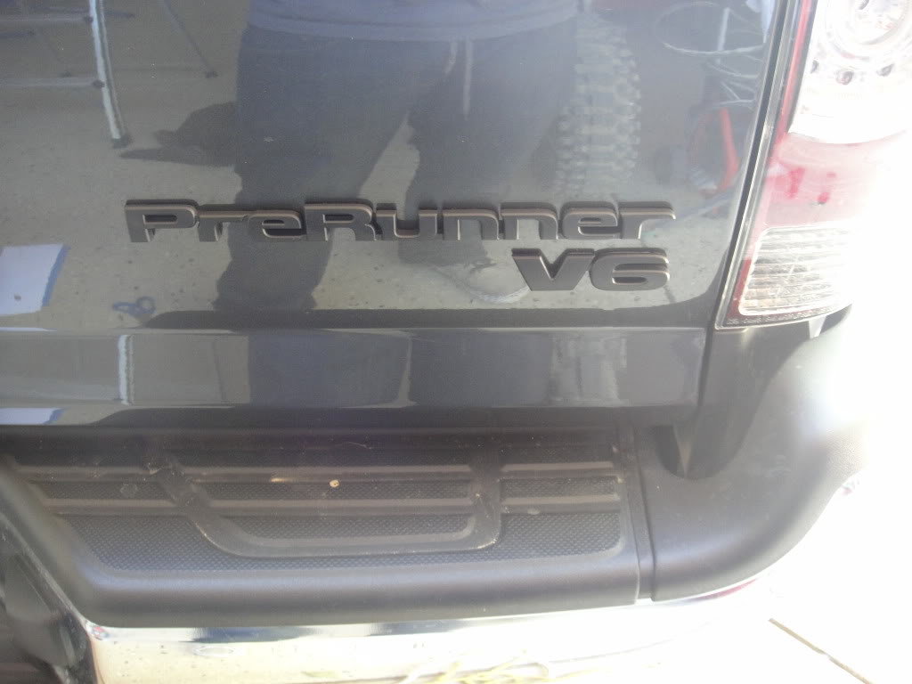

    Took off my logos to paint flat black, pretty quick and easy mod- no plasti-derp here

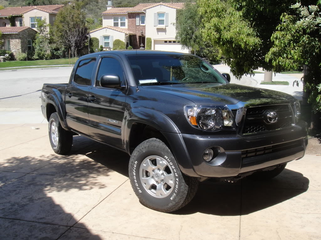

    added some billies, set em at 1.75 to level it out
    primed and rattle canned rims flat black
    my new goodyear MTR's really happy with how they look

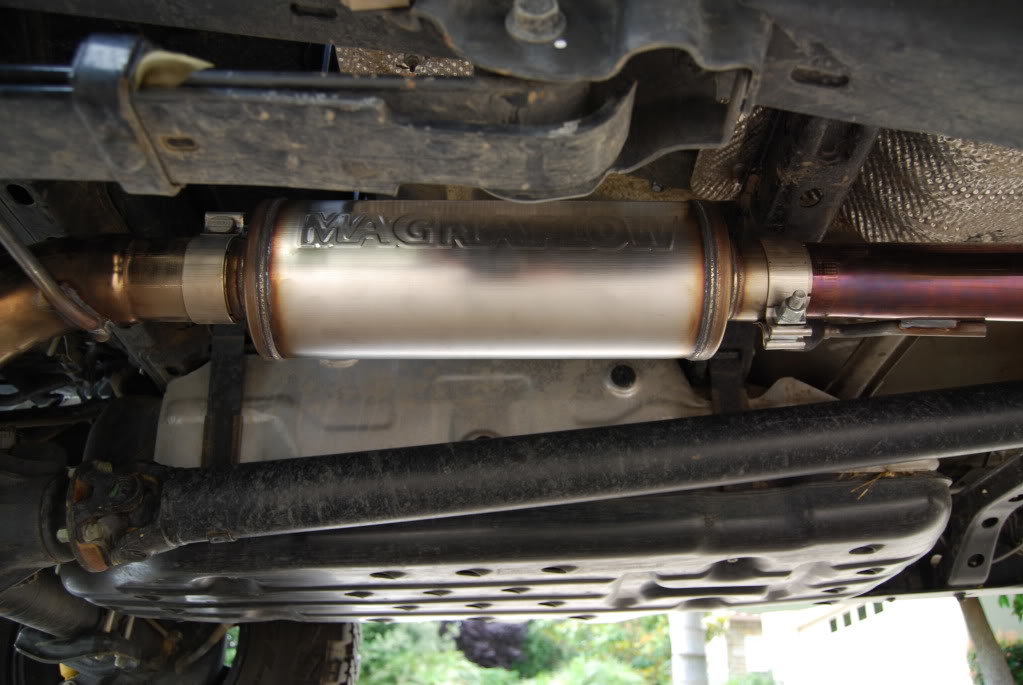

    Cat-back exhaust magnaflow offroad pro

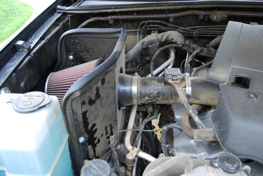

    K&N

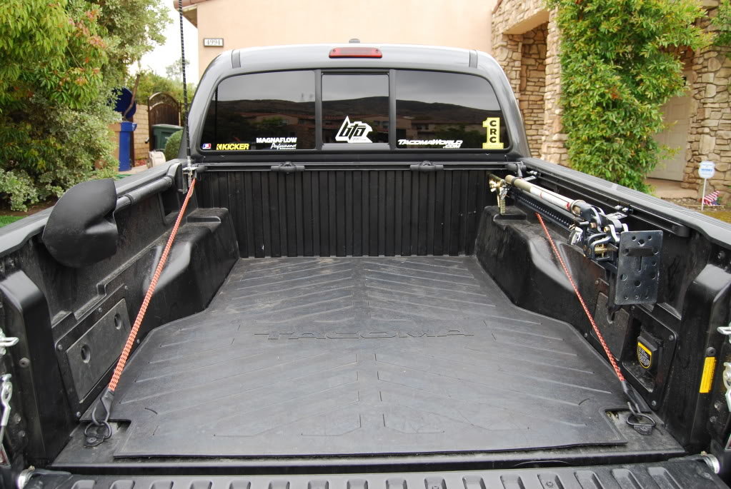

    mounted hi-lift and shovel

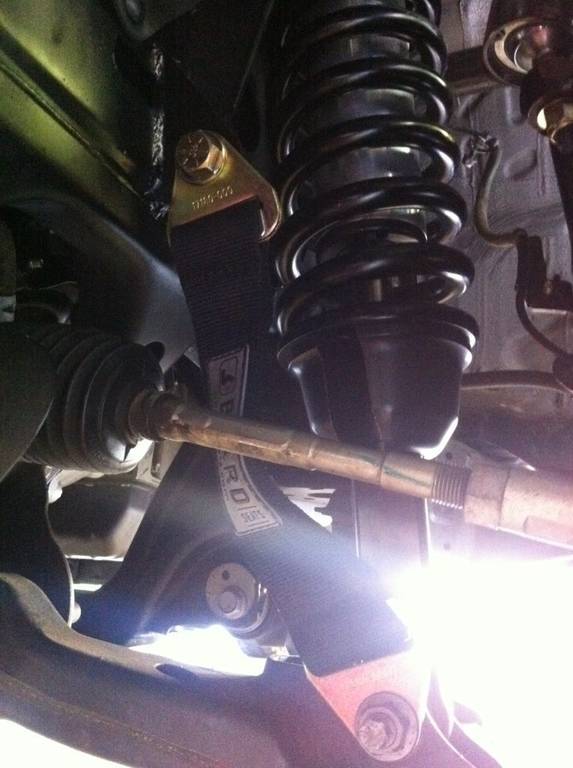

    thought it was time for some midtravel in front
    then threw some straps to help the shocks when at full droop

    Great looking truck man! Looks similar to mine :thumbsup:
    Any tips on the black badges? What kind of paint did you use? That's gonna be one of my next mods I think...

    thanks i used fishing line to saw off the emblems and i used krylon flat black to paint them and hairdryer to put them back on

    okay so i debadged mine and i cant get the glue off the door.. howd you manage to remove yours?

    i didnt, i left it on and used a hairdryer to re stick the badge on it, but if you still want it gone use brake cleaner and for the small residue use an eraser

    Alright thanks! Did you have to rough up the chrome or anything to get the paint to stick? And no problems with reusing the same adhesive?

    no problems and nope probably shouldve though i was in a rush, no chiping yet!

    I used "goo-gone" to take the residue off after i took my badges off, it works great.
