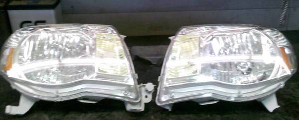

    Thanks guys, I just picked up a set of stock headlights from work (free :D). They are off of my parts managers truck from when he wrecked it. One of the lights is perfect and one has a broken tab but I was able to get a replacement tab for it. Everything else is perfect on both of them. I figured I would use these ones to do the retro fit. By all the research Ive done Ill probably go with the FXR's with gatling gun shrouds. I already have 8000k 35w HID's in my stock housings.
    How do you guys feel about the angel eyes? I like them but Im not sure what size or if they will fit with the gatling shrouds... also are they easy to install?
    Any ideas on the paint to use and what I should do to prep for painting?
    Free headlights below (not a good picture)

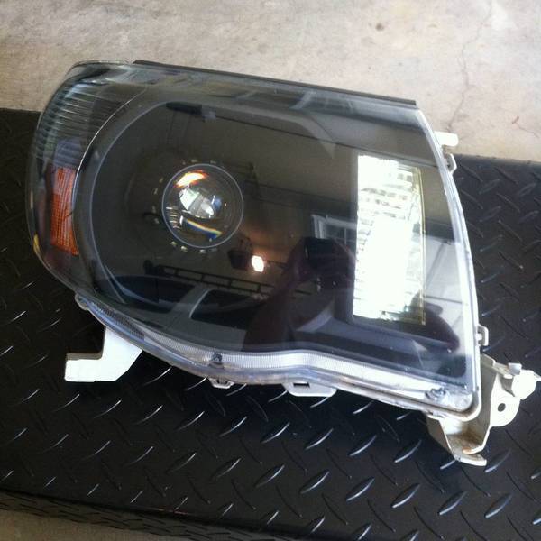

    Love mine, I painted mine completely black, not just the BHLM. Also I have the halos and they are a nice added feature.
    Here is a photo, sorry for the reflection off the light.
