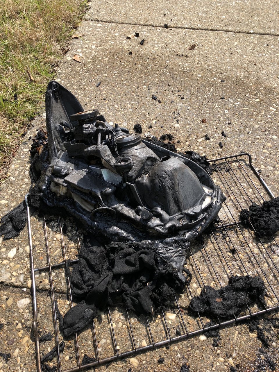

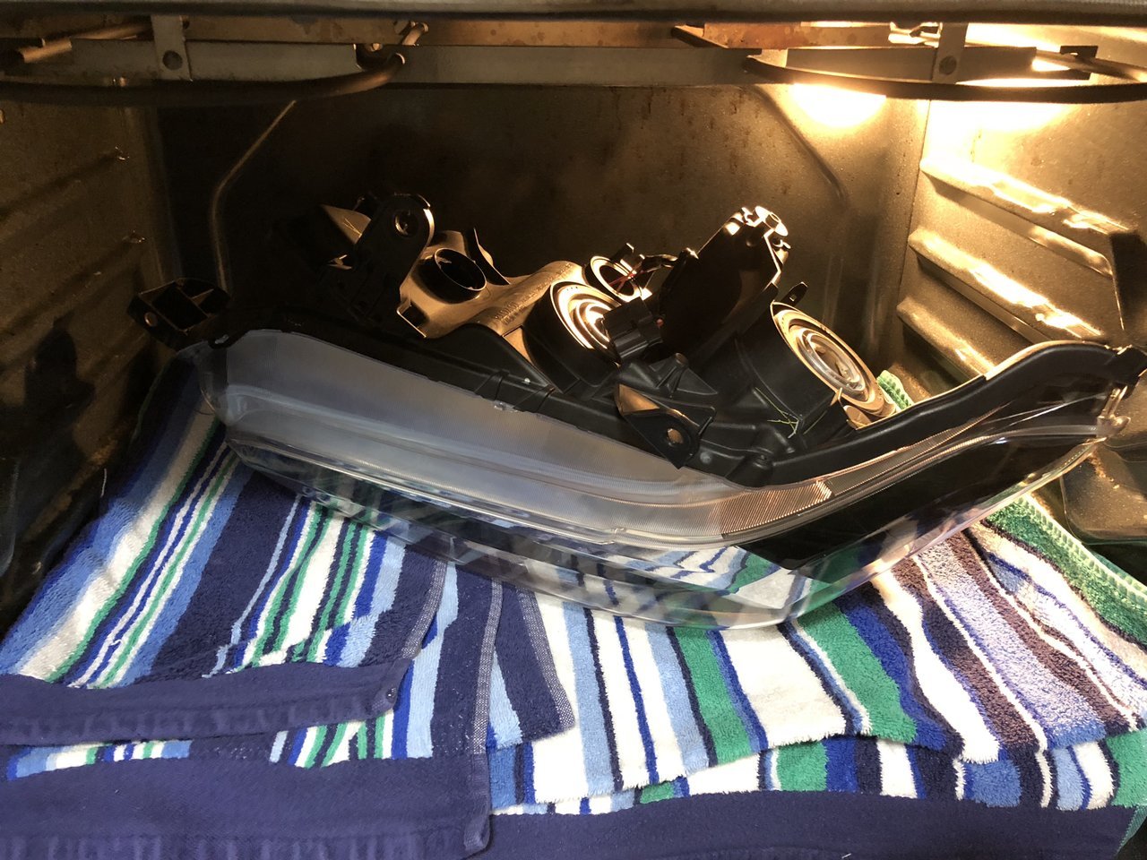

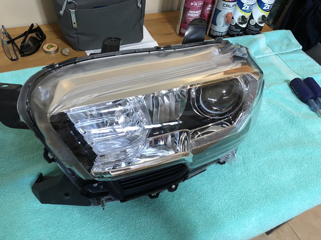

    So after reading about it for 2 weeks and learning all I thought I needed to know to do it myself, I went ahead and attempted a BHLM today. Everything went fine as far as removal, got the lights inside the house, screws out, ready to cook. Placed light in oven on bath towel so as not to melt the lens,pre-heated the oven and began to cook these babies.
    1st bake - 250 for 12 minutes didn't work.
    2nd bake - 290 for 15 minutes didn't work.
    3rd bake- 290 for another 15 minutes didn't work.
    4th bake - 300 for 10 minutes..........the pictures tell the rest.
    Good news is no one got hurt and the house didn't burn down. Also good is that my wife is away for 4 days, so hopefully with enough ventilation and Febreeze I can get the acrid burnt plastic smell out of the house.
    Bad news is now I have to buy a new oven and a new headlight housing. My out of pocket for these is going to cost just as much if I'd just gone ahead and bought the PRO lenses from a dealer for $1300 outright.

    Yes. The towel is what initially caught on fire and started the whole thing. I was in another room and came back after it had been in for about 7 minutes, so the fire had already gotten pretty aggressive by then.

    I just called my local Toyota dealer and they are holding a replacement for me. Gave me a military discount, so it's ONLY $709.00 UGH!!!!!
