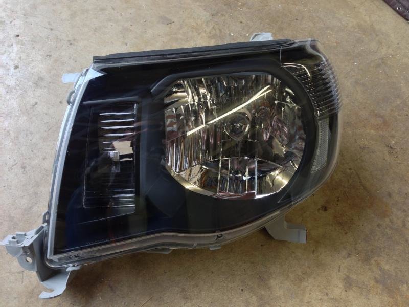

    I just sent one back today. The driver's side is well sealed and does not leak. Although it is aiming at the sky. Slight adjustment of the reflector, and it's better.
    The passenger side is another story. Looks like the top clip never seated. At least that's where I see water coming in. After a few emails, they are sending me another, once they receive this one. Purchased from eaglemotorsport on fleabay and they have pretty good customer service. If it leaks, send it back.
    [​IMG][/IMG]
