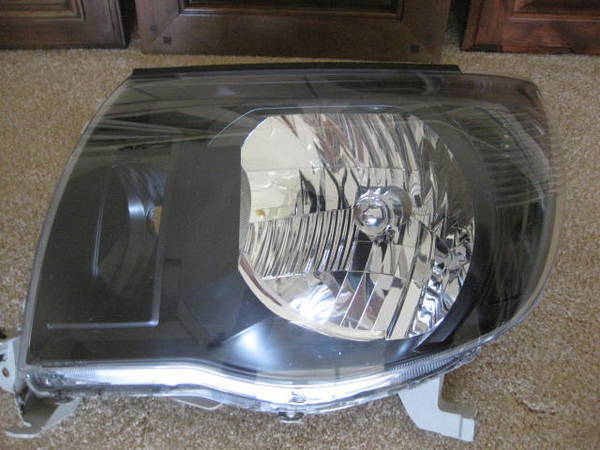

    Well I finished the lights yesterday and am about to put them back in. When I was cleaning them out I decided to smoke the reflectors and put them back in, not very noticeable but I like it. Anyways I used 2 5oz tubes of adhesive, 1 for each light, and I am hoping this will be enough to completely seal them:D but only the summer monsoon will tell.

    And here are the lights

    nice they look good
