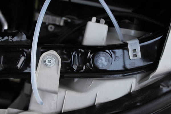

    I did the Land rover fix to the problem of condensation. Say what you want it works. Tubes draw in and exhaust air.

    Any pics of these on your truck, this would really help out all the people that acutally do bhlm and retros:)

    Let me get home this evening and i will post one

    Here ya go. Inserted the tubes with clear silicon so the wont fall out. Can create you own variation of this. No issue what so ever since i put these in and didnt have to take apart my lights agian.

    Is that one tube connected? or two separate? I just did the BHLM today and i'm paranoid about moisture.

    So McDowell with the smiple venting via the tubes it can't prevent fogging, but once fogging/condensation occurs inside the light, the tubes open to air cause increased venting and then resolution of the condensation more quickly? Or are you saying that the tubes can actually Prevent fogging?
