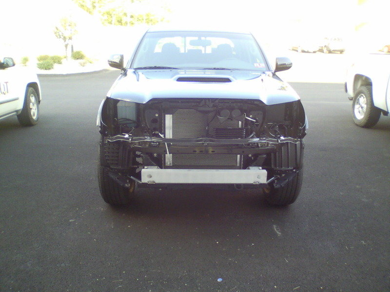

    attempting this this afternoon on my '12. Is it easier if I take the bumper off? I'm afraid I won't be able to get it realigned when I put it back on.

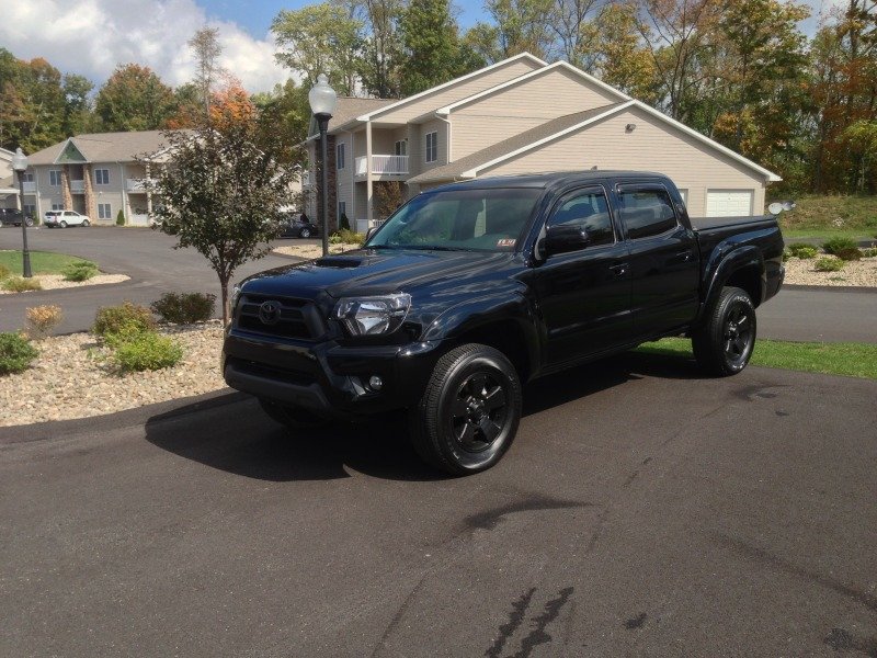

    561, FL
    3" Pro Comp, 5% all around, Antenna X shorty, Debadged
    success!! Easiest mod I've done:
    Don't mind the smudges, still need to be washed off.

    OK JDM, give me some tips on this. Did you take your bumper off? I got a 2012 silver Taco too, I want this mod badly! Give up any advice you can!

    It would be easier to take off the bumper, but I didn't have to. I have long arms so I just reached underneath and removed the bolt from behind the bumper area. Removing the lights was the hardest task, all you have to do is turn them to where the turn signal side is facing up and pull straight out. After you remove them they're pretty straight forward from there. I preheated the oven to 315 and left them in there for 10 mins, made it a piece of cake to remove them from the housings. Good luck man.

    I removed the bumper on my 2012.. it's very very easy and makes removal/install of the lights a breeze.

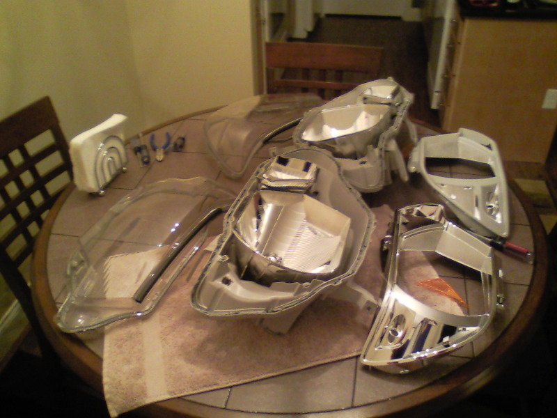

    mine came out perfect. i used outdoor waterproof/temp proof clear silicone to go around the seam 'just incase' it didnt melt back together. i figured better safe then sorry. Been done for going on 2 months now and absolutely no moisture inside. perfect.

    Relying on the screws to help with the sealing process is probably why you didn't have a lot of success with your '07; all the screws do is hold the assembly together. It sounds like you need to focus more on the sealant.

    did my 06 first which it wasnt as hard as i thought.. then i did my 12 when i got it and i just did my wifes mazda 3 which to me came out the best since she has projectors and i did the entire headlight black!

    thanks man my wife was not all for it at first but she loves it! it took all day to do because i had to take the entire bumper off but came out awesome..

    mine went alright was a lil nervous putting them in the oven, paint came out great but have had problems resealing them, pulled them apart 3 times now and still get moisture in them. looks like no more muddin for me :(:mudding:

    I put a bead of silicone around mine after sealing them back up & made sure it got in any gaps I had. I did mine bacj in july & haven't had any moisture.
