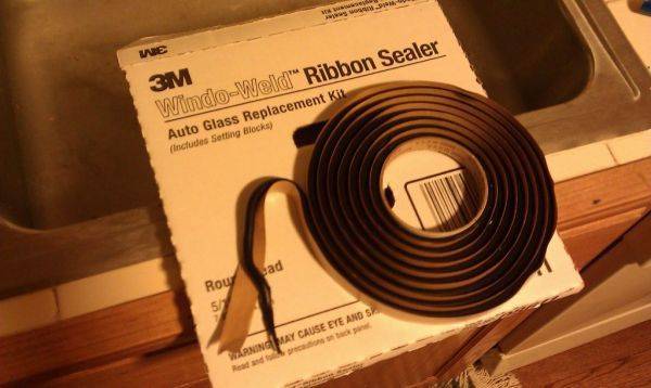

    This is what I used. I heated the housings in the oven @ 200* for 8 minutes and scraped out most of the glue with an old flathead screw driver. Then I stretched the window weld so it lays in the groove easily, heat again at 200* for 8 min. and pressed them back together and used aligator clamps ( under $2 each at Home Depot). It worked great and they haven't fogged up.
    This is the stuff. Found it at Pep Boys
