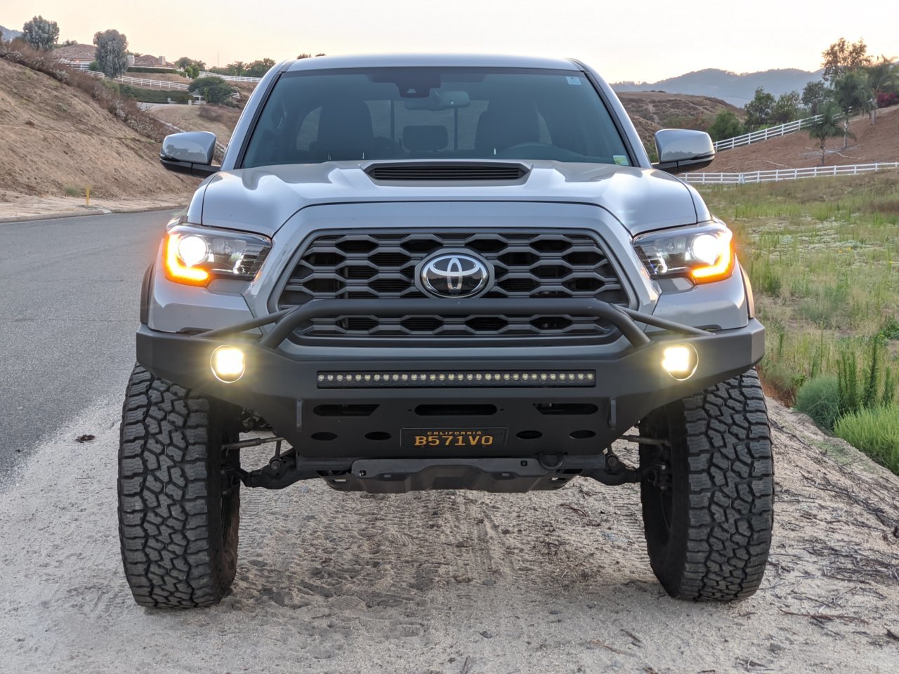

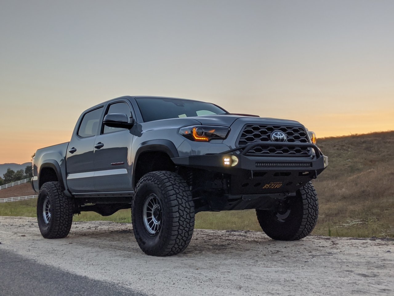

    Here's the finale of the mod. I love all of it.

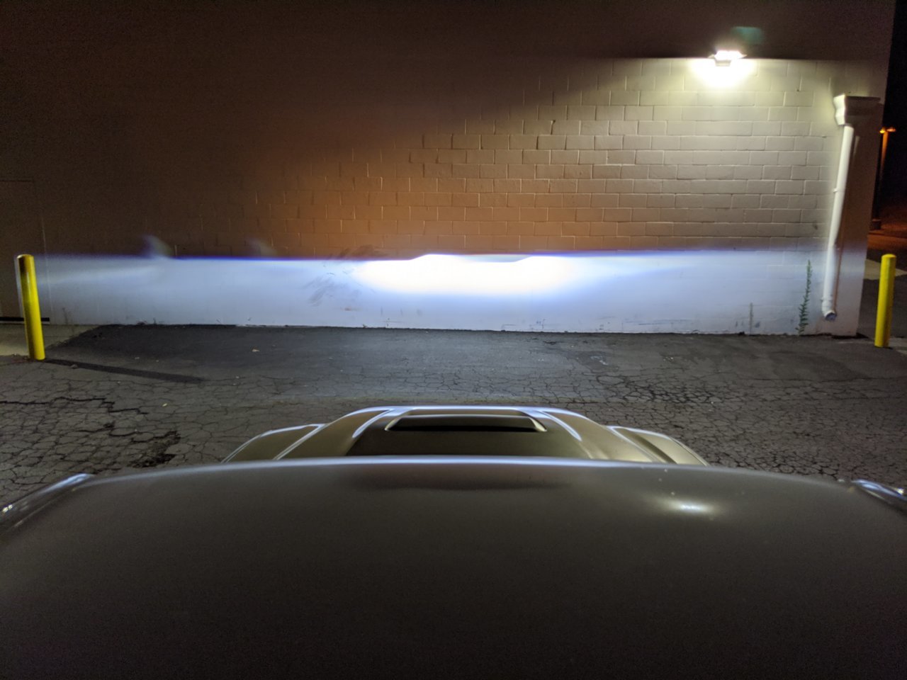

    Look at that damn cutoff. Zero glare either. Amazing.
    High beams

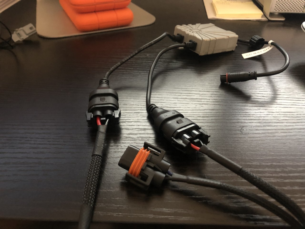

    Do it, go bi-xenon or bi-LED. I went bi-Xenon and couldn't be happier. You need an H11>9006 splitter for the high beams, really easy to do.

    If you want your stock high beams + the bi-led function it’s a H11>H11/9006 splitter.

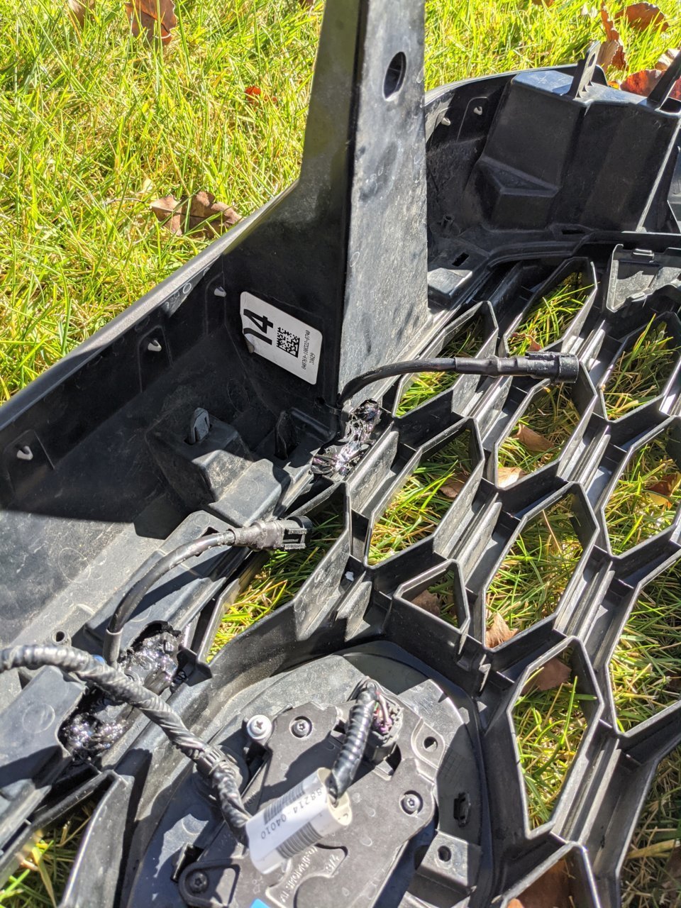

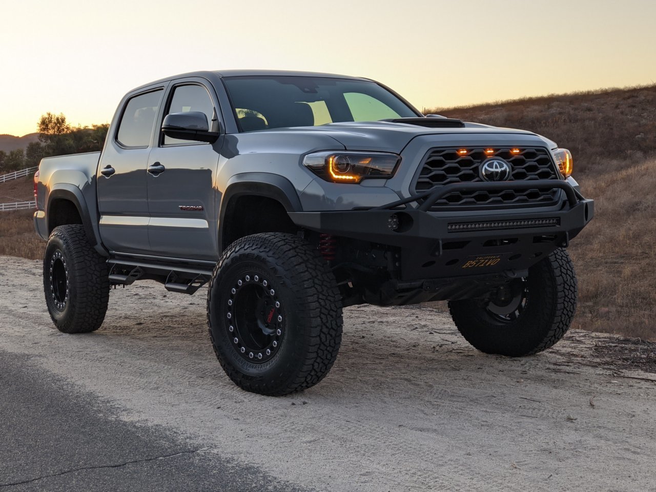

    Oh I totally forgot one more thing I did, I added three of the 'smoked' raptor lights to the 2020 TRD grille. I did it with brute force. Ordered the smoked raptor lights (Amazon I think) and dremeled the lights and the grille and the grille mount until it all fit and then I glued it like a savage. Looks terrible from the back, but GREAT from the front.
    The amber DRLs + amber raptor lights looks amazing. I get asked about these headlights more than any other mods on the truck.

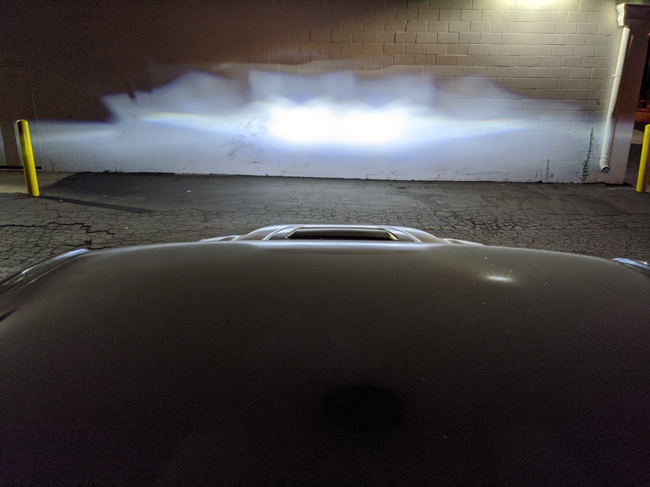

    because the bowl reflects light in a more dispersed area than a projector does. It is spread over a wider area and more uniform all around where the projectors focus the light. I kept my stock high beams on my retrofit and there is a noticeable (negative) difference without them.

    Hmmm, that doesn't reflect my experience with these Bi-LEDs. I understand that the high beams sends light all over with the chrome reflector, probably more spread than the focused retrofit lenses, but I don't feel going with the Bi-LEDs alone was a downgrade. When those shields go up, light goes everywhere.

    Pics of the difference would help.

    As from this picture, the Bi-LEDs with the shield lifted (high beam) send light everywhere. This is only at 25' for aiming. On the road, the light spread is pretty amazing. I would go so far as to say that the high beams are brighter the 30" lightbar I have in the bumper. I can turn on the lightbar and barely see a difference from the high beams.
