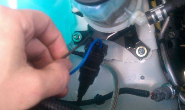

    this is the driver side

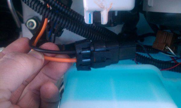

    passenger side

    This is the lay out that i have!, again I have no low beams but i have hi beams connections are good and polarity has been tried any ideas >
