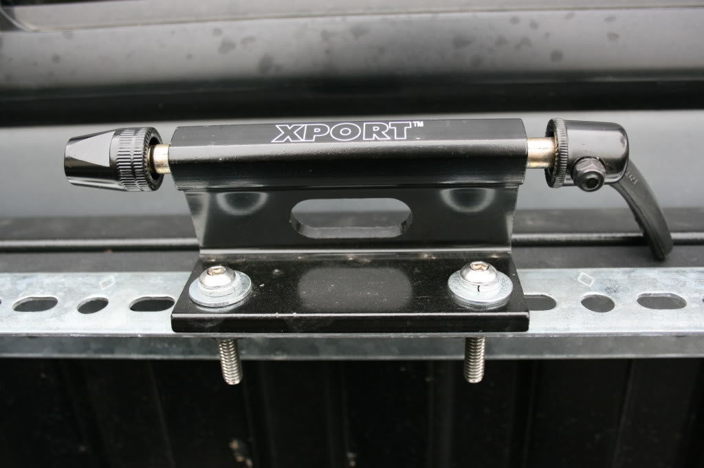

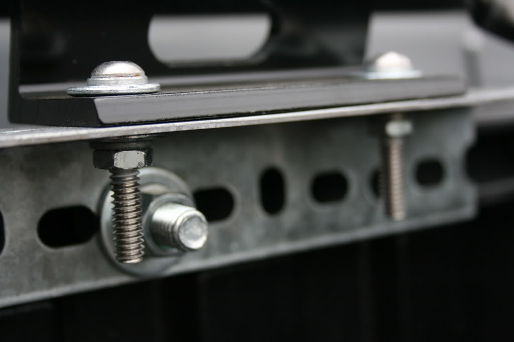

    Just get a fork mount carrier, around $20.00 bucks and two Carriage bolts that slide into the rails. Mounts anywhere on the rail and won't use up a rail cleat.

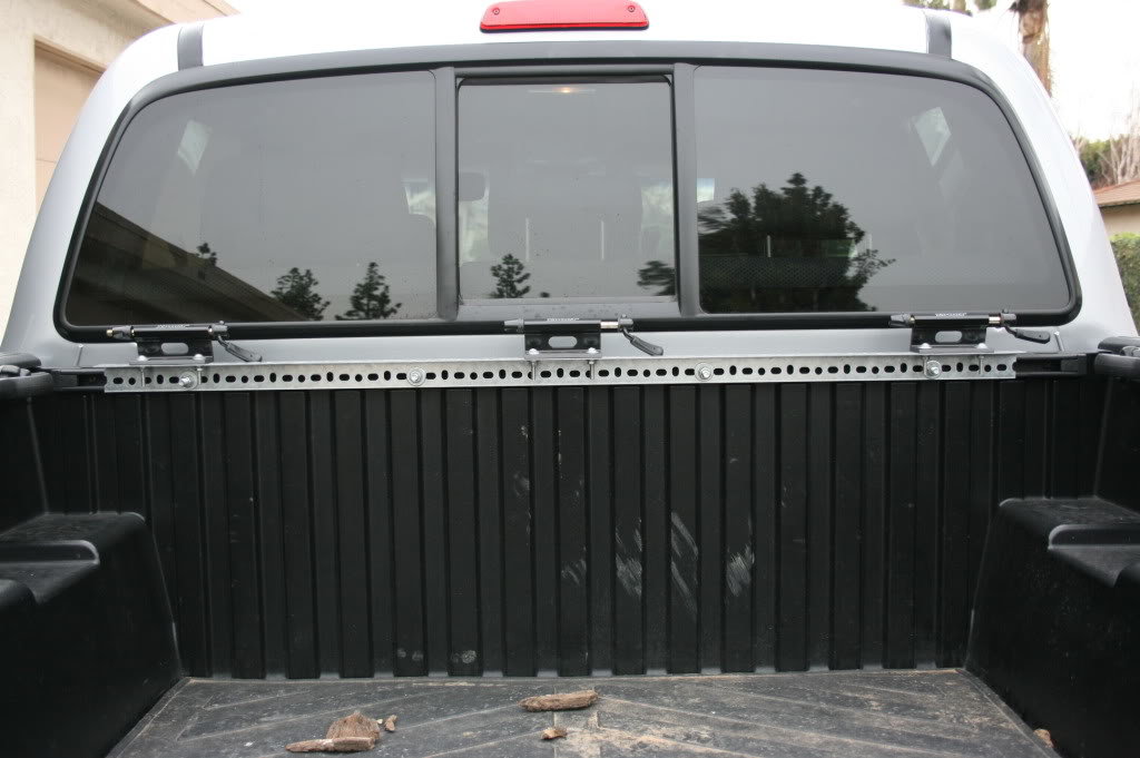

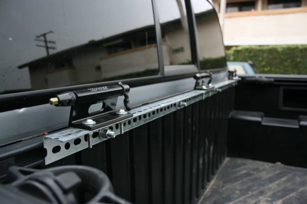

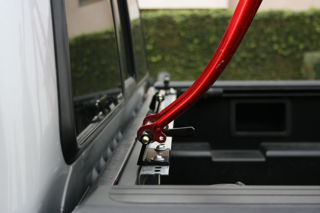

    here's my version:
