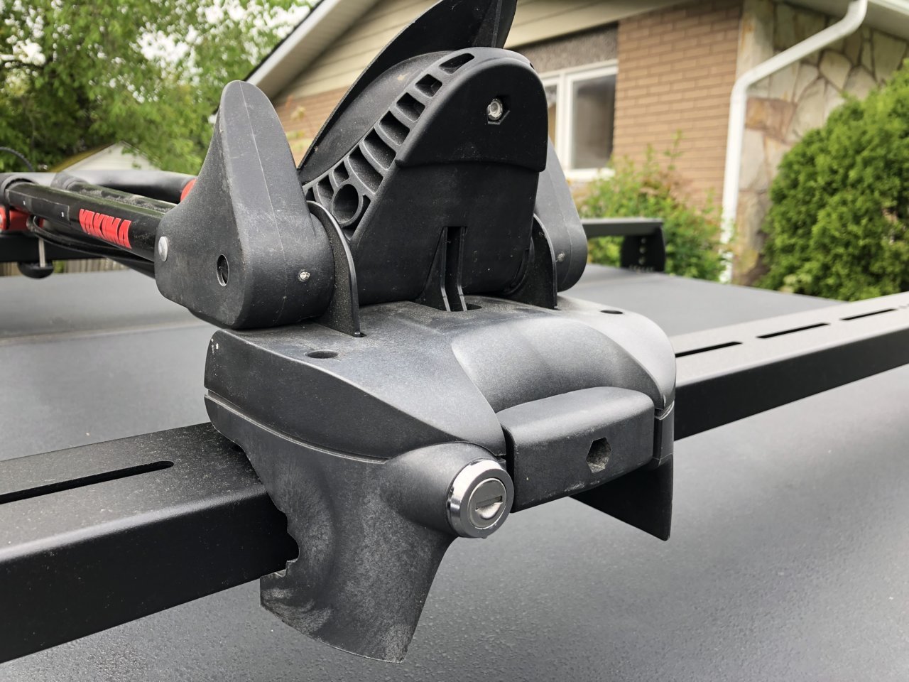

    Yes I can confirm the Yakima Frontloaders do not fit unfortuantely for me as I ordered the KB Voodoo crossbars and picked up 4xYakima Frontloaders off of Kijiji. I am not looking for a way to mount the round tube Yakima cross bars to the KB Voodoo bars - a bit silly but I really wanted a tonneau cover with bikes above it. Anyway will post pics once I figure out how I will modify it.
    Also can confirm the anodizing on the KB Voodoo comes off with friction between the uprights and the cross bars, I will look into some Rust-Oleum products to touch up the rails and uprights. I have only had them for 3 weeks.
    Anyway still in love with the truck just need to find the right setup - I feel like there is a huge gap in the market when it comes to mounting things above a tonneau cover and being able to quickly remove that system still use the bed of the truck to haul large items. Taco on fellas!

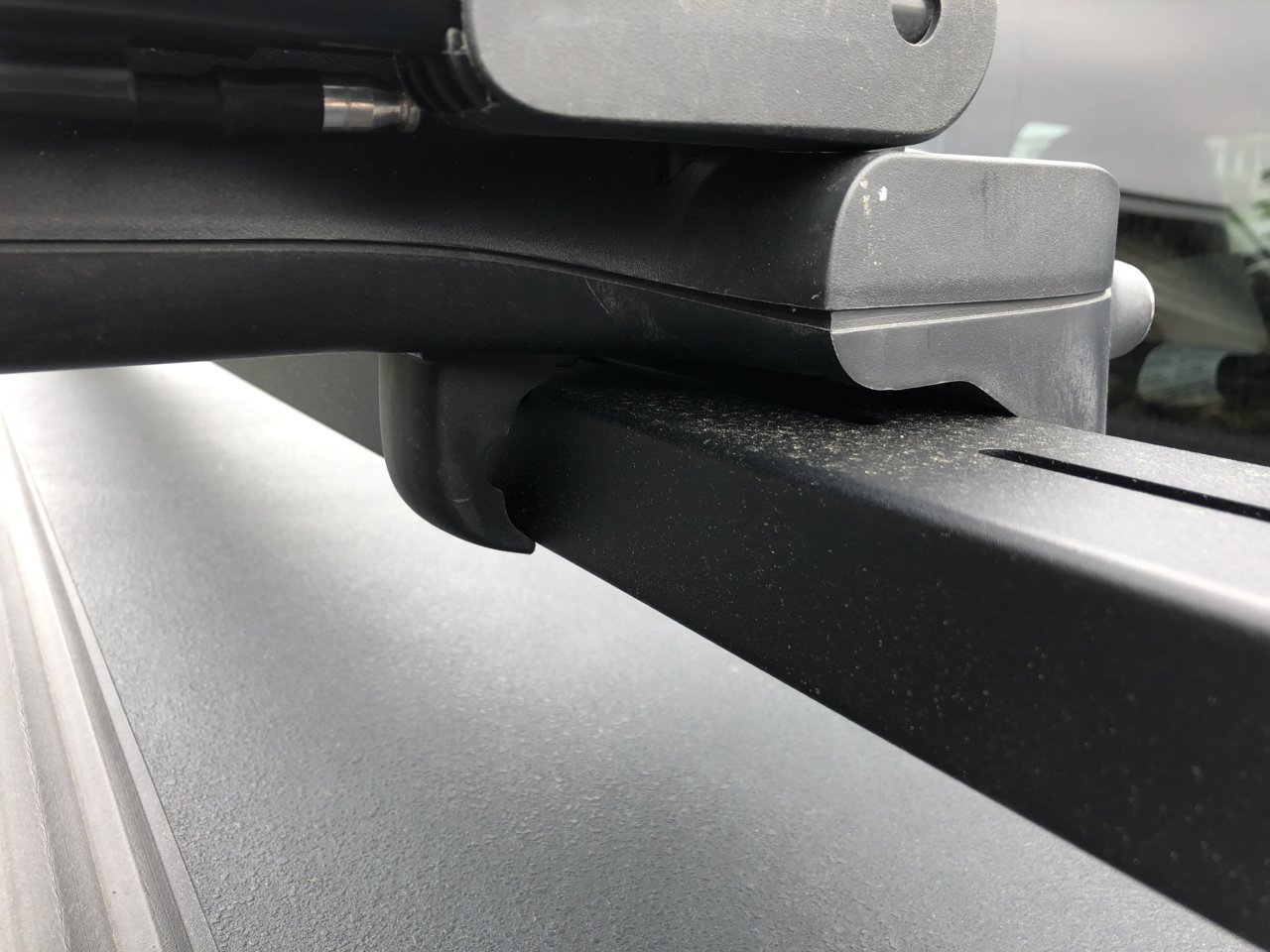

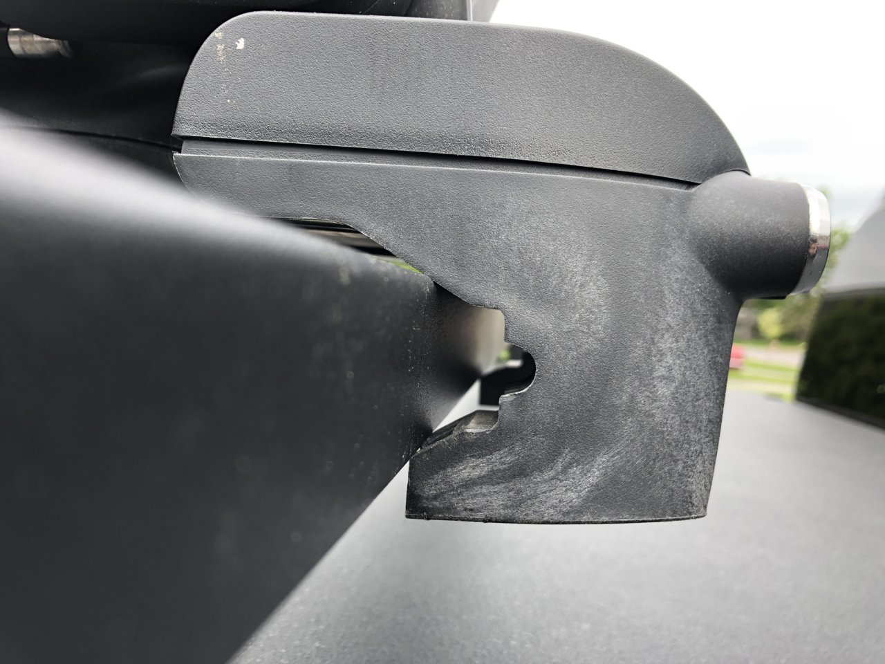

    Just some followup photos - the back clamp of the Yakima Frontloaders fit, but the front clamp is just missing grabbing proper. So close but so far, debating notching the plastic if possible - unlikely. I will probably need to install a cross bar 2" above and parallel to the existing Kb Voodoo bars.
    shakerhood likes this.

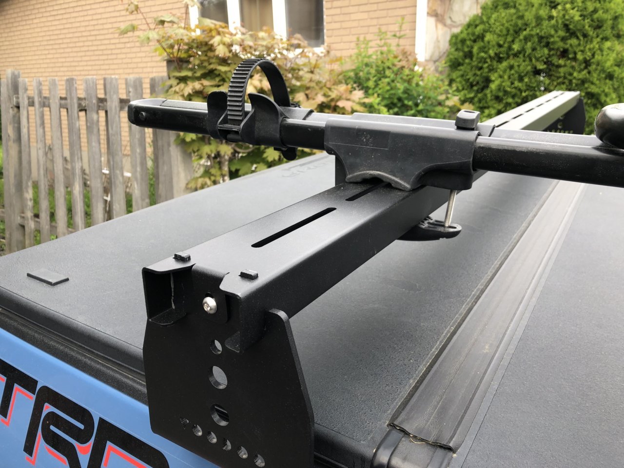

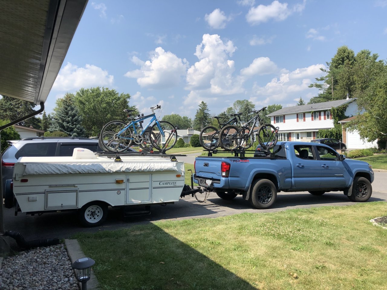

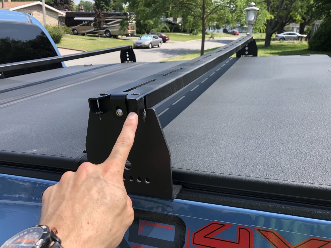

    Just to follow-up I went to a local metal shop and had replica cross bars made up with a depth of 1" which has allow me to mount a Thule roof box and Yakima Frontloaders. I even cleaned, primed and painted them, first truck project accomplished and pretty happy with how they turned out.
    shakerhood and paleh0rse like this.
