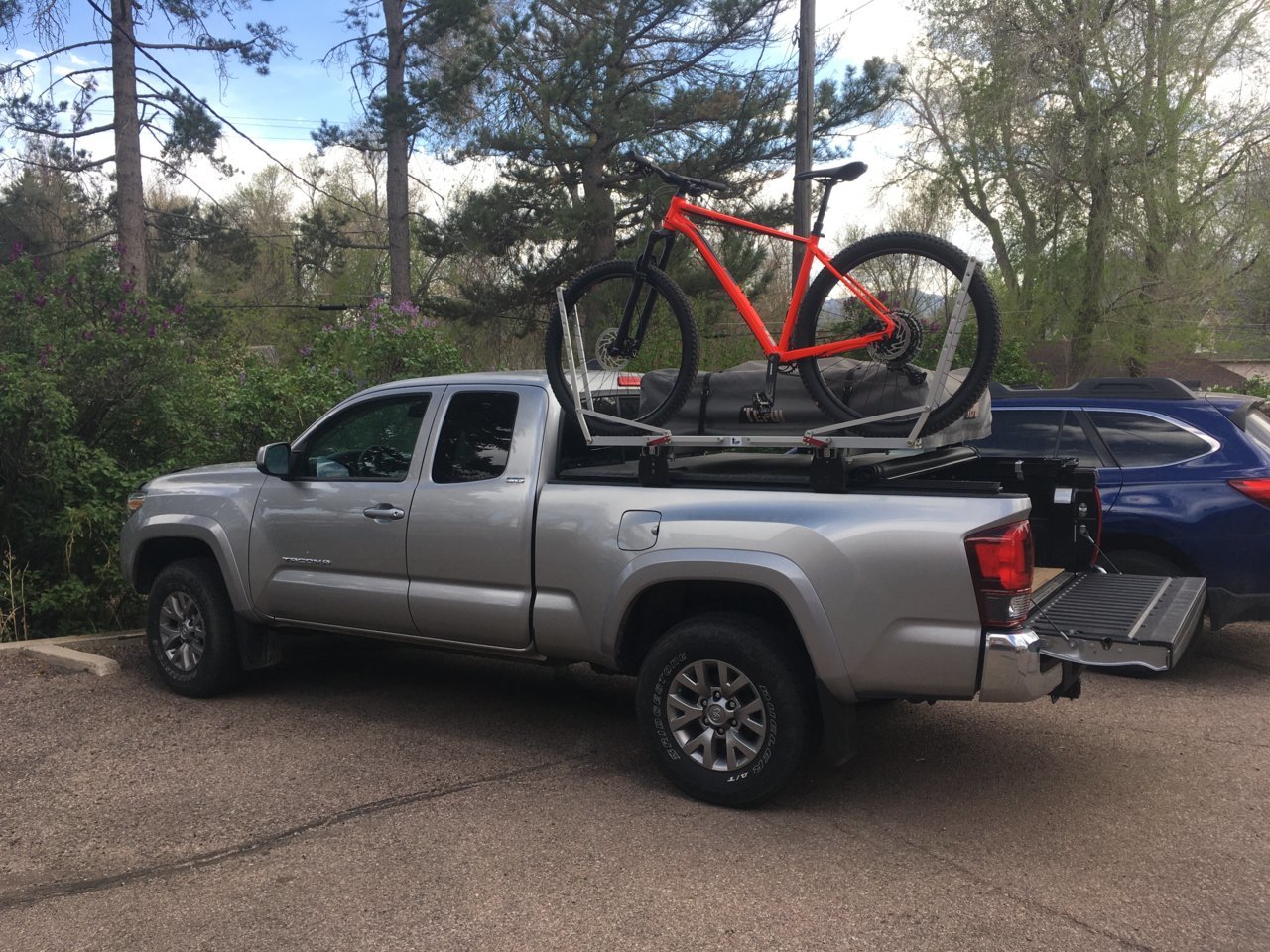

    While I fully intent to upgrade to the 1up tray for added strength and stability; I was able to find a Swagman upright roof rack on Amazon. It's cheap and you get what you pay for, but it fits the Voodoo bars and it's perfect for getting a bike around town. I've driven on the highway and its stable. I added an extra tie down from the frame to the Voodoo bars for extra security.IMG-1607.jpg IMG-1608.jpg IMG-1609.jpg IMG-1606 (1).jpg

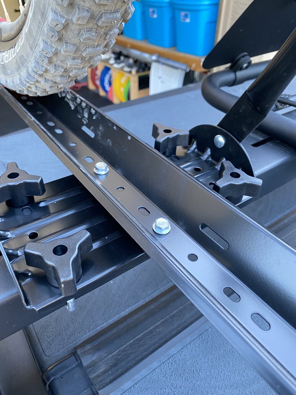

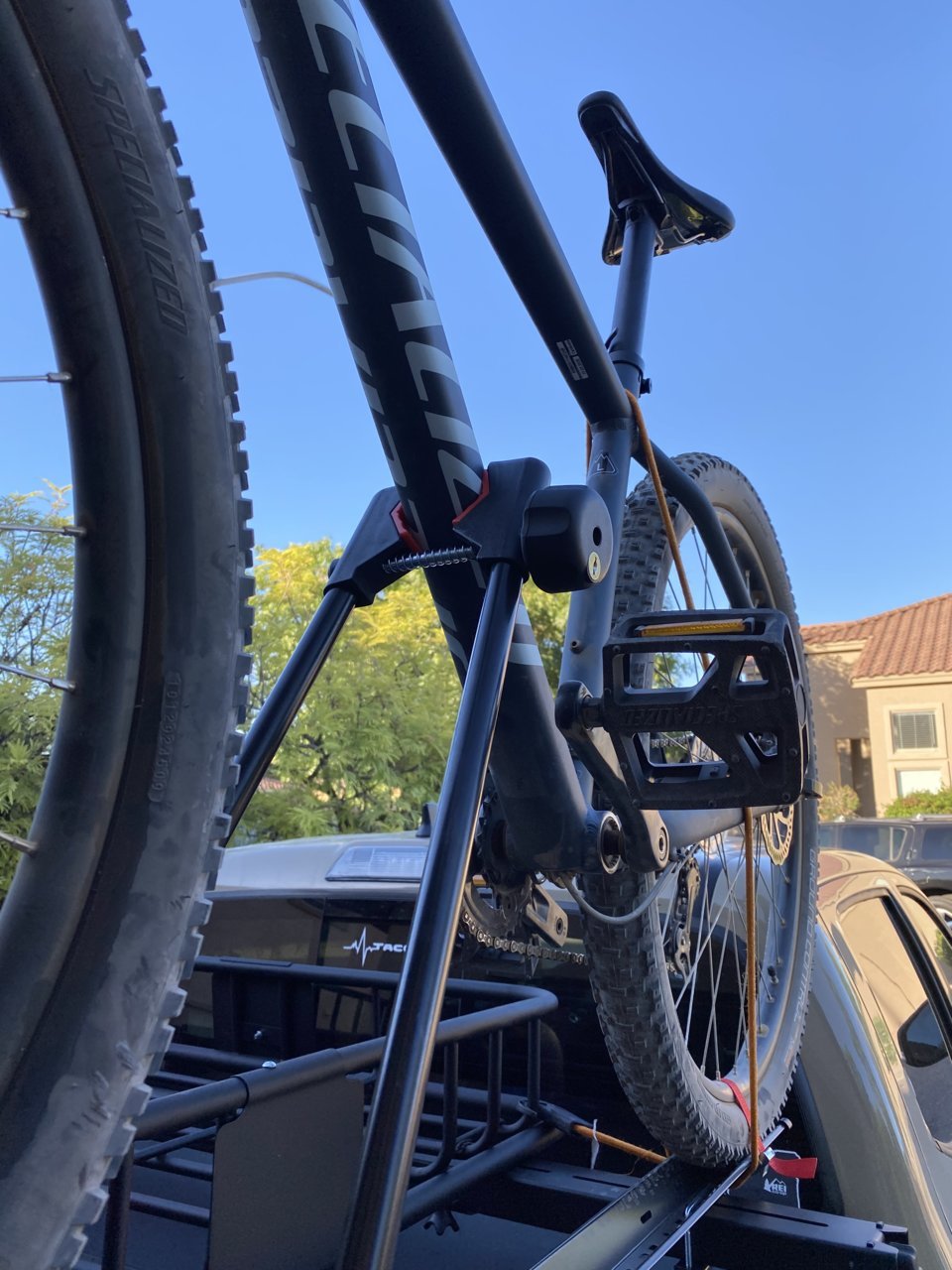

    So I just purchased the 1up rack with the KB Voodoo bars and realized when I got it that the flush mount will not work with the Voodoo bars. The diameter of the barrel nut for the T slot is larger than the width of the opening in the bar. Has anyone else swapped hardware to keep the flush mount without having the run the bracket beneath the Voodoo bar?

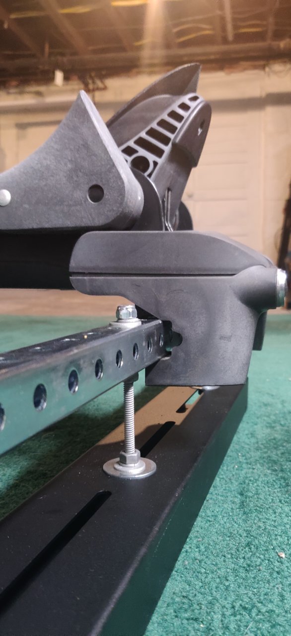

    I've been lurking here and ended up ordering the Hi Rise bars after even seeing a comment from kb voodoo that the Yakima frontloader racks work with their bars, perhaps they meant some old version of the bars? I'm tapped out and don't want to spend more money on other bike carriers right now, so I figured I would give this a shot. After years of square and aero Thule bars on cars, this rack seems great for making accessories at the hardware store.
    I just got the bars today and played around with this idea. This is 1" square tubing, but 3/4" will probably be a better fit. I can't seem to find 3/4" perforated tube, so I might just drill holes in non perforated tube which is easier to find, and use shorter bolts to lower the tube and bike rack closer to the Hi Rise bars. Maybe the shorter bolt will mean more strength on a bumpy road with a wobbly bike? I don't do any metal work or anything, but I've pushed limits of rooftop accessories and weight limits and this looks trustworthy to me. I'll post an update when it's done and mounted.

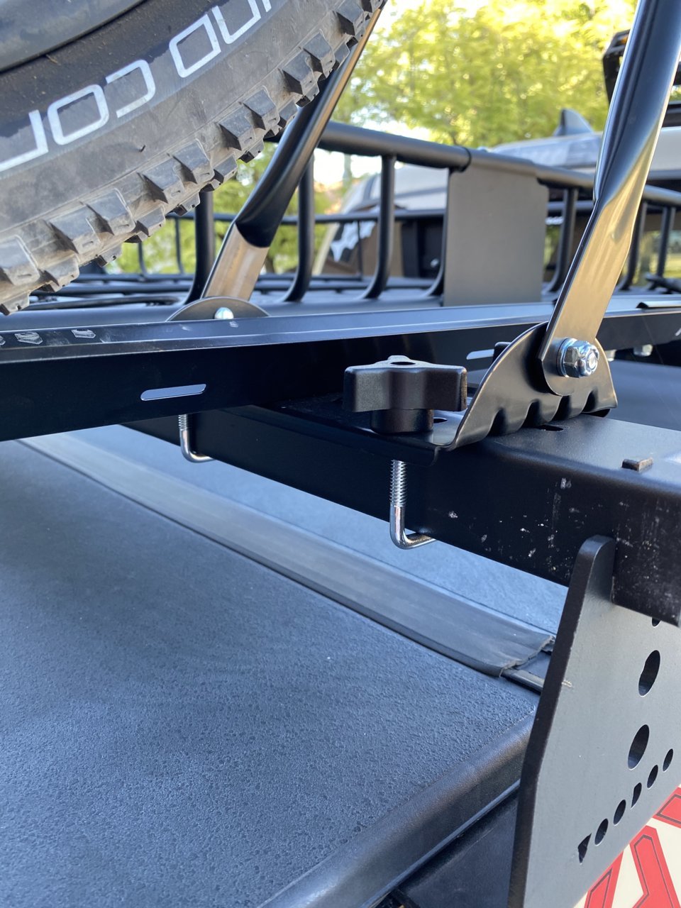

    1. Not sure I understand the question. The bolts on the 1up slide in a track, so you could shift it towards the back if mounting to short bed so you have enough clearance for front arm.
    2. Yes it’s flexible since bolts slide into a track on the bottom. They have install instructions you can go view on their website that shows this clearly.

    I love the 1up rack with my kbvoodoo bars. In fact I have a 2nd rack coming in this week, so I’ll have one mounted on each side of my tepui. I think the the 1up rack is the best option for a bike rack for mounting to kbvoodoo cross bars - IMHO.

    2" bolt size.

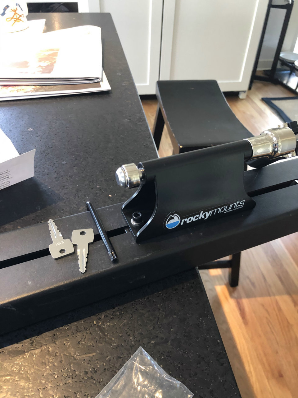

    Hi all - decided to go with a different option. I ordered a rocky mounts loball fork from REI and a rear tire tray from KB Voodoo. I'll send a pic when it gets warm enough to load my bike, but here is the fork mount!
    This seems to be a more affordable option that allows more flexibility when taking down the bars.

    I actually started with that setup; not a bad option. What did you pay total for the loball and rear tire tray?
    My opinions based on MY experience and use-case...
    Pros to the loball/tray setup:
    - cost; its a little cheaper
    - if you decide to part ways with the cross bars, or simply remove them, you could mount the loball to the bed rail tracks
    Cons to that setup (compared to a 1up rack on cross bars):
    - tire removal necessary to mount your bike (I love not having to remove my tires)
    - your locked into forks that fit into that specific mount (With my 1up I can carry my mountain bike, my road bike, or my fixy bike all in the same rack)
    - my rtt can open and lay over my 1up rack when its folded down; the loball wouldn't allow that
    I think both setups would require the removal of 4 bolts total - so I don't see any advantage one over the other in terms of "ease of removal."
