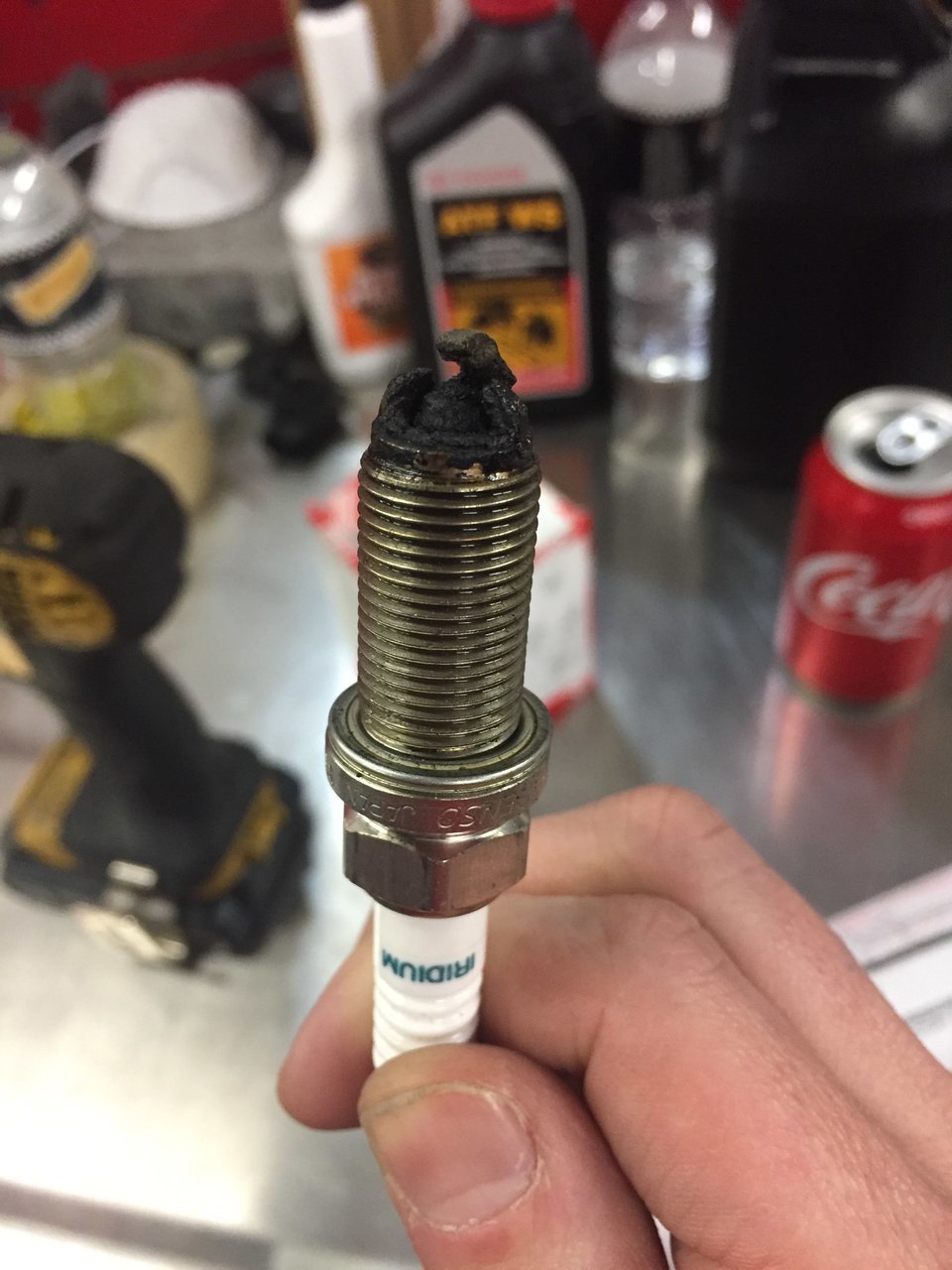

    Finally threw a (real) code and kept running into limp mode - at high ish (think onramp, not racing) load I get a P301 cylinder 1 misfire. Tech pulled it and spark plug in cyl 1 is fouled, took it in on Sat. Waiting on parts/Toyota to determine action.

    A truck with only 44K on the clock shouldn't have spark plugs like this. IMO, Toyota likely should be installing a new engine.

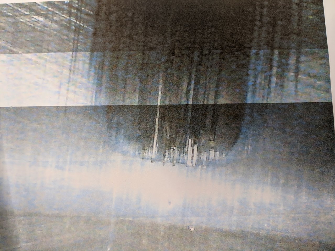

    As suspected, scratched #1 cylinder spotted via their borescope. Longblock and other parts on order, eta next week. I'll try to coax out some pictures from their tech.

    Damn! Any hypothesis as to why?

    Borescope

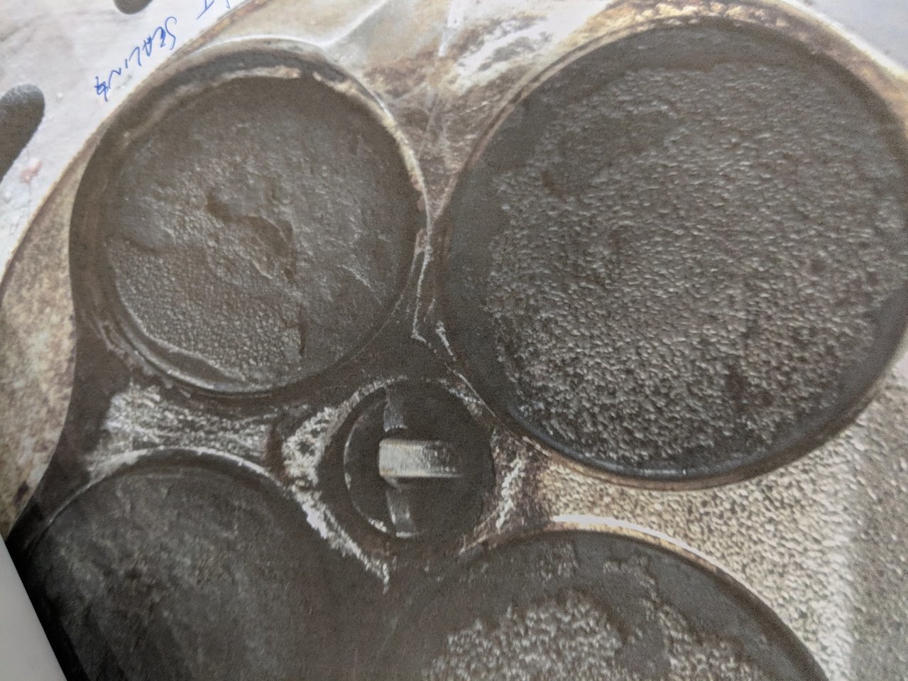

    Cylinder Head

    I guess, like the OP, it was just scratched at the factory. Oh well, hand assembled rebuild engine at 45k mi.
    Since it's basically a new block, new cylinder, and replacement bits. Oh, and exhaust system test to make sure all that oil isn't contaminating it.

    It would be neat to know where in the cylinder wall that scoring occurred at.

    Thrust surface. 100%

    Major thrust side on the power stroke?

    On the 2 stroke. :laugh: Good point though.
