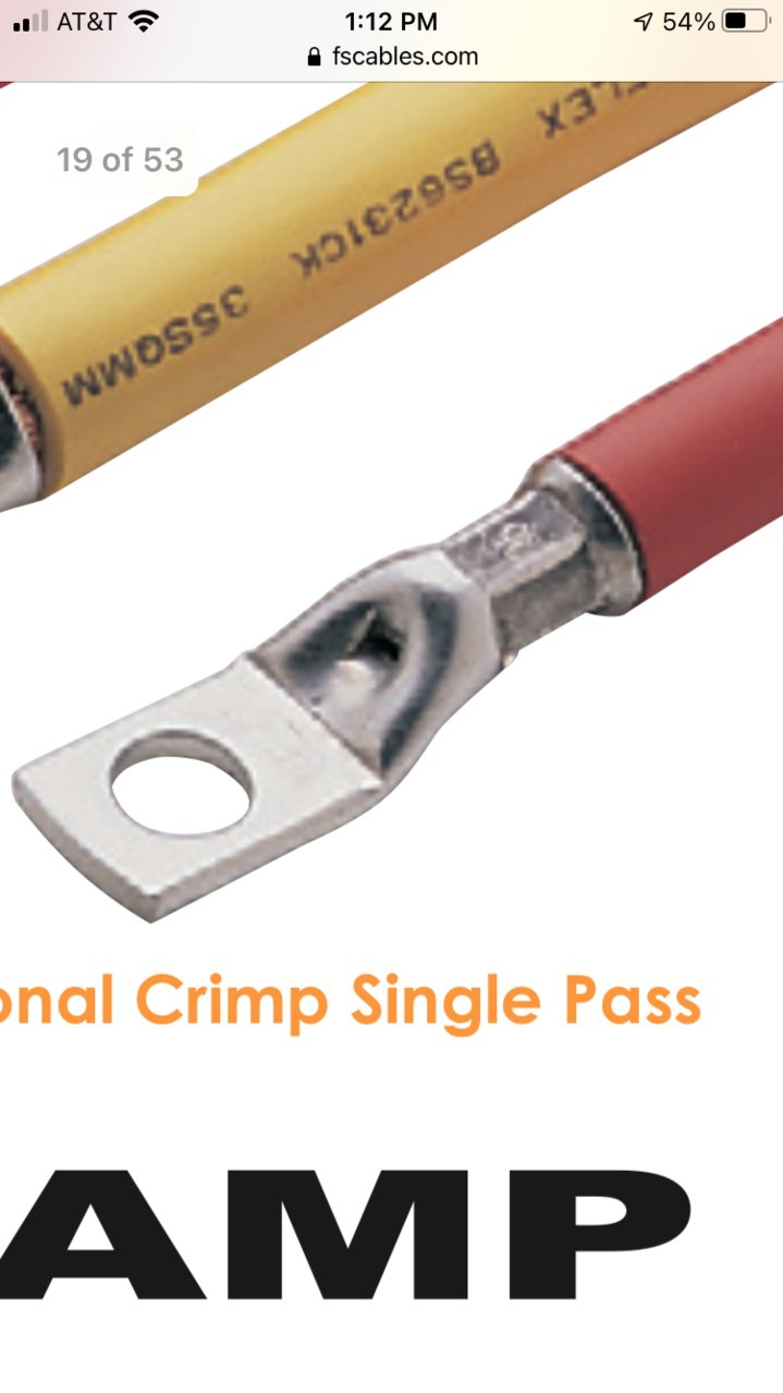

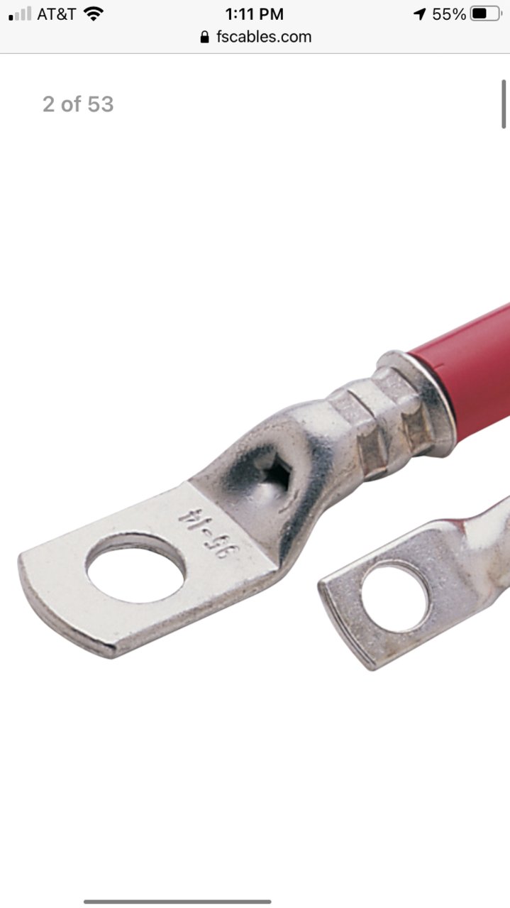

    Theoretically this is how a hex crimp would be made (double pass and single pass) using the correct lug and die for the wire size and lug. The previous photos either look to be too tightly crimped maybe using a ring terminal/lug that was slightly too large having to compress it more which could also damage the copper wire inside the lug.

    Have a pics of what you are referring to? I'd like to see someone cutting into wires while routing. Or maybe show an example of this contacting things it shouldn't.. in the engine bays they were designed for.
    I feel what your saying but not sold on it or concerned in the kit I bought.
