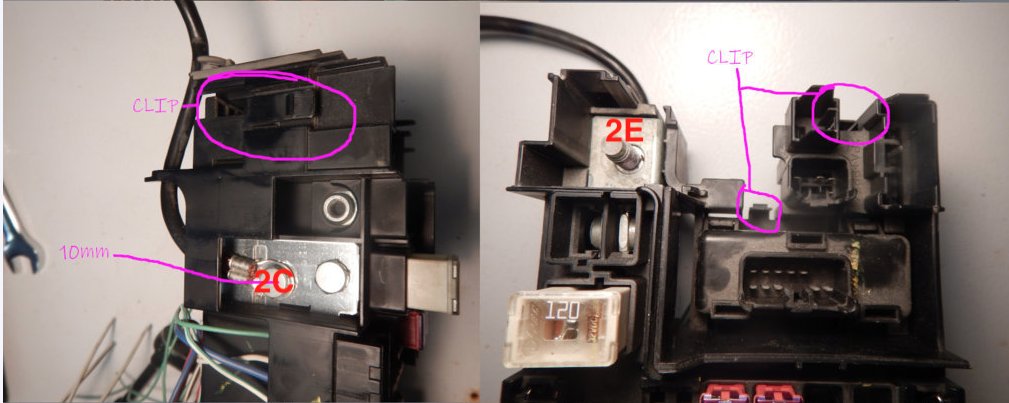

    Screen Shot 2021-12-15 at 10.24.43.jpg Problems solved.
    Install notes:
    You need a 10mm, 12 mm, a knife, some flush cuts or dykes, some zip ties.
    The ordnance terminals are SAE, I'll update the sizes when I get outside again.
    Opening the fuse box, you'll want a small Ti pry bar such as https://countycomm.com/products/nortons-u-c-s-universal-cleaning-stick
    Opening the fuse box guide:
    1GR-FE Wiring Overhaul - Big 3, headlights, hood lights, aux panel, and more.
    The panel itself kinda stays stationary or comes upward, the box portions with legs slide downward when unclipped. It takes a shear up/down force (you'll kinda see this) and you'll get it to separate. Knuckle Buster warning.
    2C, the battery to PDC, is the 10mm bolt you need to gut the box to get to and gets the 4ga red wire.
    2E, the alternator to PDC, is the 12mm stud you can see with the fuse box cover removed. Gets the 1/0 red wire with bent lug.
    I wound up pulling the plastic cable guide box, and the bracketry. I doubt it will be reinstalled in favor of the stock and some extra split loom and zip ties. It cleaned up the driver side as well.
