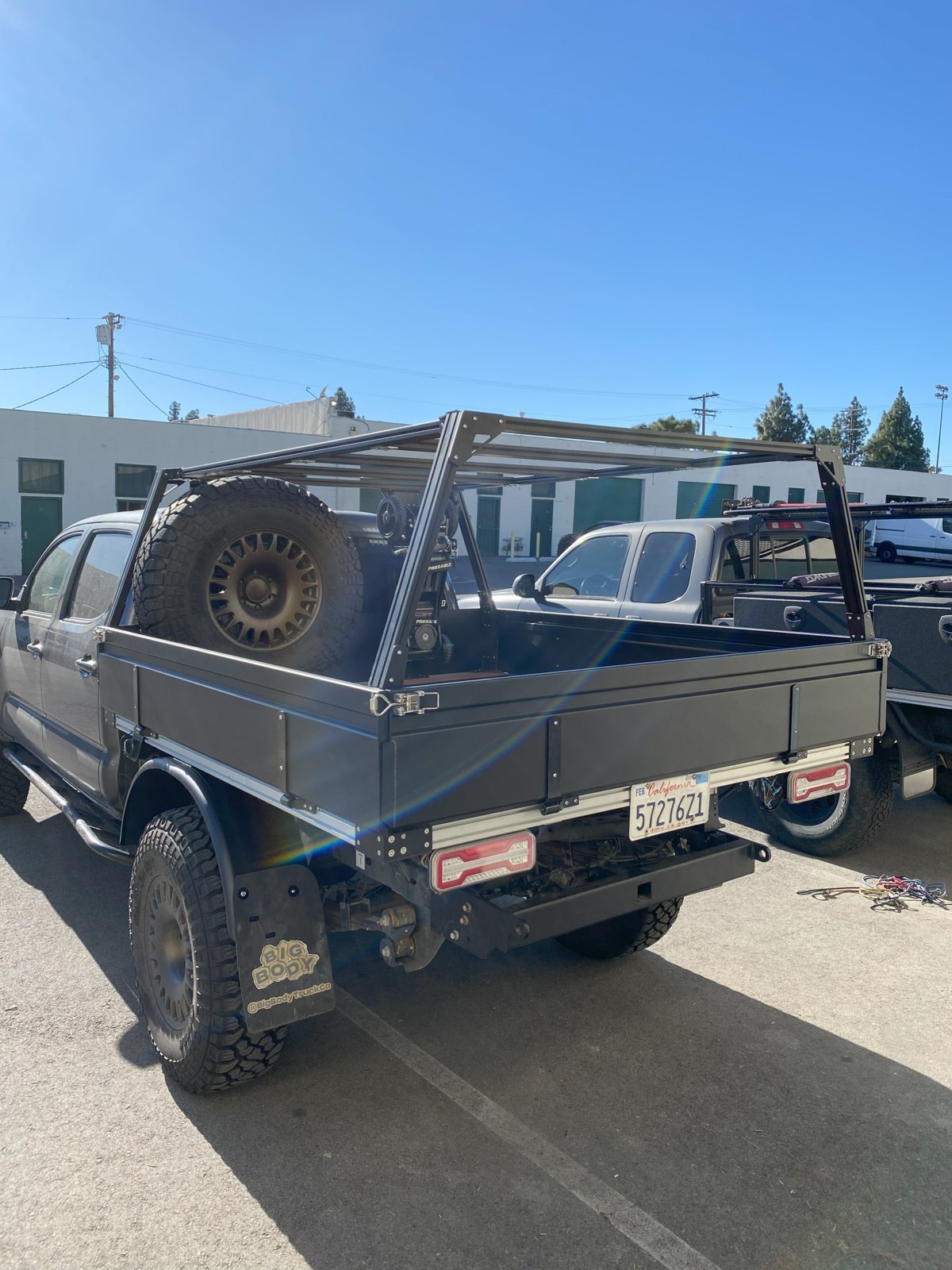

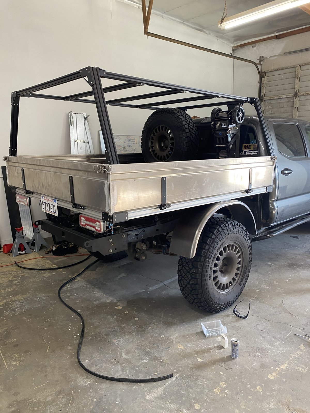

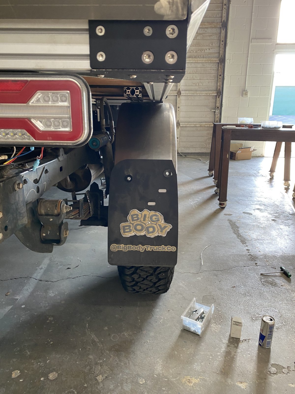

    Here is a little sneak peak of the fender flares and doors prior to powdercoat:
    • Doors are 8ga aluminum
    • Fender Flares are steel double wides, chopped down and spliced back together into a single with a double radius and a very very small flat section. Straight from Amazon. There is a single wide on Amazon that is perfect for 33s but not perfect for 35s. I used them on the first prototype and had to chop them down and stomp on em pretty good to get them to stuff right

    perfect man, you've solved the fender problem... as long as the bed sticks out as far as the tires do.

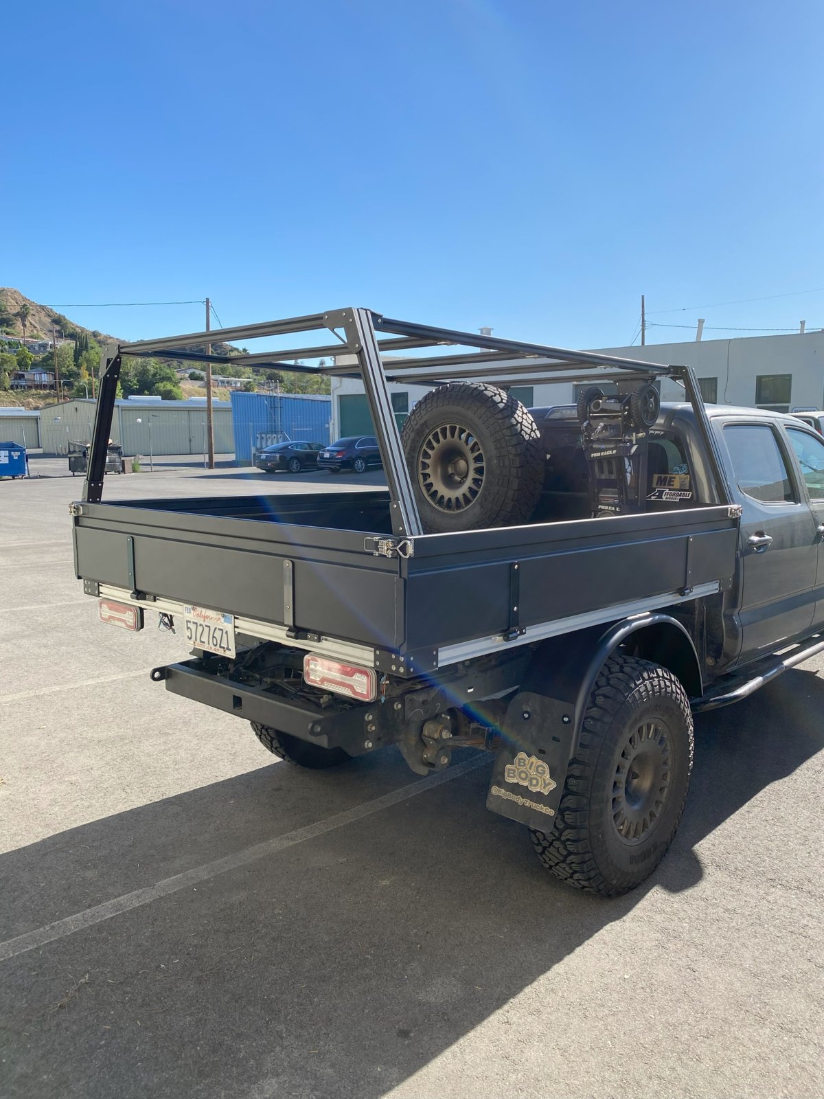

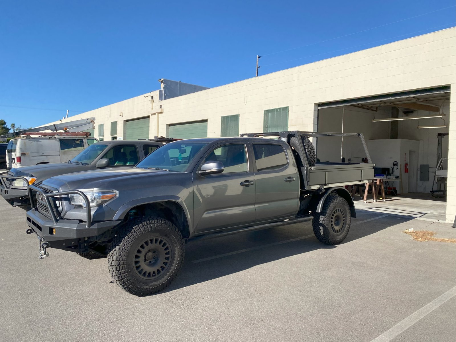

    Right now these stick out about 2" from the bed. I have always wanted to strike the balance of not too wide lookin in the rearview but not too much stickout of the fender flare. I think this is a great combo! The first prototype had a little over 3" of stickout on the fenders, its amazing what an inch can do visually.
    For reference I am running a -10 offset wheel with 35"x10.5" tires
    Here are some down the line pics:

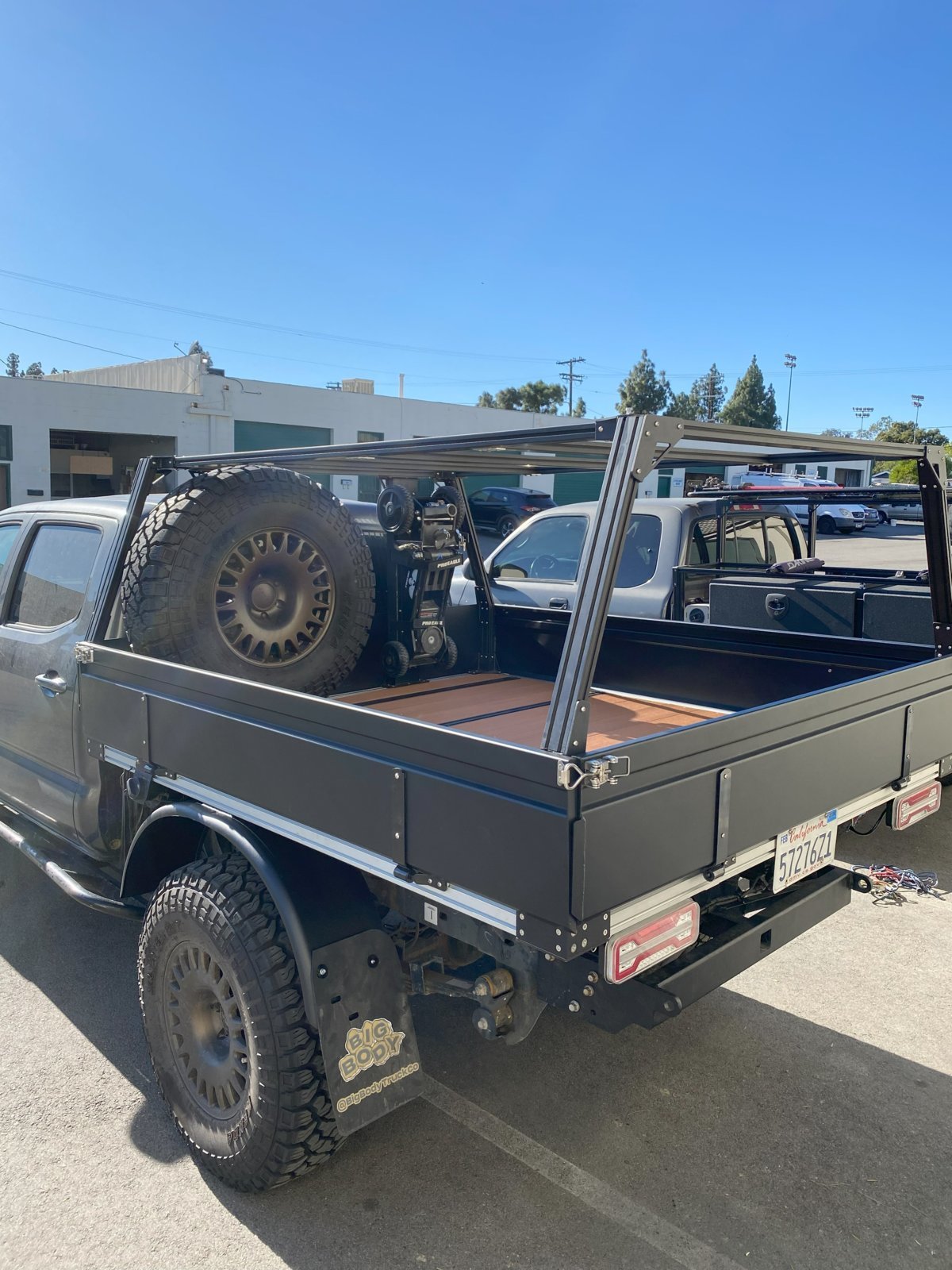

    Here is a tasty update with some photos of the powder coated doors and fenders with mud flaps! It is lookin real nice if I say so myself. Scroll to the end for a little extra eye candy :D

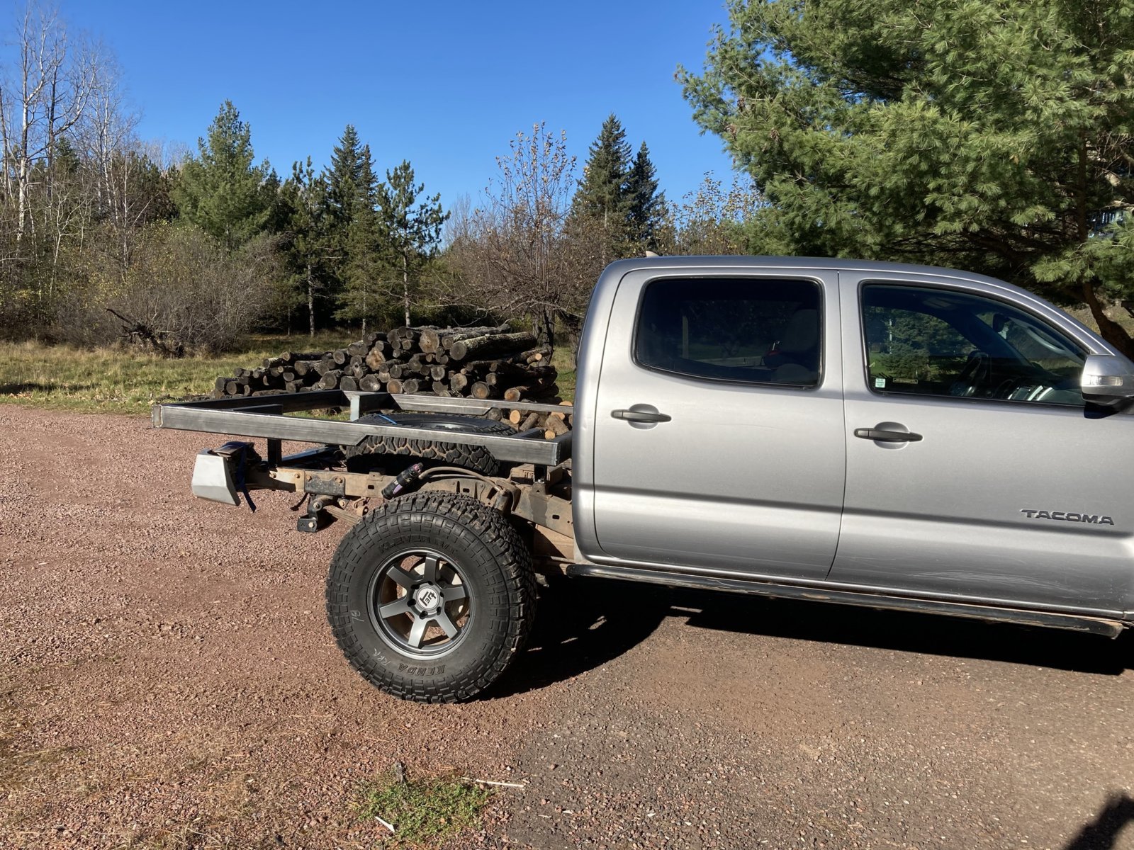

    Started my project. Going to take a few more weeks but I have a start and the spare is where I wanted it! Thanks for your help earlier this month.
