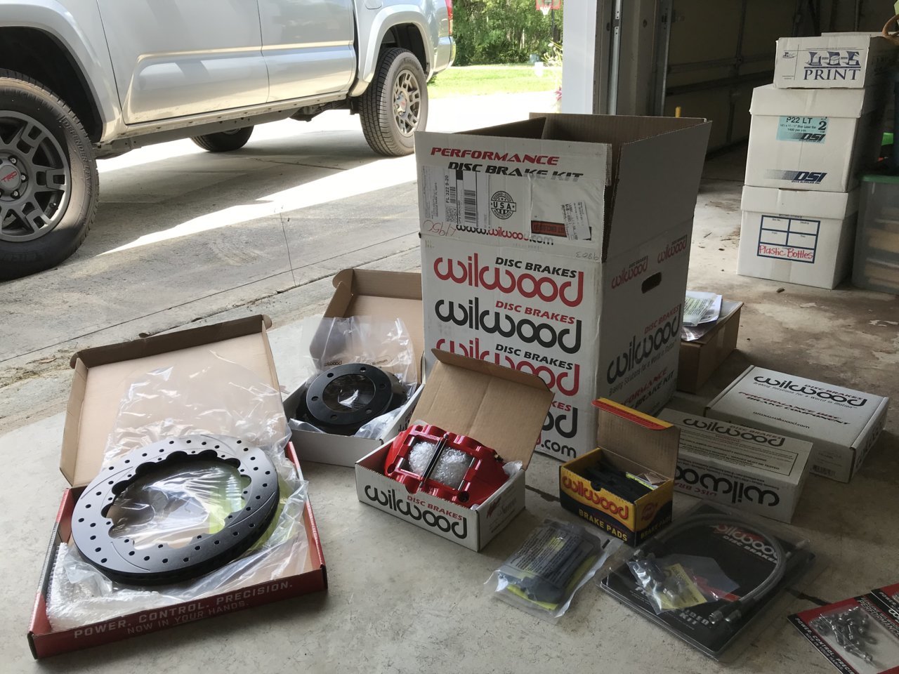

    Sorry, but I updated the results in the "what have you done to your 3rd gen today" thread. A copy and paste is below.
    Finally had a chance to properly bed in my brakes this morning. I installed the Wilwood big brake kit a few days ago but only drove it a couple of times under their strict guidlines since they were not bedded in which prevents vibrations and uneven wear. I got up around 430am this morning and was amazed at the number of cars on the road. The brakes were gradually warmed up from the 4-5 lights I had to stop at. Then I had to make 10 hard decelerations (ie. panic stops) from 60MPH down to 20MPH. I spent 20 years flying in the Navy and my body is a little more sensitive to the effects of g-forces on it than most people and it definitely felt like the stopping force was greater than the stock brakes. Also, I did not notice any brake fade on any of the panic stops.
    I went with the Wilwood BBK since they are American made by an American company and are just as good or better than Brembo brakes which is an Italian company. The forged aluminum parts used made a big difference in weight. The stock calipers felt like picking up a couple of dumbbells at the gym where the Wilwood calipers were light as a feather. I bought this kit for 3 reasons, safety, performance, and aesthetics. The investment made is definitely worth the money spent to me.
    Finally, I would like to leave you with a Pro tip. There are 28 bolts that need to be locked in with red Loctite. If you happen to put that tiny tube in your pocket when you are finished then please remember to take it out before you wash your shirt. Ask me how I know, never mind, just a rhetorical question.
    One thing more that I did not post in that thread is that the entire box that the Wilwood brake kit came in weighed 47 pounds while the Toyota stock brakes I took off weighed 73 pounds in the same box minus some of the packing materials so it may have been closer to 74 pounds. That means there is 26-27 pounds less unsprung weight with the new system. That is a huge difference. Hope this helps.
    https://www.tacomaworld.com/threads...ad-for-third-gens.525568/page-6#post-17656491
    https://www.tacomaworld.com/threads...-3rd-gen-today.399305/page-4272#post-17656423
    There are a lot more pictures on the links above but I thought I would put one picture here.
