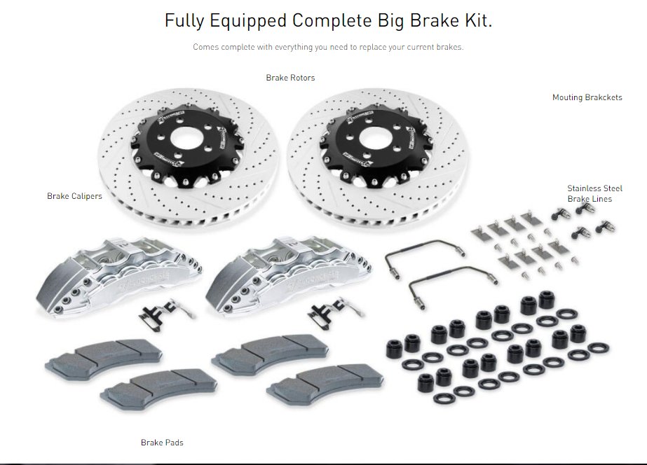

    So R1 does indeed offer a BBK for the Tacoma. Their kits will work from 05-2021. We offer this kit for many applications and it has been great. This kit offers incredible stopping power while being long lasting and low dust. These kits are fully customizable for colors of the calipers and top hats. These kits are also complete, they come with all needed parts for the install.
    Message me for more details and pricing
