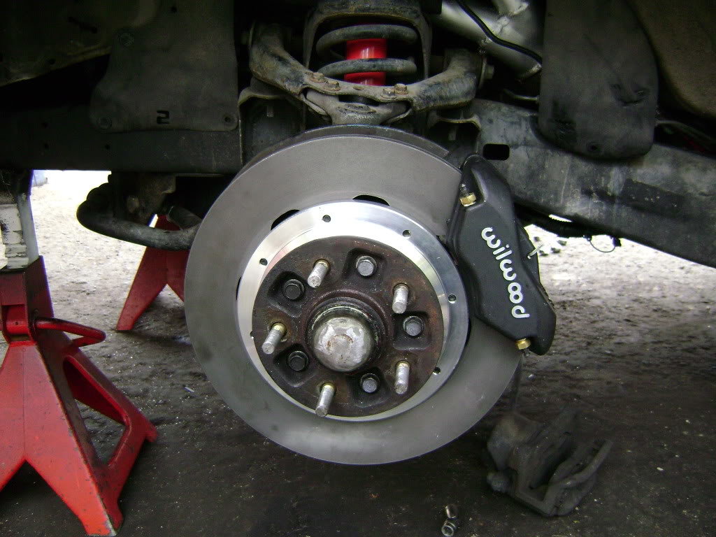

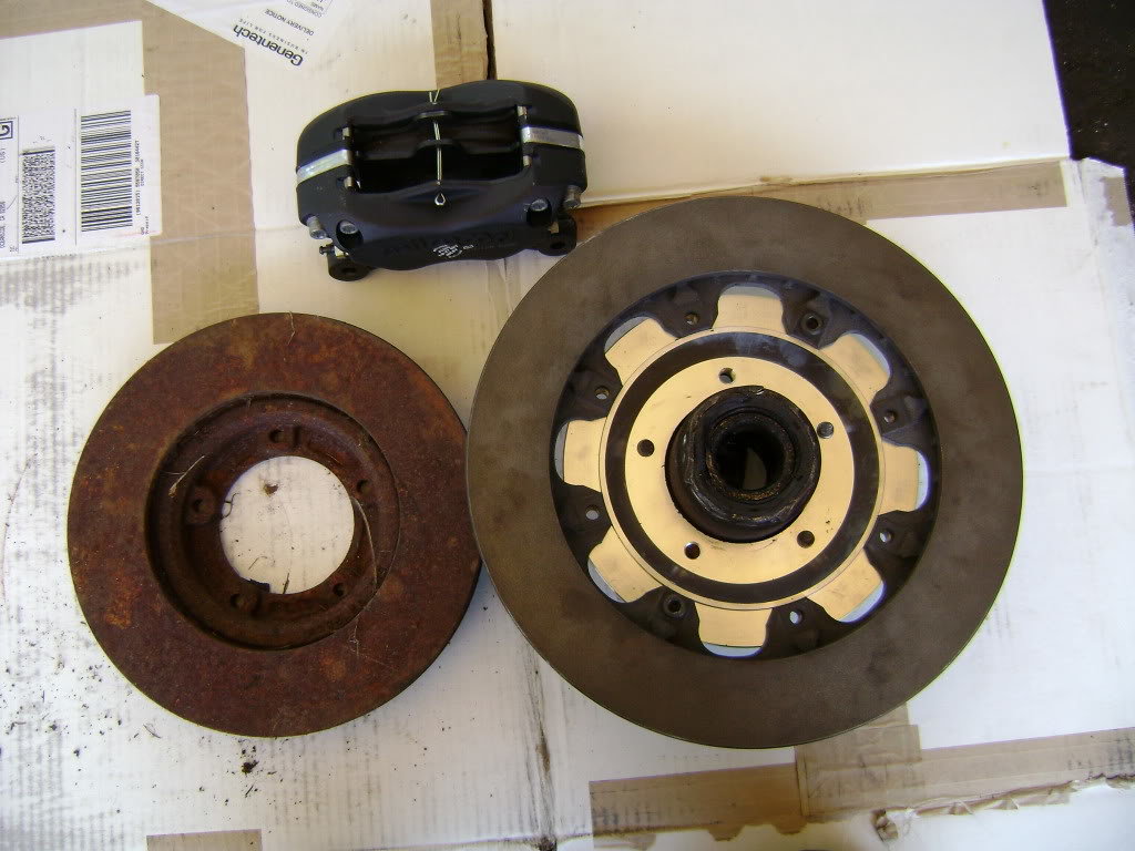

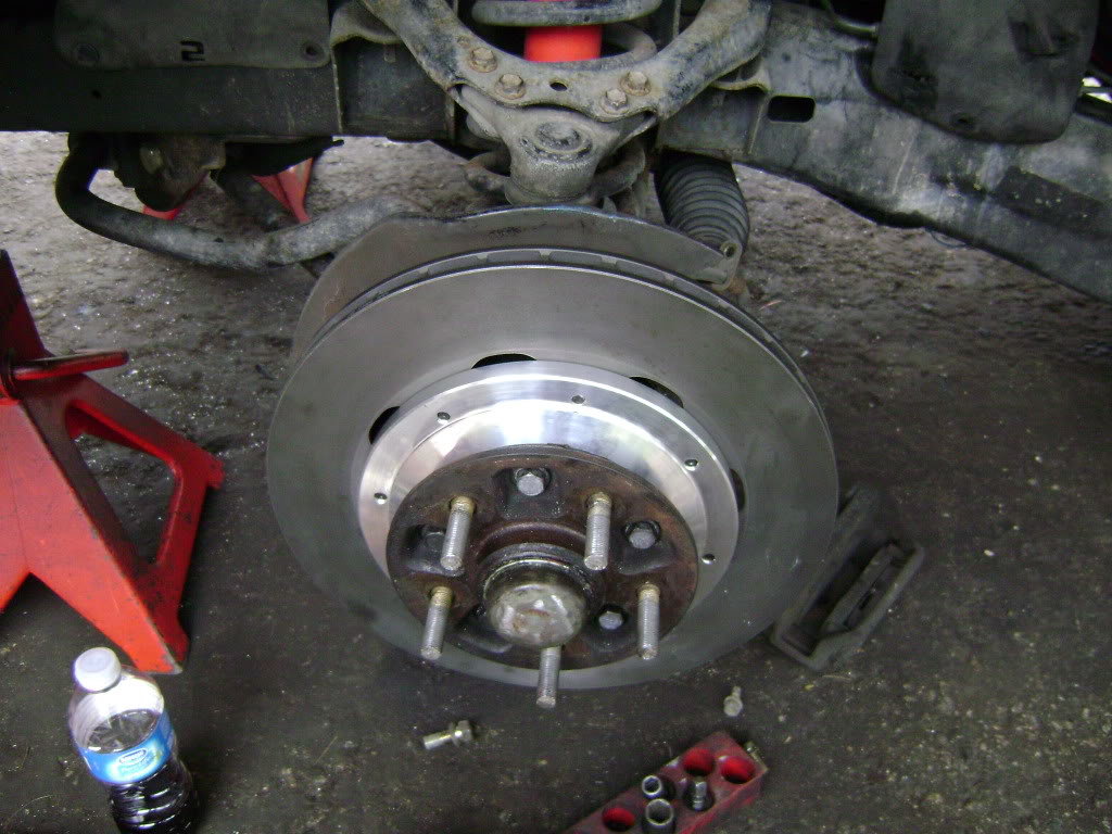

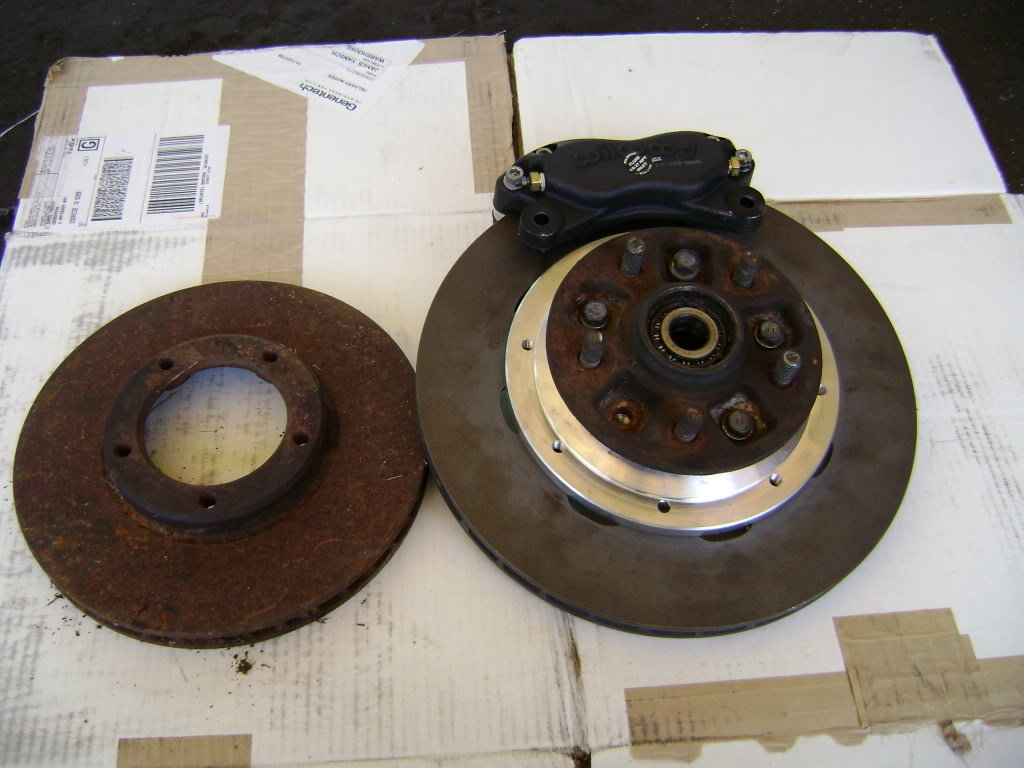

    Well I have been working on a brake kit for over a year trying and failing and have finally gotten somewhere just using aftermarket components...
    It will be using Willwood 12.2" rotors a custom machined hat, custom bracket, Willwood 4 piston calipers, now I had the 1st parts made one off and I just need to try and get this into production..
    I havent nailed down a cost until I get all my figures lined up, but I should have this for $1000 or less if I can find material that is affordable damn aluminum is expensive especially a big enough piece to make a hat from, needs to be 8" in diameter and 1" thick to start from and machine it from there..
    pics..comparing stock to my kit.

    Back to the thread, I got the brackets to fit, and going to refine them so the ones I have now arent the ones being used for production, I will take some pics later of everything put together on a jig...

    Pics on the truck, waiting for custom lines to be made, go get them later this afternoon and should be ready for a shakedown!!
