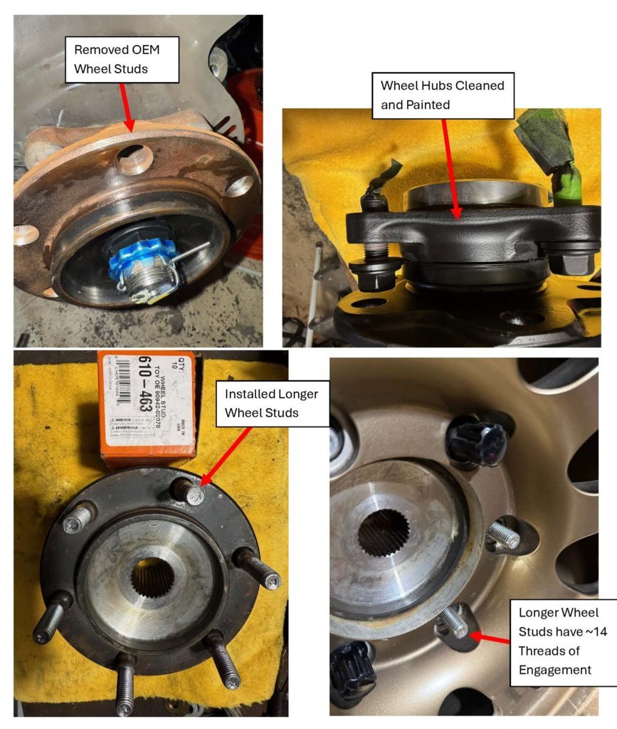

    Longer Wheel Studs:

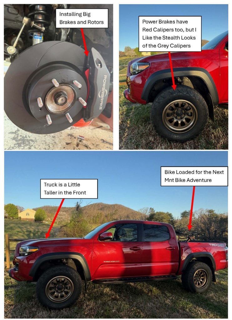

    Power Brake Big Brake Kit:
    • Great vendor, excellent customer service.
    • This kit is top notch stuff.
    • Not the cheapest option, but worth the price difference.
    • Much better feel when stepping on the brake pedal.
    A couple of progress photos:
    Big Brakes Installed:

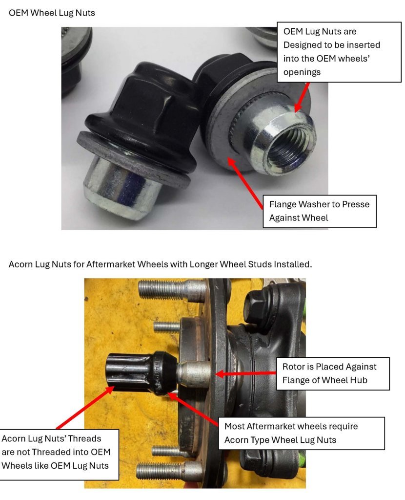

    The differences between OEM lug nuts that mount to OEM mag rims is shown below:
    Before the big brake kit and longer wheel studs, there was about five threads of engagement for the front wheels.
    Factoring in that Power Brakes have about ~1.25 mm thicker rotors at the flange to wheel bearing housing, there would only be about 4 threads of engagement w/o longer wheel studs.
    According to the DOT, it is recommended vehicles with aluminum wheels have at least 4 threads of engagement.
    Another DOT recommendation is the minimum acceptable lug thread engagement should be >/= the stud diameter for on road use.
    Given that the wheel studs are 12mm x 1.5 mm pitch, eight threads are needed to meet that DOT recommendation. (i.e., 8x1.5 = 12mm)
    Though eight threads are recommended, back when NASCAR had steel wheels, only three threads of engagement were needed.
    Since I was removing the front wheel hubs to cutdown the dust shields, thought it would be a good time to install the longer wheel studs.
    Just a piece of mind thing as I would hate anything to happen just because I didn't do this simple modification.
