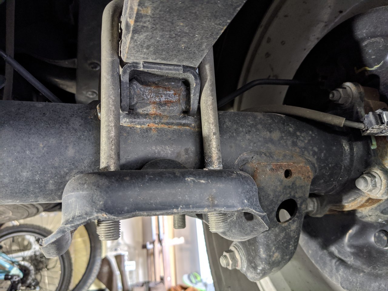

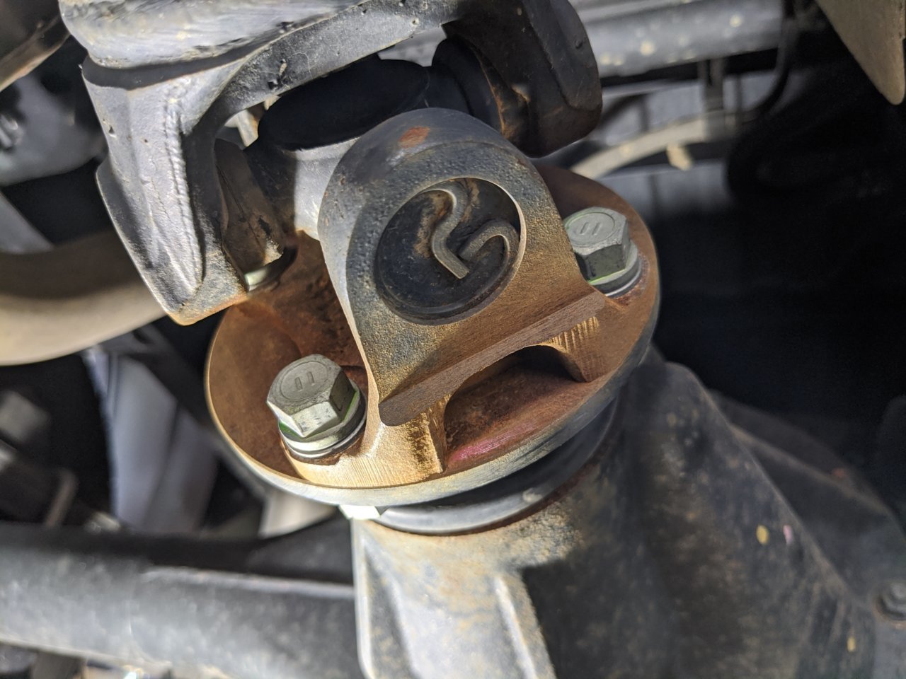

    So rust around the frame like this we should hit with some rust converter/encapsulator:
    whereas surface rust on exposed steel can be left alone?

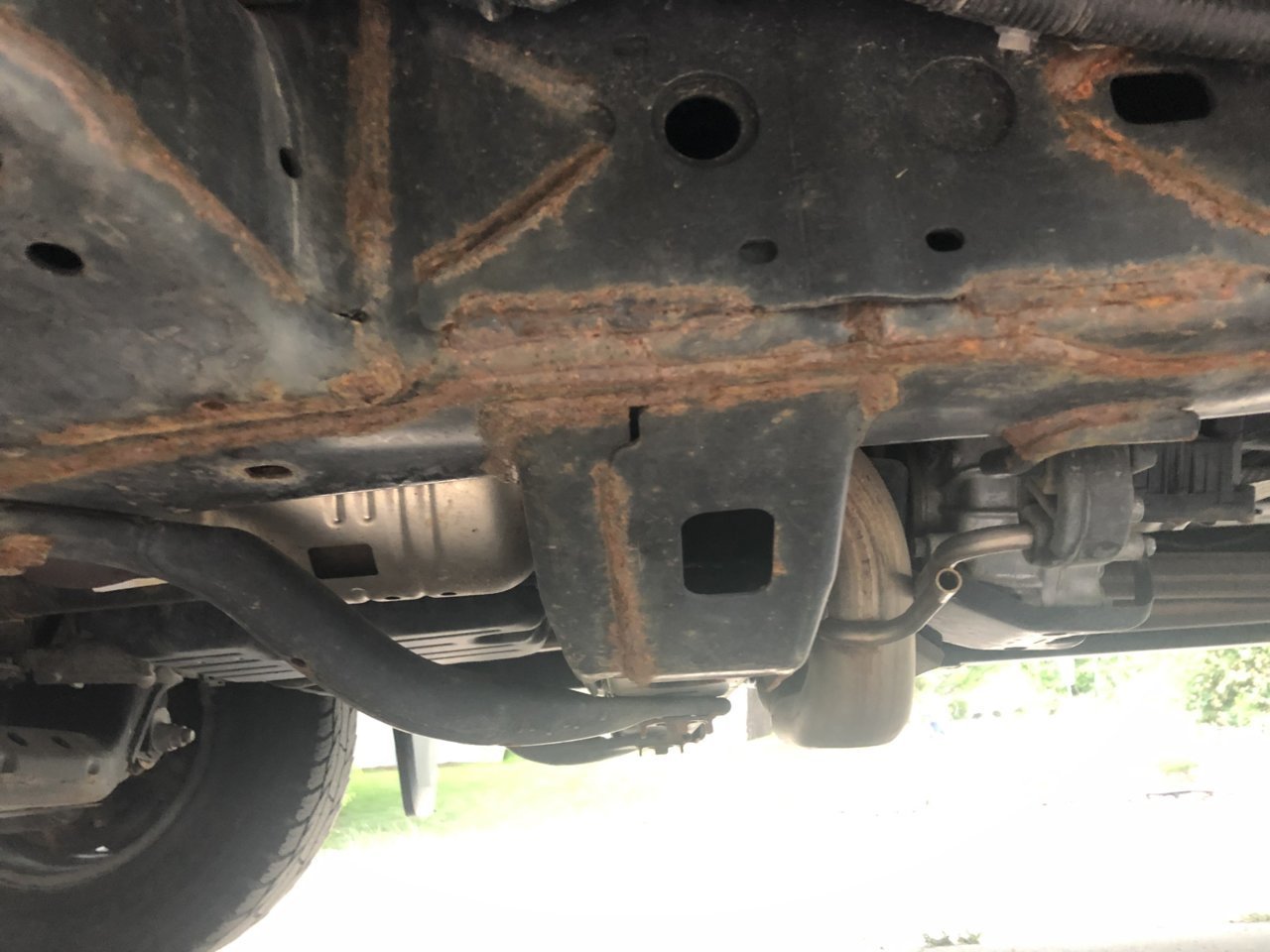

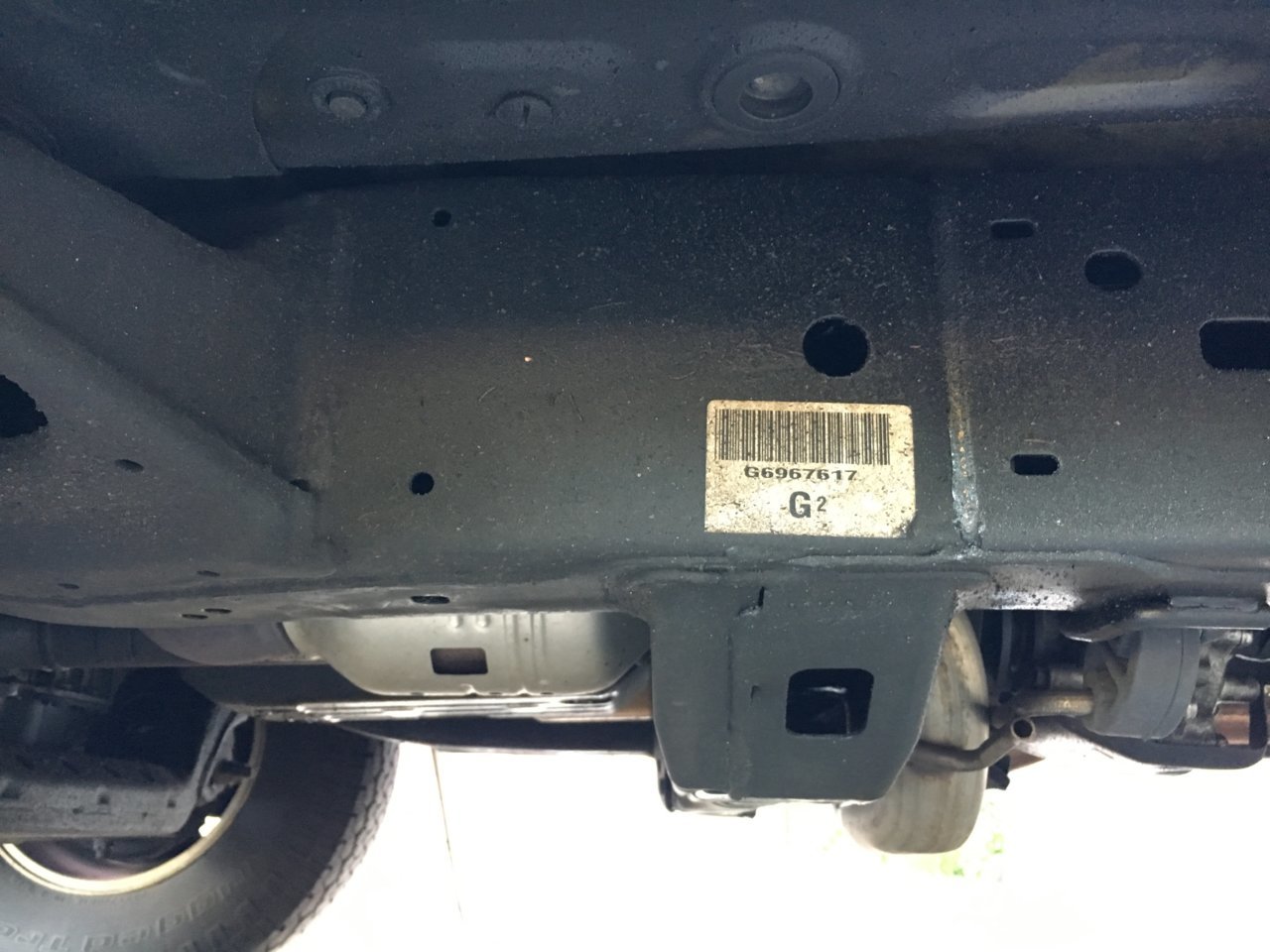

    Fluid Film is THE trick. My 2015 Taco lives outside in New England 24/7. They salt the roads like it's going out of style around here. I nuked the underside of the truck with FF when it was brand new, and hit it again a year later. Since then it has developed a layer of FF grime on everything, which is good because it effectively seals off all the surfaces.
    The only downside to Fluid Film is that it makes for an unpleasant wrenching experience if/when you're under the truck doing maintenance or mods or what not. It gets all over you if you're not careful. But that is a small price to pay for not having any rust!
    Here's a pic of an untreated 2016 Taco frame:
    Here's a pic of my frame:

    Wow, my original '96 Tacoma frame looks MUCH BETTER than that '16.
