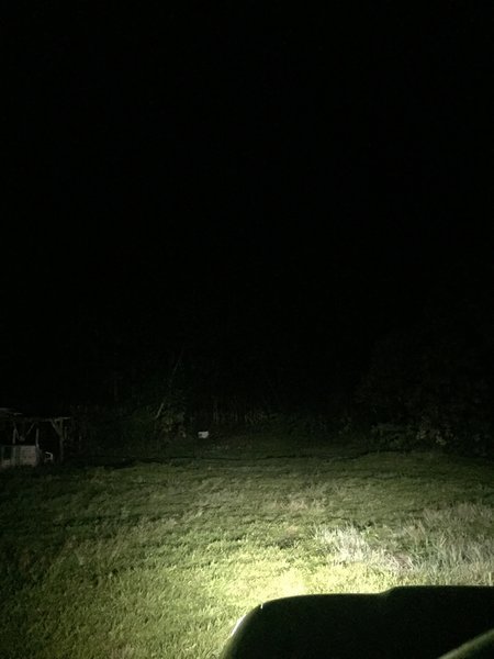

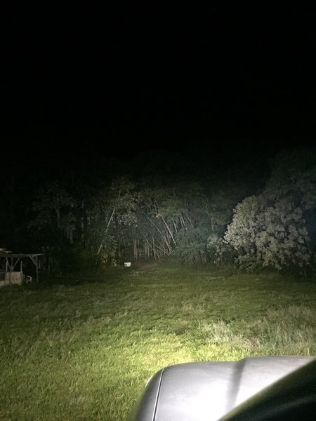

    Head lights

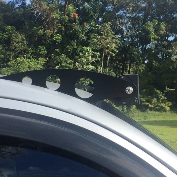

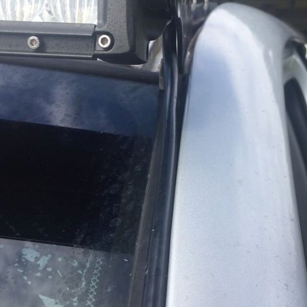

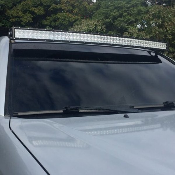

    Light bar

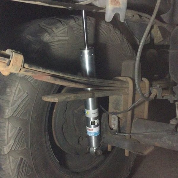

    Replaced the shot rear fabtech shocks with a pair of Billy's :D

    how come you removed the boot?

    Pops off when fully extended, tired of having to zip tie it:annoyed:

    Rajah, what set of Billy's are you installing?

    same as yours, the RCD 5100's (B110). I don't have as much rear lift as you though, I'm on Dakar's. I'm hoping that I won't have the issue of fully extending those shocks. lol. I currently have Icon's, and I think they're too short.

    Cherreh, yeah the B110's are cherreh, well anything will be better then shocks that are shot lol! I think the B110's top out at 30"-31" I think, I measured my fabs before swapping them out topped out at 28" and I was told I'll be able to go up 1"-2" more max with the B110's

    it's the Icon 56503's, and yeah, they will be for sale once I get these B110's on. I think the listed measurements are: 14.22" collapsed and 23.25" extended. parked and sitting on my level driveway, the shocks measure 21.25"... I believe this means I have about 2" of down travel left? the Dakar's gave me a pretty good rear lift, around 3.25", with a camper shell and full size match spare. I think those Icon's are rated for 0-2.5" lifts :bananadead:
    I think the B110's only go to just a hair over 27" fully extended, which is still pretty far.

    You're right my mistake yeah top out just over 27", but once I decide to go higher these will be useless, I might just do a shackle flip with 6" alcan's so i can delete the block

    I see. Yea, seems a little short. for that much lift in the rear I'd have gone for 10" stroke shocks, 9" seems to be a little close

    they state that the B110's will work great for the kit, but They do recomend bump stops for the compressed travel so you don't bottom out on the shock, it supposed to add 1" of lift in the rear and provide better articulation.
