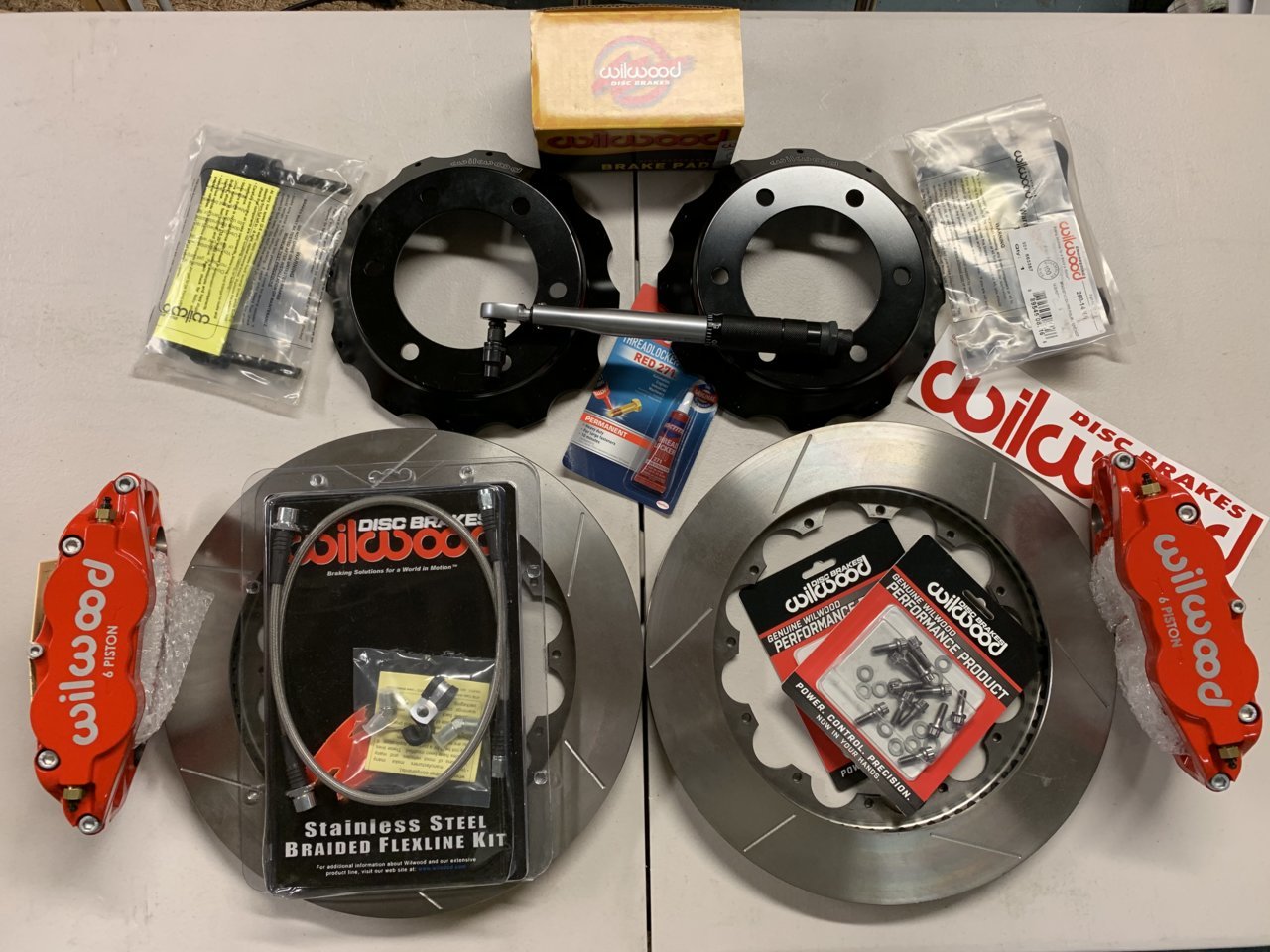

    What's in the box obvious edition:

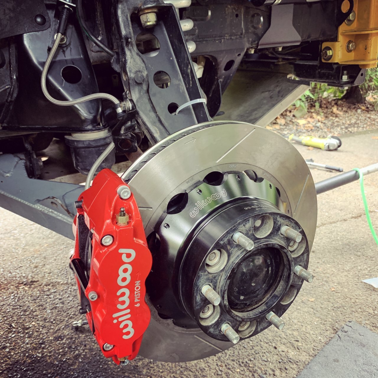

    Well. Not so bad a install. These 14” fit on 17” method mr701’s with and without 1.25” wheel spacers. I cannot speak to other 17’s.

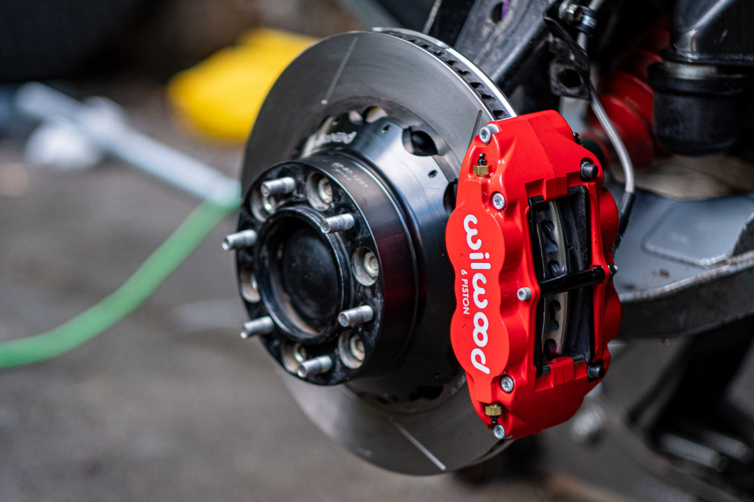

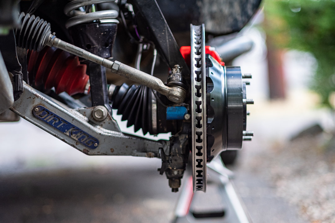

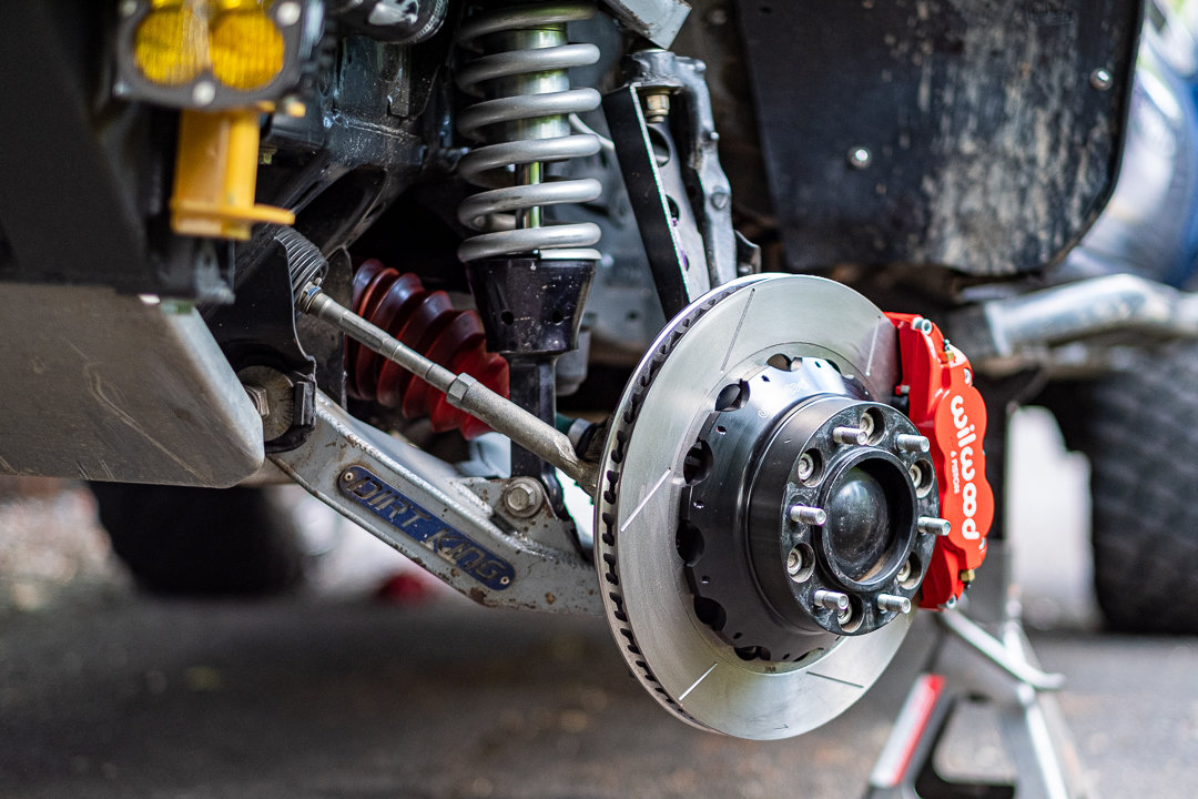

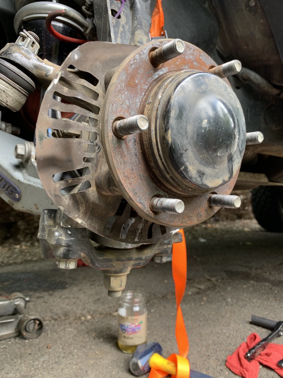

    Notes on install.
    The only sort of hard part was cutting the dust shield. I decided I could do the cut without removing the shield. I leaned on the passenger side and did a better job on driver (left more of the shield in place). One more go at it and it would be even better. You can leave a good portion of the shield in place if you want. I pained the cuts while on the truck just by masking behind the shield.
    I do not think is a good idea to remove the entire shield. It may seem thin but it would change it up a bit and when you are adding and removing the washer shims for the fine tuning of the caliper placement a very small amount matters..
    Note!! You will need a 1/4” line wrench to bleed the front breaks. You need to bleed both the top bleeders. The bottom ones are not used. You also need a few sae sockets and wrench's. I say this because you may not have them as everything else in a taco is metric.
    You will also need a full bottle of Break fluid when you bleed them. It simply takes time to hook up the break lines and you will loose a ton of fluid which means a full bleed job.
    ****I had to use all three of my torque wrench’s for this job 1/4 drive, 3/8 and 1/2. Going from 130 in/lbs up to 83 ft/lbs. 3 things to use it in. Mounting disk to hat 1/4 inch/pounds, main break bolts (1/2) and caliper bolts (3/8).
    I would say it’s a 6/10 difficulty
    The bedding process takes time. Give yourself 1.5 hours to do it. And you will experience all sorts of smells and sound when doing it, this is normal, I even had a real bad clunking sound but it went away as well. I think my driver side got some break fluid in the disk which was causing the pad to slip and re-engage. It sounded like I fooked it up some how.. I almost backed out but pushed thru it and now the breaks are great!!
    Hope this helps out if anyone tackles this job solo.

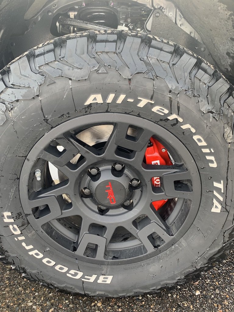

    Yes I believe that is the 701 I am running and the BBK fit! I would need to dig up the order to find the exact part number for the wheels. The wheels fit 315/70's but I run a spacer upfront at 1.25 to clear suspension components, not the breaks..

    The 17" rim kit (340mm rotors) fit on my SEMA 17" TRD Pro wheels just fine with no spacers. The Methods have a little more clearance it looks like, so if I upgrade to those I should be fine. These brakes are great if you have a fat taco like many of us here do.
