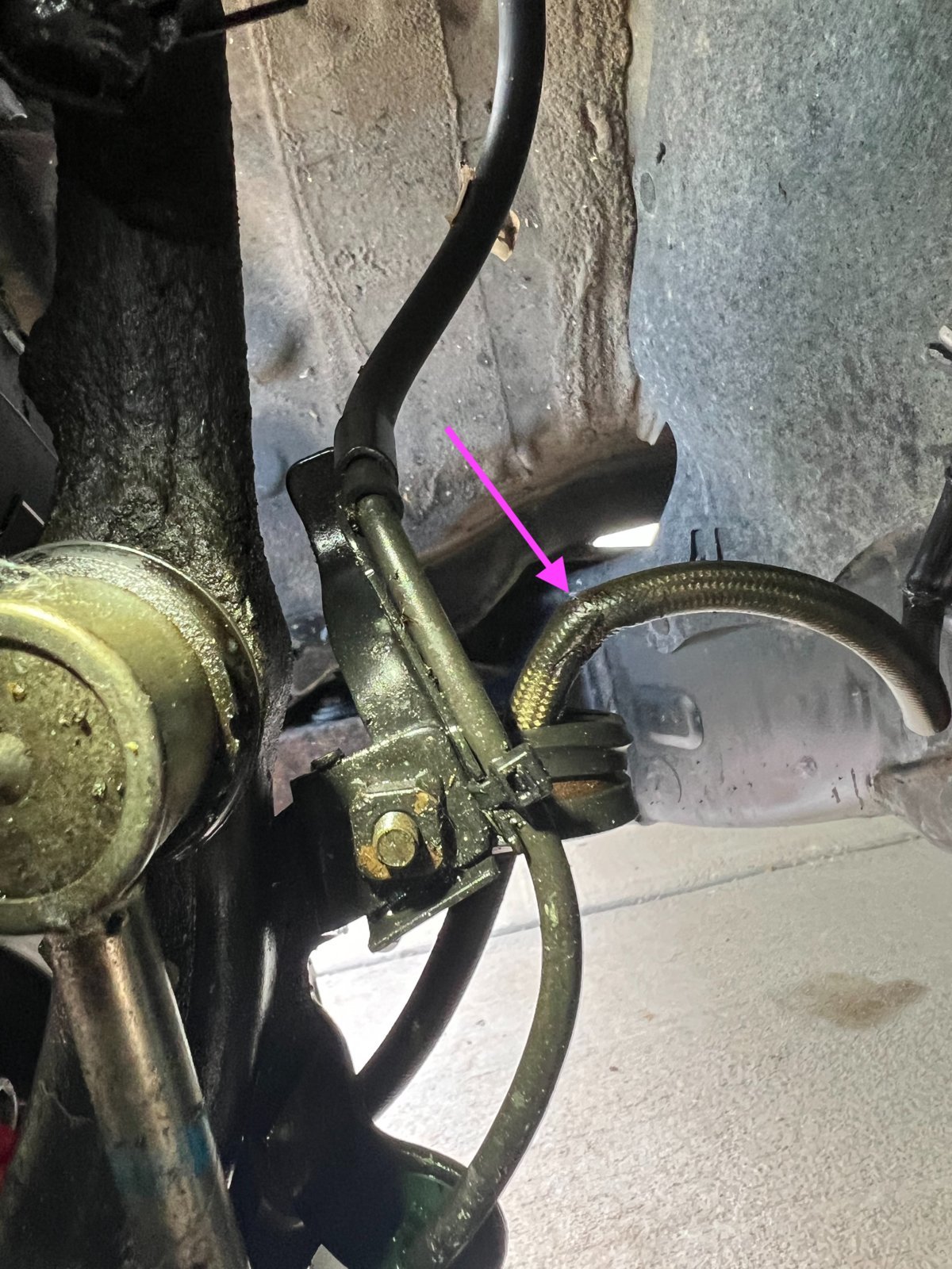

    It looks like it's hitting the section below it. These are Stoptech lines via SOS, but they are definitely concerning. I have Stoptech BBK front and rear along with lines. I make sure to get them a bit longer than normal to account for any pull.

    The rub on the ring below is definitely what caused the failure IMO. I just don't know if the same would have happened with OEM lines? Probably?
    I started with the extended lines for my first set. RSG here in town rerouted them when doing a front suspension upgrade. Then they caught on something while turning and snapped off. When RSG replaced them, they ordered the standard length lines per their recommendation. RSG also added the ring to hold the lines in place so they don't snag. Suffice to say I don't take my truck to RSG anymore.

    ok that makes sense yah RSG prob not the way to go. That's a good call. Yah def how they are routed is key. I had a line loosen as it was rubbing the shock. Since then SOS send me some shaved down ones for the brake lines.
    Are you running stock length or Long Travel setups?
    When I get home, I can snap a photo of how we ran my lines, but I believe it ran up the spindle rather than out like that. It looks like it stretched it against that deal they added, as you said.
    If you are concerned they are still not good you can look into some Goodridge lines which are pretty standard for good lines.

    Originally, the longer lines because the truck is lifted. But when RSG broke those while in their possession, they recommended the shorter ones saying they don't need the extra length. Then this shit happens because they're too short, and they routed them funny. So Tom at SOS was a good sport and sent me a new set of the longer ones today for free.
