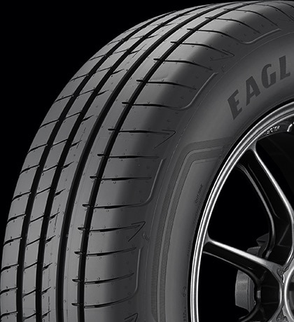

    I agree. I think the brakes are one of the strongest points of the Tacoma. Suitably beefy 4 piston fixed calipers up front where it matters- I'd rather have that and drum rears than some weak-kneed sliding calipers all around.
    I'm kinda curious why the Offroad/Pro vs SR5 comparisons are showing a shorter stopping distance for the Pro. I know they have the fancy electronic master cylinder because of crawl control, but in a dry test condition that shouldn't (at least as far as I know) make that pronounced of a difference. Perhaps the suspension and/or tires have something to do with it.
    Which brings me to another good point- if you want nasty 60-0 numbers, you don't want these:
    You want a tire that looks like this:
    Of course, I'd like to see someone try wheeling (or even a pretty tame dirt road) with the latter.:eek:
    Tires are the ultimate arbiter of brake performance, because that's actually your interface with the road!
    Well that depends on your goal, I guarantee you a skilled driver could put down a better track time with VSC off because VSC is programmed to be very conservative in terms of grip limits.
    However if your metric is "average driver trying to avoid clipping that Prius that just panic stopped because of a deer on a slippery road" then yes, VSC will reign supreme.
