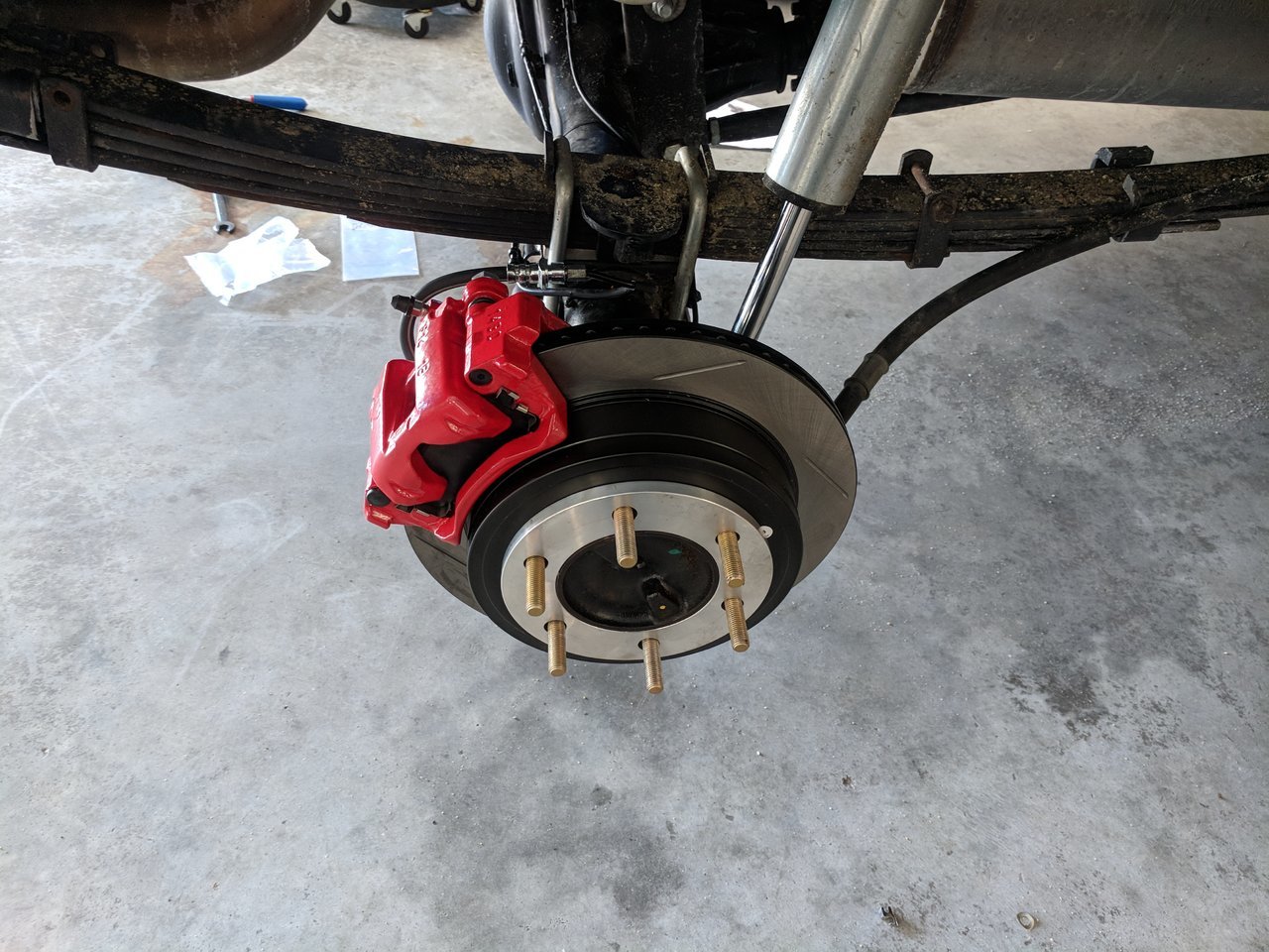

    Hey guys! Finally have some things to report. SO I was breaking in my new rear brake setup the other day and I can't give any affirmative information on them because I don't have data yet to support it but the brakes do 'feel' a bit stronger, and especially the pedal feel is significantly more linear. This is a great plus for me, and was a lot of what I was hoping to get out of this. I believe there was a small fluid leak in my brakes the first few days because last night I went around and checked all the bolts after a few days of driving around and there was a tiny bit of fluid seeping out of one of the new lines and the bolt took a quarter turn if not a little more till it was nice and snugged up. Should be good now and the brake pedal felt stiffer after I tightened that bolt so I think the next time I drive it the brakes might even be a little better.
    INSTALL: So the install process is a lot to handle. First you need to completely disassemble the rear brakes. This involves lifting the truck, taking the wheel off, hammering the drum off, and then pulling out all the drum brake crud in there along with the springs and all that mess.
    Next, you either need a hydraulic press and new bearings for the rear axle shafts to press the old backing plate off, or you have to do what I did and use a buzzsaw and a cutting wheel to saw the damn thing off. It was a huge PITA but I got it off and didnt damage the axle half-shafts or bearings in the process. Just take your time with it either way.
    Next, wipe the half shafts clean and lube them with some gear oil or something to slide them back in.
    Now comes the fun part, installing the miniaturized drums in the rear for the parking brake. Its basically like playing operation with big heavy springs, but its easiest to install the rear facing drum and the shoe lever thing and the spring that holds it onto (and both the clips and the pin that surround the spring) the backing plate before you mount the backing plate, and then install in this order:
    -parking brake cable to rear shoe
    -shoe spacer and shoe spacer spring get mounted in the middle
    -forward facing shoe and spring that holds it on along with the clips and pins again
    -two return springs for both shoes up top
    -single tensioner spring on the bottom
    -add star wheel adjuster in between the bottom of the two shoes
    -adjust tension either by removing the backing plate to adjust, or if you know which was is righty tighty and which was is lefty loosy then they leave you a tiny window to shove a screwdriver into the star adjuster wheel (I couldn't figure it out because one of my star adjusters was seized in place so I had to remove the backing plate to get it to move but then it did no problem, removing the small backing plate section definitely makes it easier)
    Now that that's done, you can install the new disc over top of all that stuff and put in the new caliper. Once everything is snugged up and in place, you can make an estimation of how much bend you need to put on the hardline to get it to mate up to the new brake lines and make the bends in it. Once everything is snugged up and you have checked the mounting plates with a torque wrench (60 ftlbs) and the caliper to the mounting plate as well (30ft-lbs), snugged the lines up hand tight with a 10mm while using an 18 to hold the other line, then you're done with the install! Bleed your brakes and go feel successful driving around in your truck!IMG_20180106_091601.jpg IMG_20180107_125742.jpg IMG_20180107_170023.jpg
