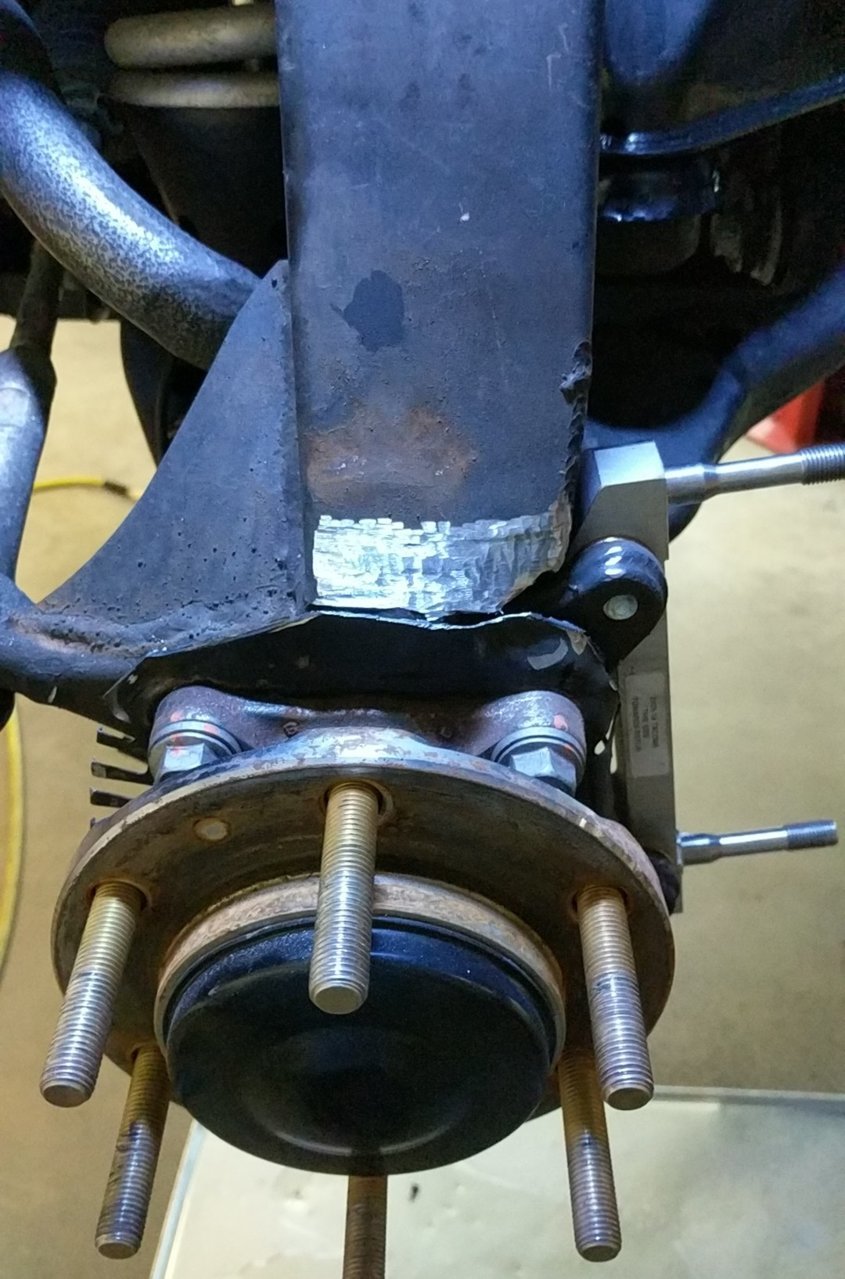

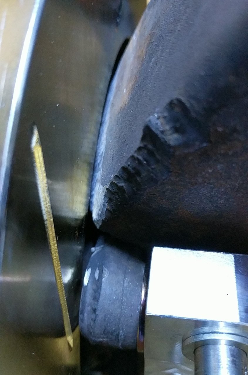

    @stevotivo12 any better shots of the total chaos spindle gusset trimming? I have them in my second gen. Shame I’ll be grinding some of that fancy powder coat I paid for. But hey big ass brakes!

    Not sure that every application has to be trimmed considering there is significant room for that gusset to be welded in different spots by a fab shop, but yes here are some pics: IMG_20180206_220932_01.jpg IMG_20180206_220926_03.jpg

    Helpful thanks. I may machine the rotors

    Sorry, gotta ask.. instead of cutting the factory dust shield off, why not quick remove the wheel bearing so that you could remove the dust shield all together?

    I tried to leave it as large as I could so it would still do its job and keep rocks out of my rotor hats, it was just a theory at the time and the execution may have been a bit off haha
