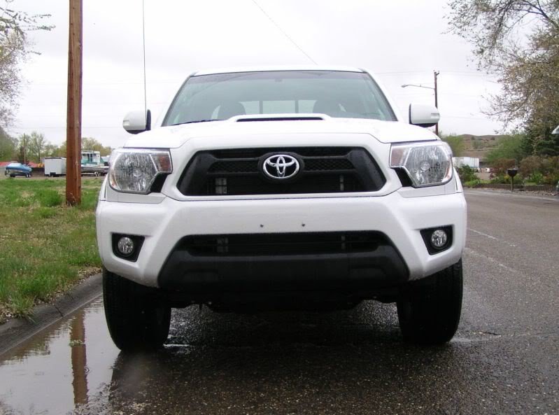

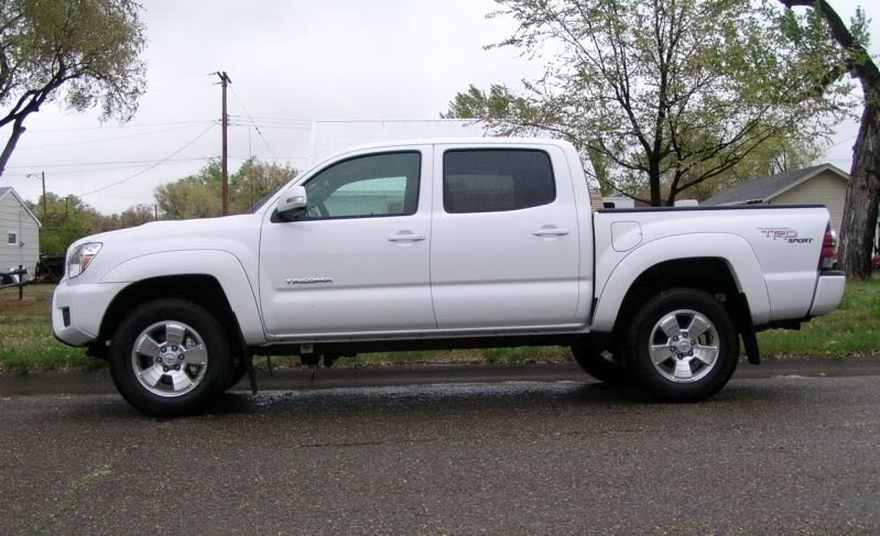

    nothing too fancy, but then again I've only had it for two weeks :D
    day I brought it home, 2012 Double Cab Sport 6 speed

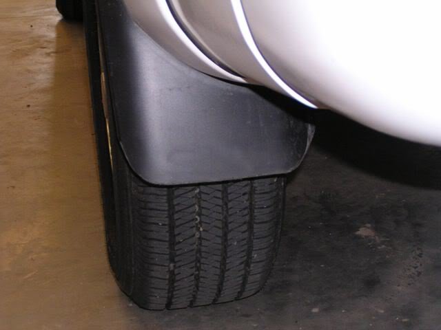

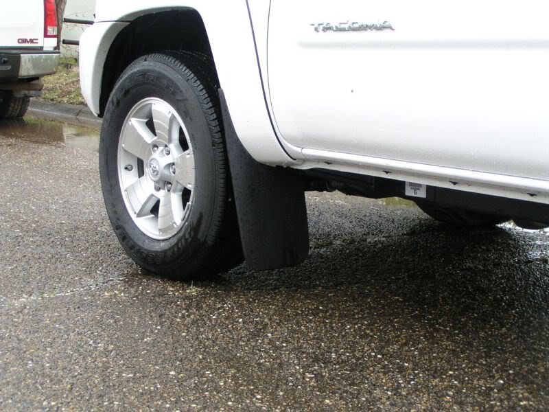

    didn't like the front mud flaps (looked like they were just begging to get torn off :)), so they were the first to go

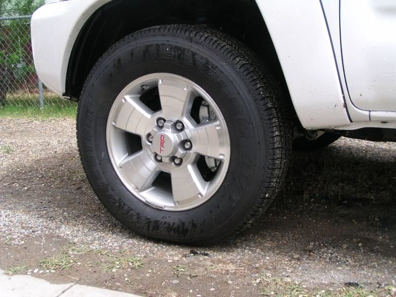

    ^ also pic'd are some silver FJ TRD center caps :D

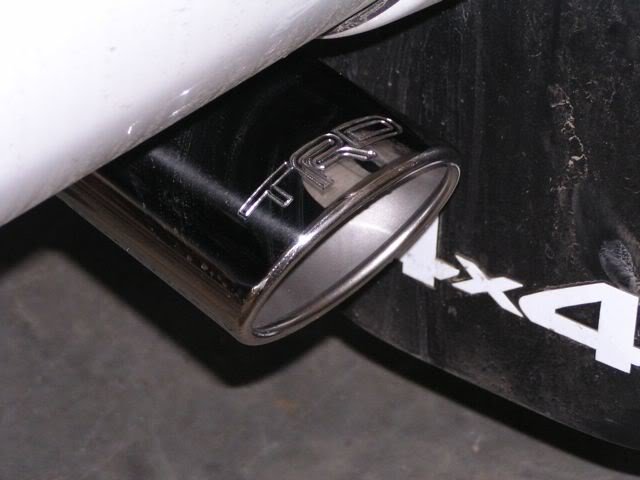

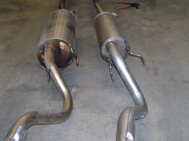

    installed a TRD exhaust this weekend
    comapro vs oe, smaller diameter muffler and larger diameter pipe (2.5" vs 2.25")
    shiny tip :D

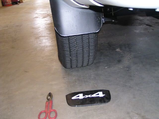

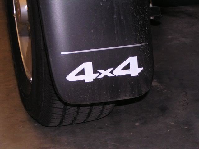

    wasn't happy w/ the rear mudflaps, but wanted to leave some on there- so just trimmed the oe ones, marked a line w/ a straight edge and cut w/ tin snips, used the lower portion to trace the curves and cut those- smoothed it up w/ a sanding drum
    finished

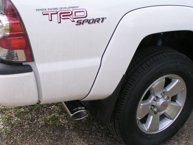

    rear quarter shot w/ shortened mudflap, TRD exhaust and TRD center caps :D

    nice!!! i like the fj caps for the wheels...those look super clean!!!

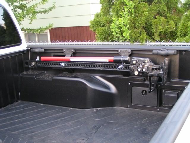

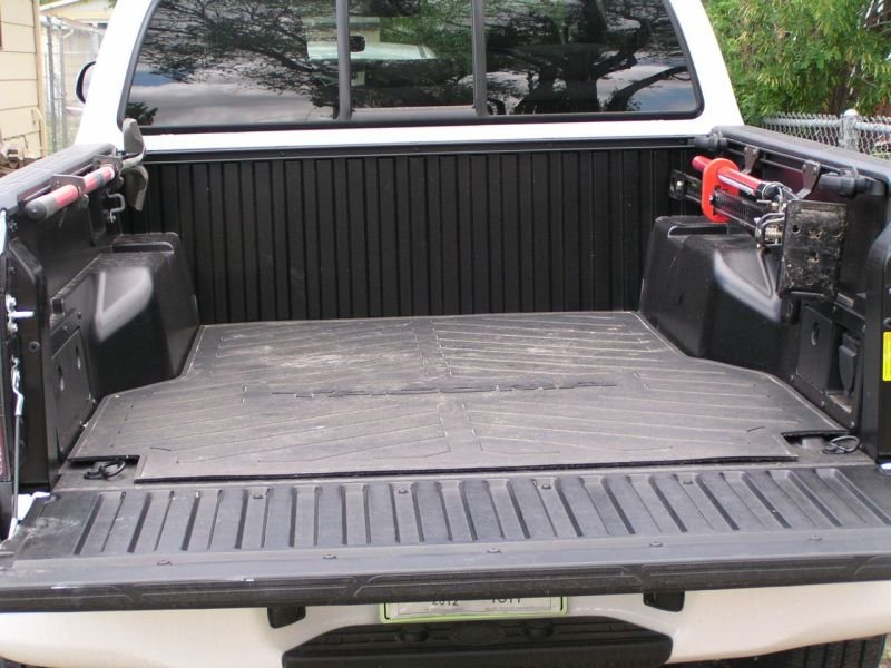

    I used ATO mounts that I had rhinolined to mount the hi-lift, very well designed and the jack is very secure
    have an idea for the shovel, see if it works out

    I think I've got the shovel mount figured out, I'm going to use a couple of quick fist clamps
    and a couple of t-nuts to slide into the rails to hold the clamps

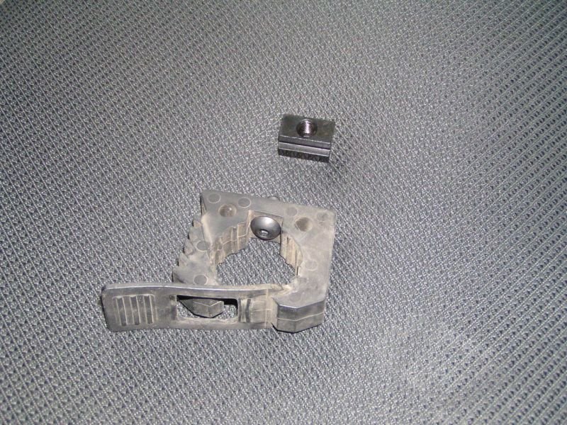

    this makes for an easy and clean way to mount a shovel/axe/similar item utilizing the bed mount system
    first you'll need a pair of quick fists
    http://www.endroad.com/index.php/quick-fist-mounts.html
    then a pair of t-slot nuts
    http://www.zorotools.com/g/00063230/k-G1777921/
    and finally a pair of 3/8" bolts (I used a round head hex socket)- I went 3/4" length, but I think 1" might be better
    you have to drill the hole out a little in the quick fist to get the 3/8" bolt in
    I assembled the t-slot nut on loosely, opened up the rail and slid both quickfists in, get them to the right location and simply tighten- done :)
