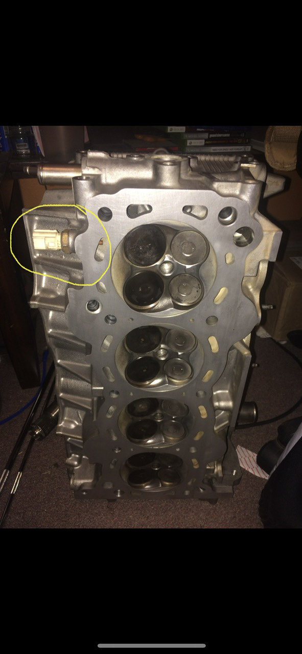

    This might help you get an idea of where it “sits”

    The piece didn’t go in the cylinder.
    Turning it over by hand isn’t going to do anything.
    You can not “look” in there.
    It’s either sitting right there in the water jacket of the head, or it fell in to the water jacket of the block.
    Maybe @BassAckwards has an idea. I think he has a lot of experience with these engines.

    Looking at the pic in post #2, even with the head off probably not room to get the piece out.
    It either comes out the hole it went in ..or you buy a new cyl head. You'd lose out on core value too
