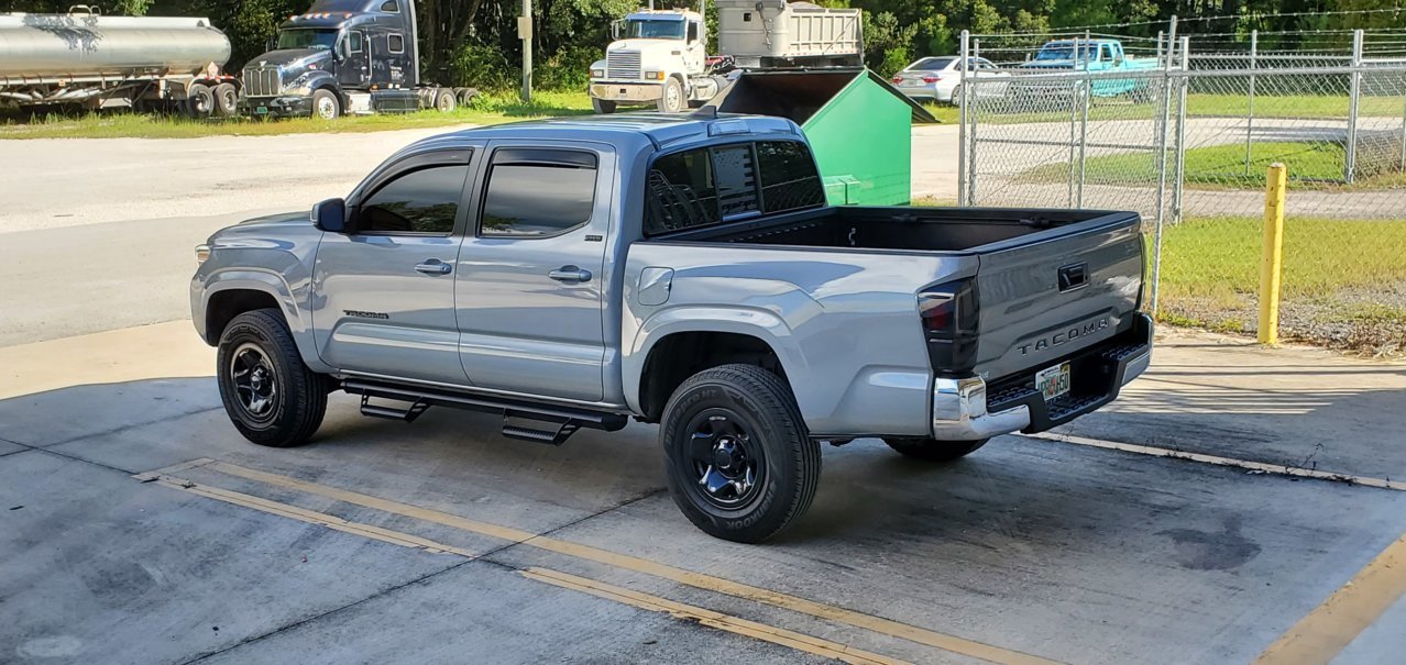

    This is not my truck, but you can see how much a 265/70/17 changes the look.
