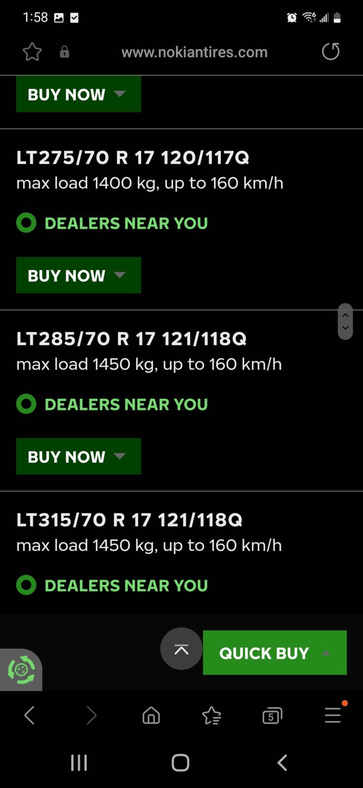

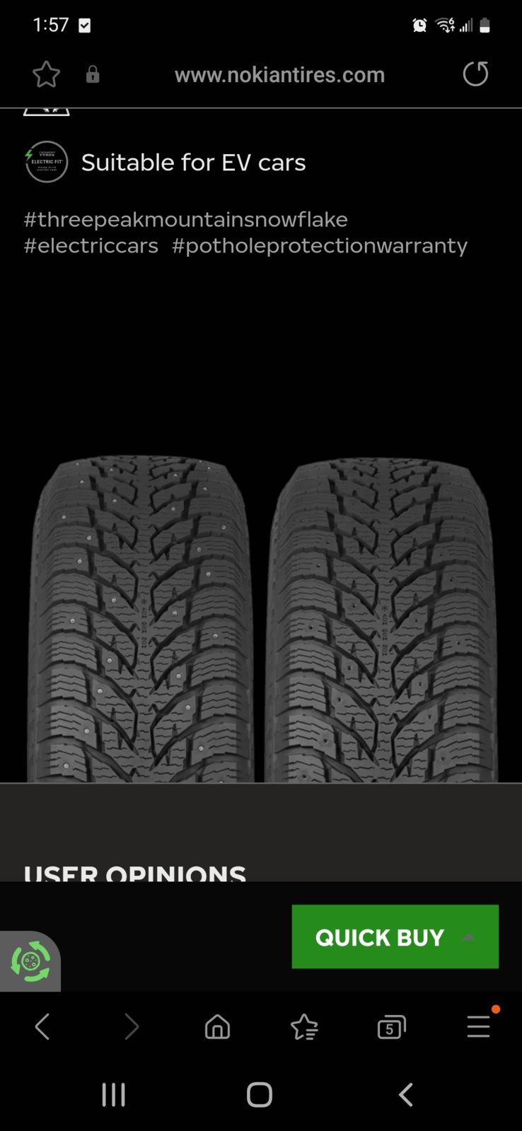

    In case some one else ends up looking for the same thing I did find a true winter studded tire from Nokian available in bolth 285/70r17 and 315/70r17 the hakapellita LT3
    I'm currently between these and a set of studded G017 in 285

    After looking at the LT3 and weighing the options I landed on studded G017's they seem to have a super soft compound compared to alot of winter rated AT tires and I wanted the security of that stupid strong yoko geoshield casing. The lt3 looked good but that sidewall did not inspire confidence for winter wheeling out here.
