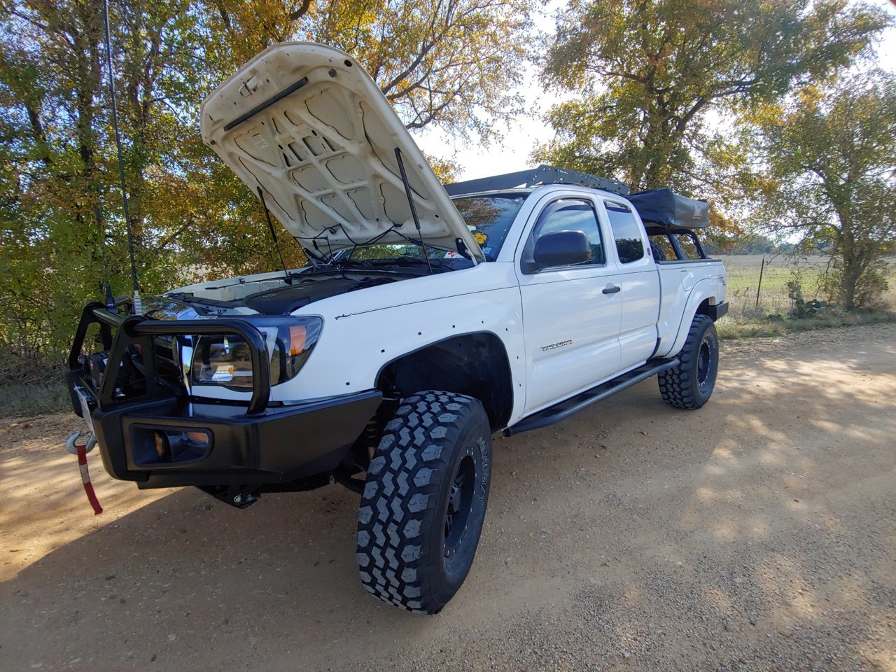

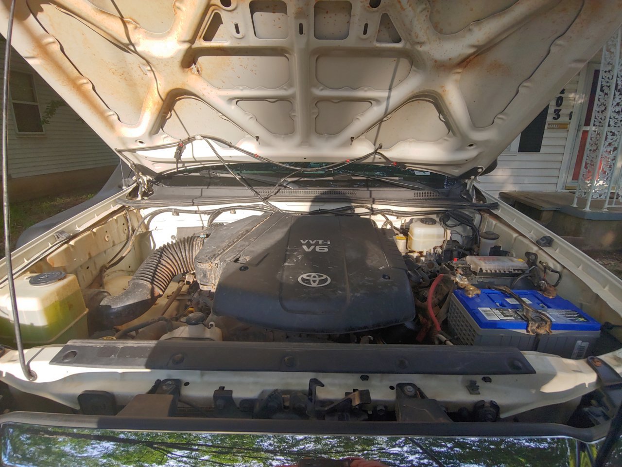

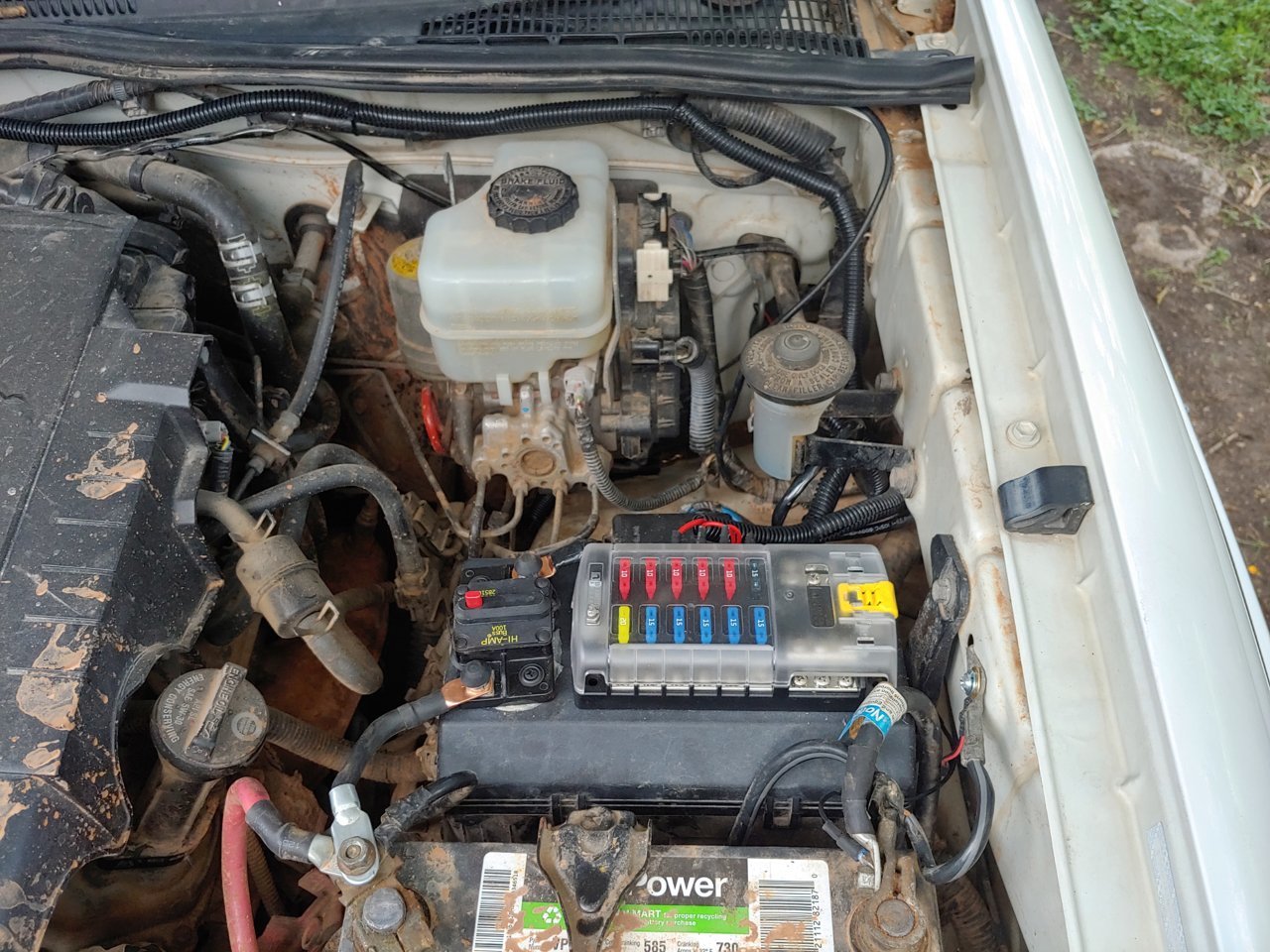

    This is my setup. It's still too messy for me. I need to pick up some more conduit and improve my take wrapping. I usually run straight power to the accessory and ground locally. Total of 7 accessories are wired externally from my factory harness. The wires on the hood have been reorganized since this pic...
    Engine bay
    Recent pic of my hood wires (still looks like crap)
    Close-up of my fuse panel

    Added bonus is if I'm modifying the accessories or their wiring, all I need to do is flip the circuit breaker to deactivate them.

    It's pretty handy. Only trick is making large gauge cable, even though that is easy lol
