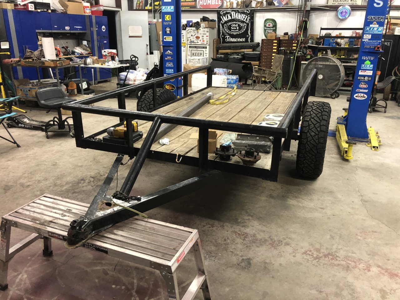

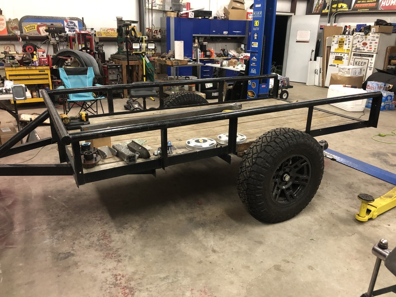

    We get the rack on it next. I was thinking about what you said about a step or lowering it. What about a hideaway slide out ramp on the back about 2' wide. Kinda like slide out trailer ramps.

    I hadn’t thought about it. Sounds like it’ll work, and maybe easier to make/find than a landscape style ramp.

    Liking that tongue brace.

    Yes, you really just need one mainly for your wife and such. Be very easy to build and cheap with some angle and expanded metal so it want be slippery.

    Is this ramp gonna be under the trailer in some sort of pocket?
    Hard no! That thing is gonna rattle around clanging banging down every trail.
    Can you find some way to bolt it to the side?

    You can quick pin them in place with a rubber compression bushing and they want rattle. Did this on my trailer and bumper swingouts also.

    Reinforce, extra length, Maxtracks for the Win. Dual purpose too. Might be the right fix.

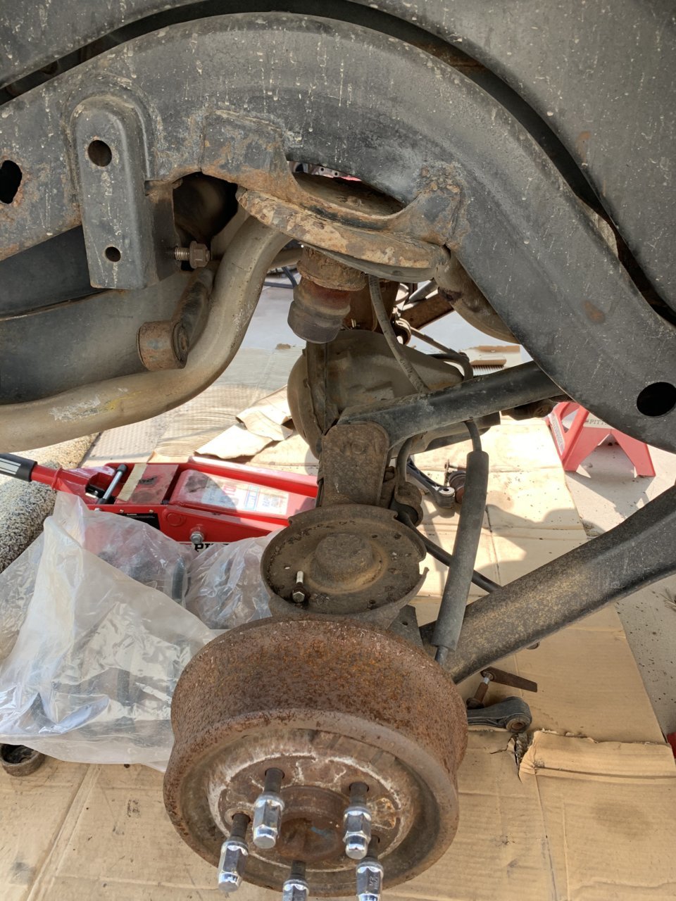

    My friends rusted as POS Jeep has been on blocks for almost 6 months now :rofl:

    What year is it? The jeep...

    Frame looks ok in pic. The other stuff can be replaced
