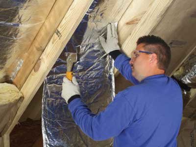

    That’s what I want but was thinking of a radiant barrier first

    I’m going to be screwing 2x4s onto tubular trusses but first thought bought taping butyl tape to trusses to break the thermal transfer first
